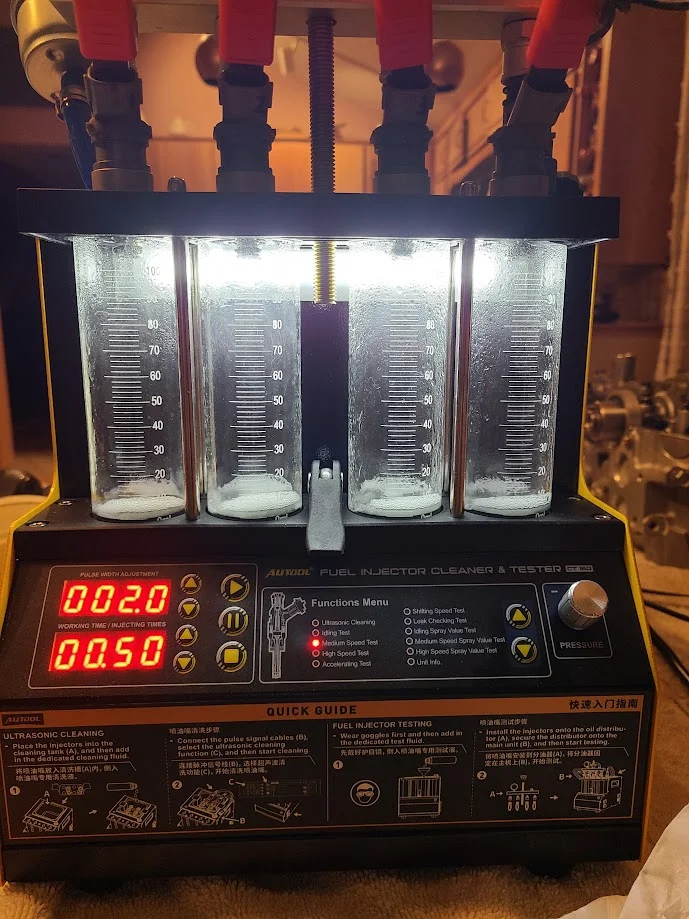

Recommendation on getting injectors properly cleaned vs installing new ones?
Rebuild them yourself, it's really that easy. I just did my daughter's V6 injectors. Here's a cleaning machine from Autool company, model CT160. I simply ordered a rebuild kit from Fleabay, which are O rings, grommets and little basket filters then went to town. Yeah, that's "rebuilding" injectors, not really rocket science.
