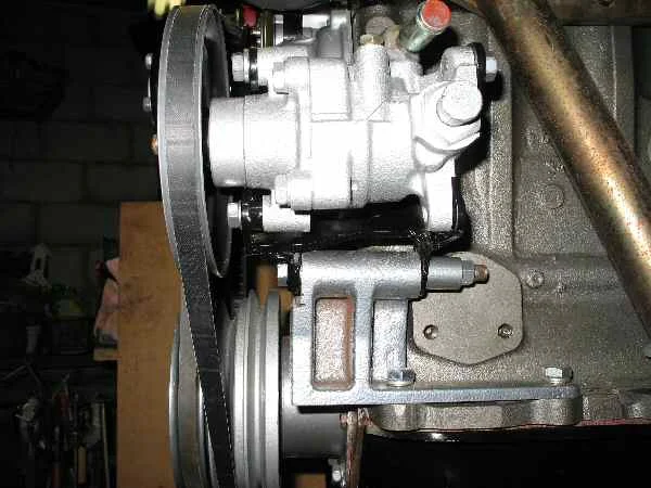

why is the mini pump hard to adapt if it comes with the box? i have the same set up to install and it cost me $0
Where and how are you going to hang it on the F/2F? The Tercel pump and Saginaw pumps can be mounted on the air pump bracket.
I'm hoping that the solution I came up with, (and have installed just not tested) will work. I used the mini-truck pump mounting bracket, welded an 'ear' on it to match the other one and mounted that to the F alternator bracket. I made an adjuster from parts of the idler pulley setup. It aligns pretty well but as stated I have yet to run this. I still need to tighten it all down before I start it.
The actual fab work took me a couple of hours, but the planning took a couple of evenings. ;)
