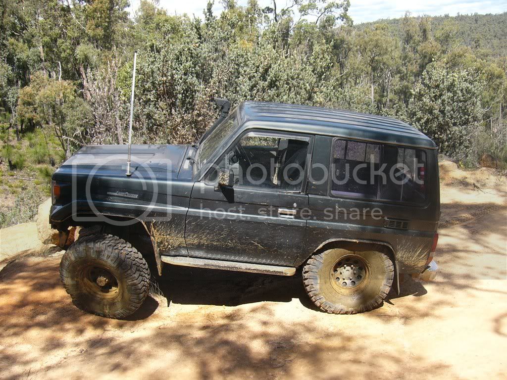

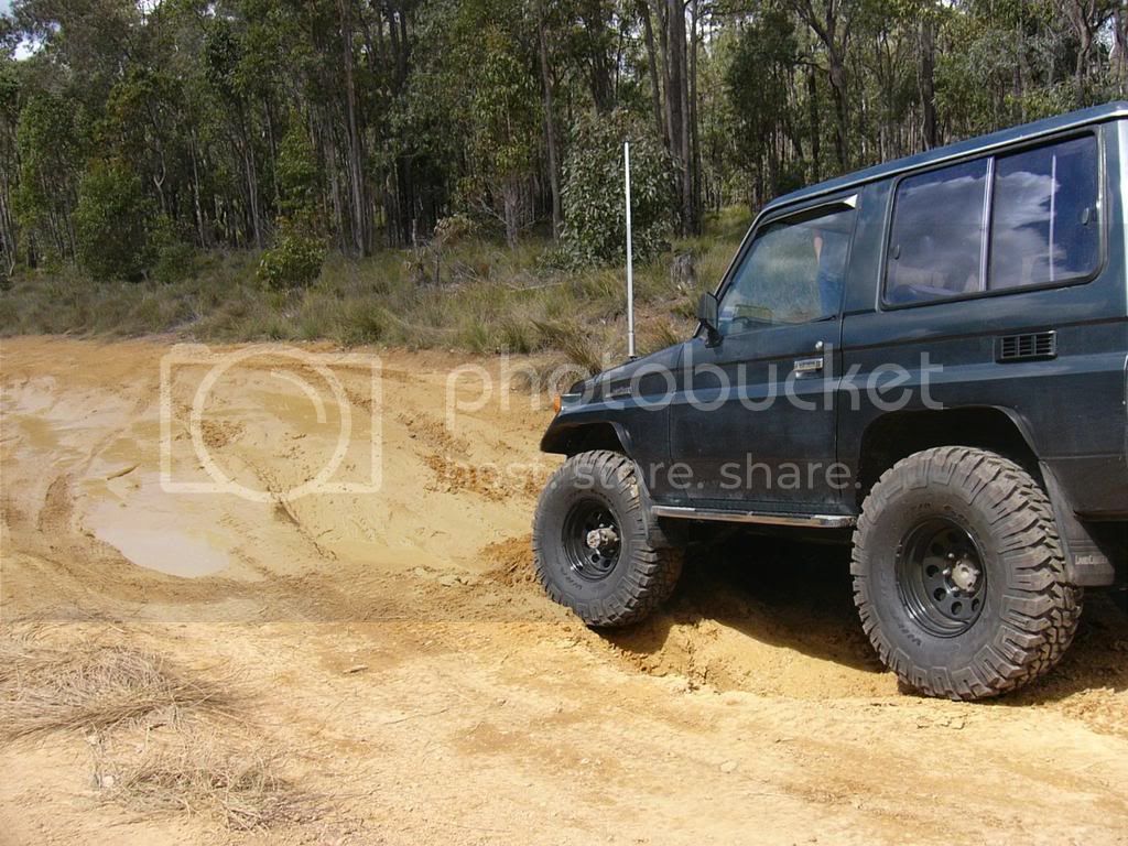

Chopped my guards, flexed it up at powerlines and they would of scrubbed if they werent chopped so pretty happy about that. The front seems fine except when fully flexed and turning but a 1inch body lift should fix that.
Also thinking of chopping my outer guards to the crease line shown here, and then getting some of the real flares to hide the cut. What do you think?
Went to powerlines today as i was bummed about not being able to go to wedge. The MTRs provide so much more grip and the larger tyres made everything so much easier. I did a CV in still deciding what replacement ones im going to get. Also thinking a locker in the rear would keep stress off the front diff as it would keep me moving rather than just spinning opposite wheels? Well thats what the situation was today. Oh and the rear end scrubs like a bitch... def need to sort that out ASAP
Anyway heres a few shots, ive got vids but am getting them tomorrow.
And here is how it sits next to my mates w a 2inch lift and 33's.

Chopping on the outer guard up front will be good to help when turning with that big rubber! Looks good mate.
What rear diff is in that thing? Can you even get a locker for it here in aus? Most aus cruisers apart from really old 40 series and the newest 100's have full floaters.
It looks like a semi floater is it like a bundy/hilux/prado diff?
Where is it rubbing down back? Mine used to rub pretty bad on the rear inner gaurd wall, was fine everywhere else though.

Yeah i think every bit is going to help, i will see after the body lift if it is going to rub at full lock full flex it might a bit so then i will cut the front and rears to that crease line.
I dont know what rear diff it is? My mate has the exact same model with the same diff and he is pretty sure you can get one as he is ordering one at the moment.
Pretty sure its not a bundera/lux diff as it is definatley full size 9 inch i think
Yeah it is rubbing really bad when you go over a bump quite fast... as in when you are slowly flexing the tyre slots right into the guard, but when both springs are compressed hard straight up then it rubs on the outer guard. A lift of the rear and a body lift should raise it about 2inchs so that should fix that... and like i said an extra 10mm cutting of the outer guard wont hurt.

That sucks its rubbing on the rear outer guards aswell! Some better springs and some chopping should help along with your body lift.
I'm still running stock toyota cv's, done 3 trips with the 35''s and no breaks yet, though did blow one with my 33''s, got airborne and the front landed between two rocks locking it solid. BANG! If your front diff is the same as aus delivered 70 series cruisers, you use 40 series longfields, either 27 or 30 splines, if you get the 30's you need longfield axels aswell.

Got a pic and a vid from powerlines. Sorry its sideways. Interesting comparison between 33s and 35's... the same truck with 33's tryed about 4 or 5 times up this hill and mine did this on first go.
Few more shots over the weekend
This is where i did the CV in. Front right tyre was hard up a hill, front left and rear right were just off the ground
And another flex shot for the hell of it
