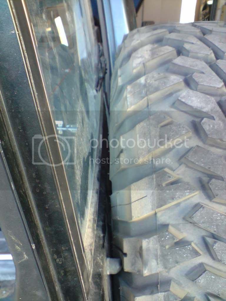

I would still need to take the chrome bumper off as it still hits the bottom. The left wagon door only just hits... i am getting a barely legal tread 35inch tyre for my spare so hopefully i dont need to drill the holes to the right. I might put a washer between the rim and the mount because it is pressed hard against the door.

Some pics of mine with a 35'' on the back, being a simex 35'' is actually close to 36''. You can see how it would hit the light when opened. I cant open the little door, tyre is about 10mm to big, and even with my own rear bar it still sits on it. Not sure what to do, mod the bracket on the door or make a swing away.
This is where it hits, taking the chrome bumper off and just leaving the rear bare will let it fit. At least untill i build a rear bar.
This is where the washers would come in handy, although the closer to the body the less likely it is going to snap off
Yeah hulsty your right your simex must be a little bigger than my mtrs, the tyre just clears the brake light.
It can open this much
