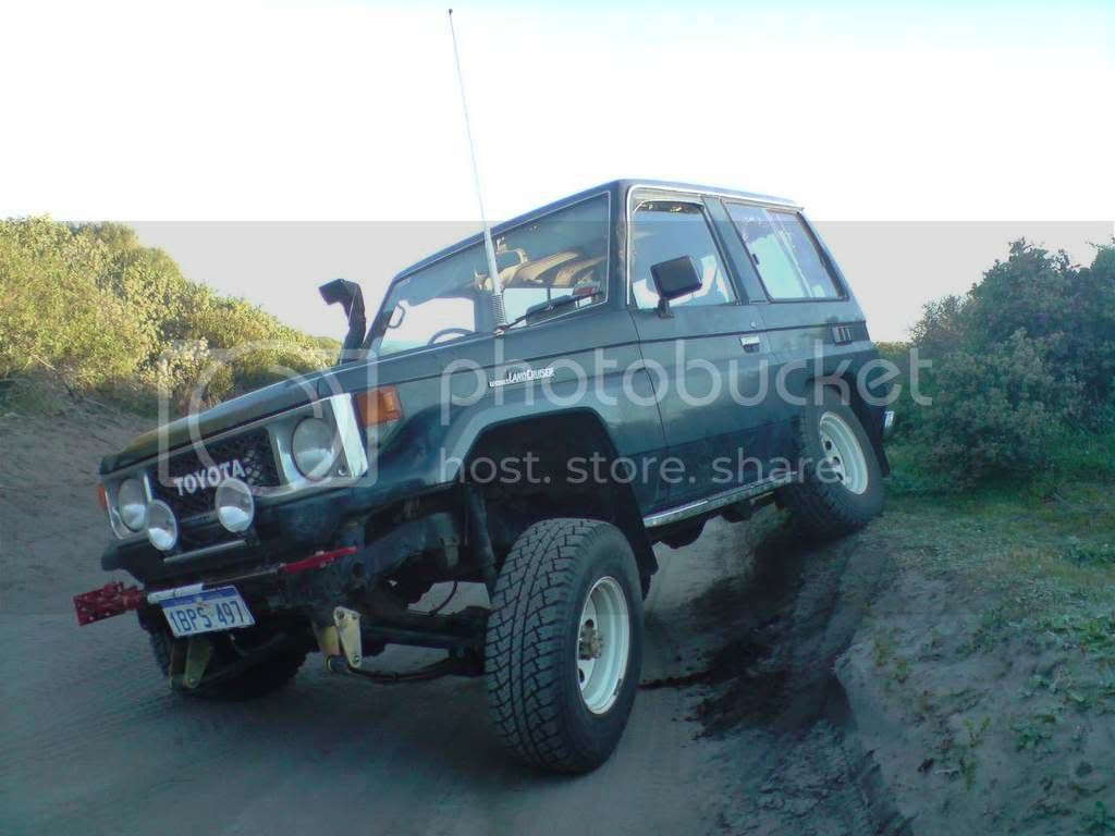

Since i have been doing alot of work to my cruiser i thought i should start a build up thread. Well here she is, a 1987 Toyota Landcruiser BJ71 jap import with the 13BT 3.4litre turbo diesel. The idea was to get a dedicated off road rig, that was in good running order so i could enjoy it from day 1, and then mod it along the way without worrying to much about it as its not my daily driver.
This is how i got it

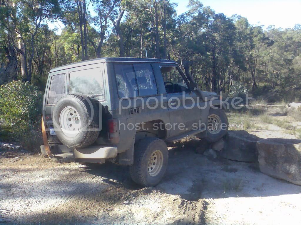

and to get it dirty

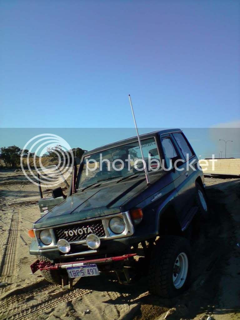

Then i gave her a bit of TLC and removed the winch as i broke a shear pin. Whacked my high lift on the front as i didn’t have a bumper

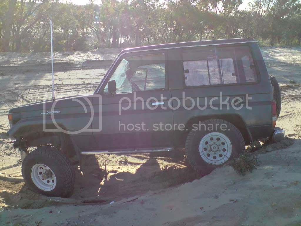

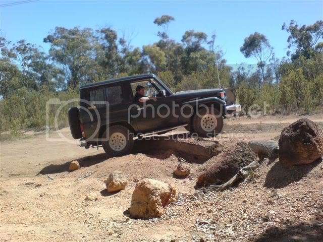

I then started to concentrate on what it was lacking off road.... Flexability, so off came the sway-bar and on came some extended shackles.

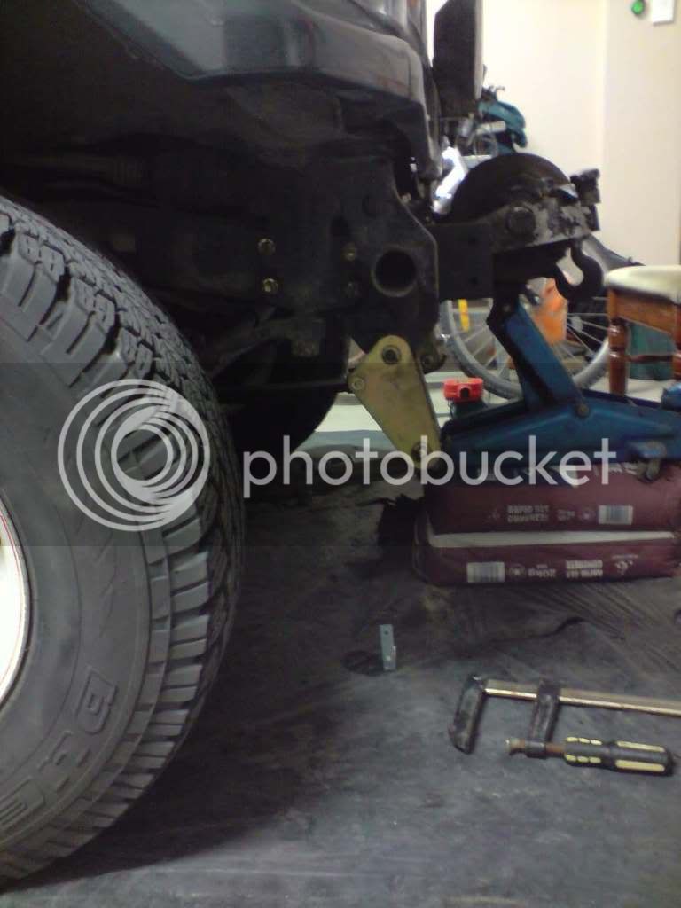

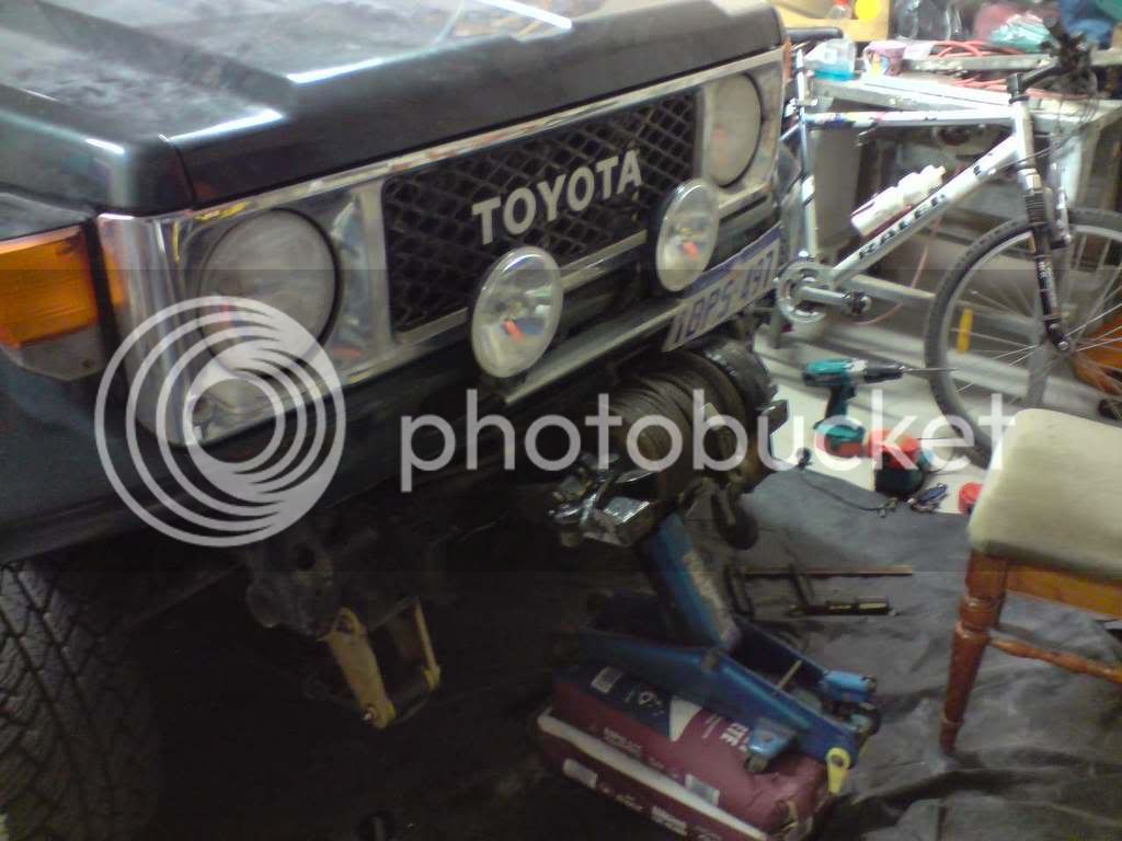

I then started making a custom bumper to try mount the PTO winch closer to the body. Its my first experience working with metal so its going quite slow at this stage. So far i have a bolt on extension of each chassis rail with a recovery point on each side. It should mount the winch about 10mm higher and 90mm closer to the body than the old mount.

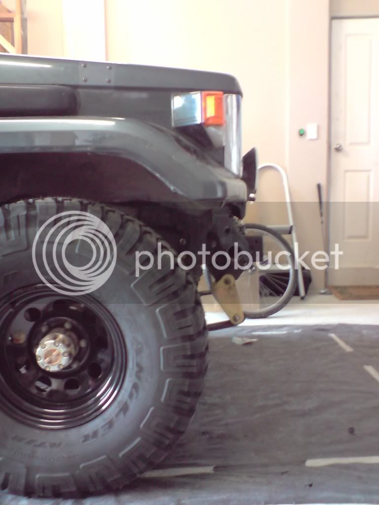

I planned on 35’s so i had to move my front diff forward an inch to fit them. This was just a simple case of redrilling the spring perch backwards an inch so the diff moves forward.

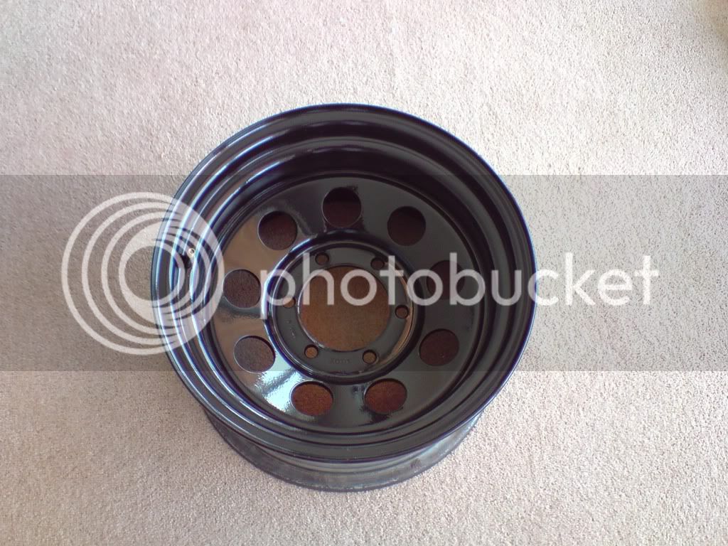

I sold my 31's and while the tyres were off i decided to paint my rims black.

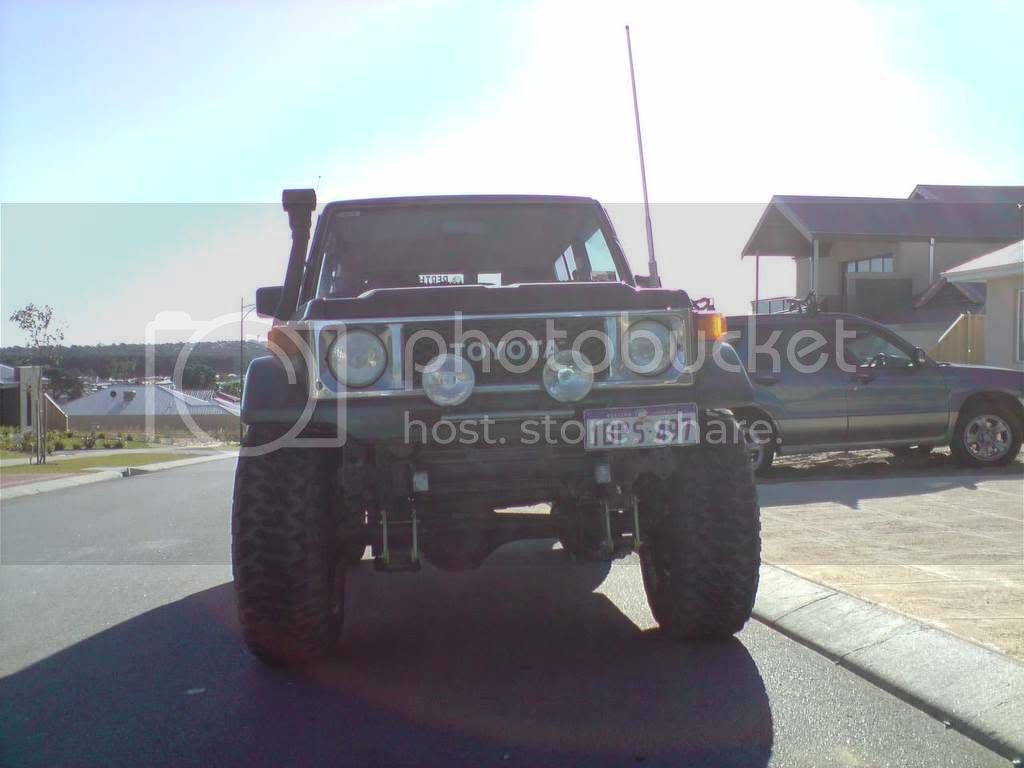

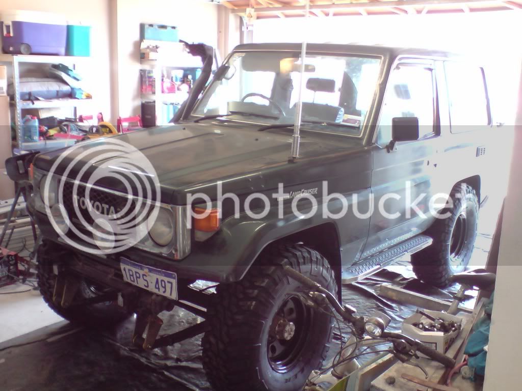

Then after weeks of waiting around for some second hand 33's or 35's i finally got new tyres. 35inch MTRs got them brand new for a steal because of the 4 for 3 deal at Goodyear... $1070 fitted and balanced for four 35's!

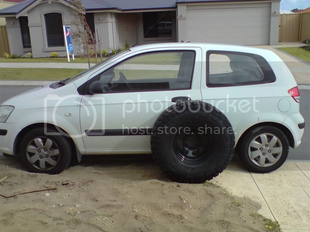

These are them next to our runaround

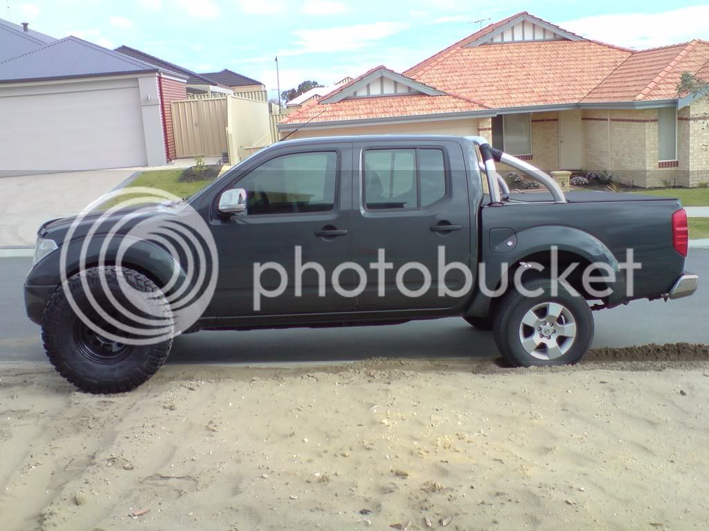

Next to my 3inch lifted navara

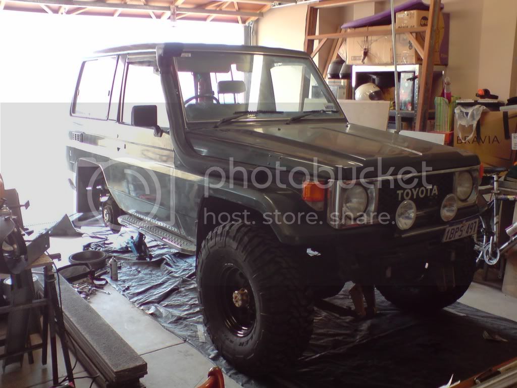

A few garage shots

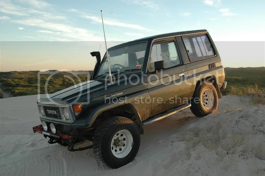

This is the approach angle... not bad!
I have decided to move my diff forward an extra 3inchs again which should make it more stable and improve the approach angle again. Im going to have to reverse the leafs 180degrees and then drill a new hole in the spring perch to stop the steering arms interfering with each other. And then i just need to extend the driveshaft 90mm. Well so i have been told, lets hope it works!

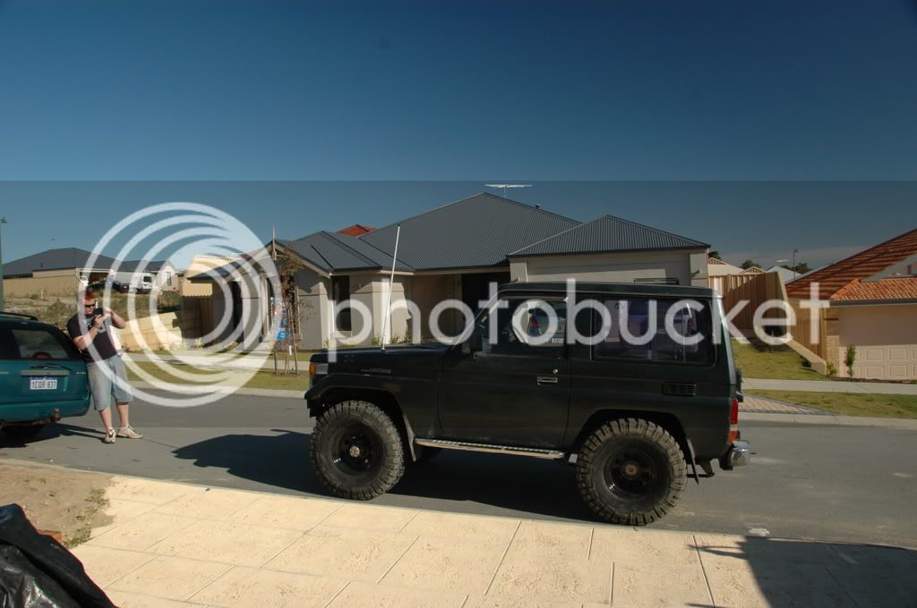

Got the last 35 on and took it for a spin. First impressions is that it is a much more drivable car now. Alot smoother for some reason, maybe the wider track and a bit more length, and the power delivery is more suited to the road than before. Doesnt seem to be much power loss but i guess that will show when it sees some thick mud or boggy sand. Low range seems fine but i guess it will show when i need it.
Here are some out of garage pics.
Now here is the real surprise
Barely any rubbing, none at full lock, none during flexing, the tyres seem to fit quite well in the standard guards. I heard it rub twice at a few funny angles and 3/4lock but i think this could be sorted with the guard chop and beefing up the rear a bit. No need for a bodylift i hope!
