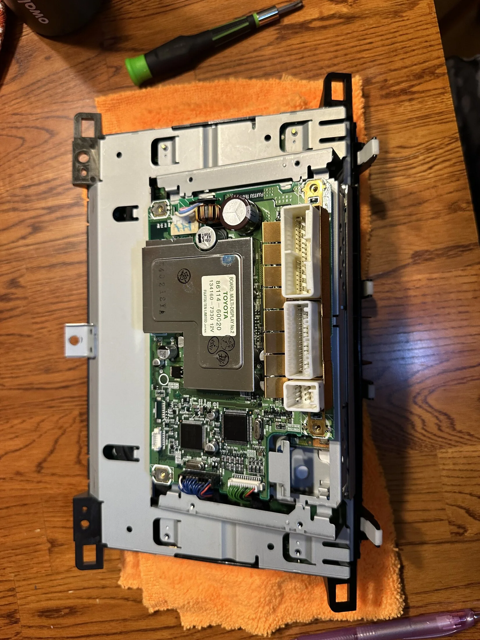

Thanks for the suggestion. I have triple checked fuses and all were good. Started the car and it did the same thing. Screen is 100% blacked out apart from the clock flashing as mentioned above. Tomorrow I will pull the unit to check if it’s getting power but my current assumption is this is the 60 pin issue I have read about on other threads. Mine seems to have a unique way of doing it but many of the same symptoms are appearing.

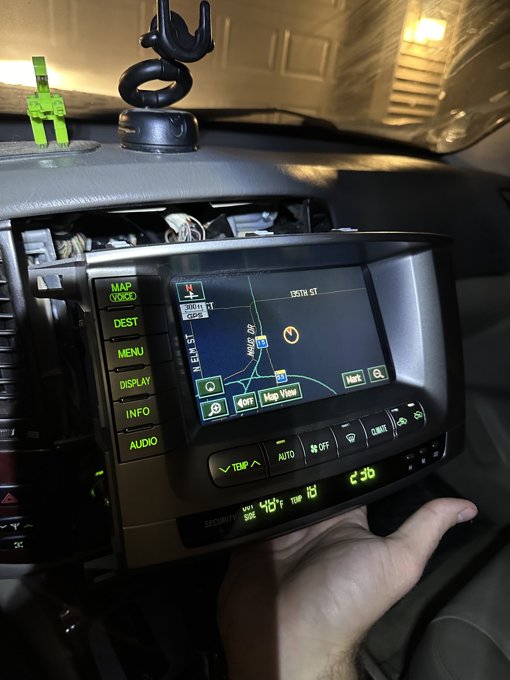

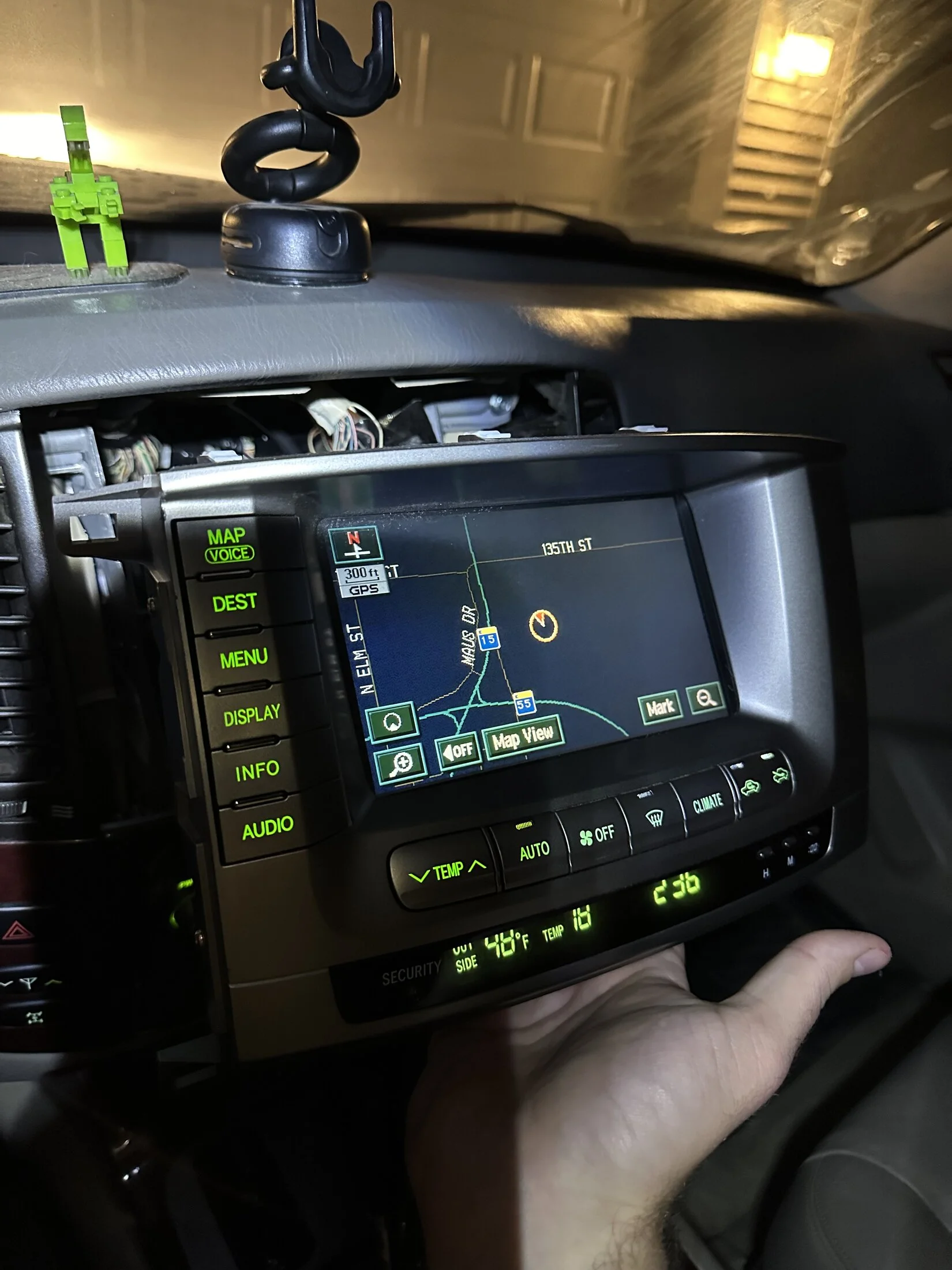

SOLVED. I am writing this from my LC because I am too damn excited. I went after the 60 pin and followed a tutorial I found here: DIY: 2004 Multi Function Display (MFD) PIN 60 Repair - https://forum.ih8mud.com/threads/diy-2004-multi-function-display-mfd-pin-60-repair.855980/
To anyone experiencing the same issue as me, this was my fix. I will warn you too, I soldered it the first time and didn’t do it right. I recommend using a VERY small amount of additional solder just to be sure. Anyways, my beauty is 100% again now I’m gonna go on a cruise and feel proud. Thanks to all that followed.
