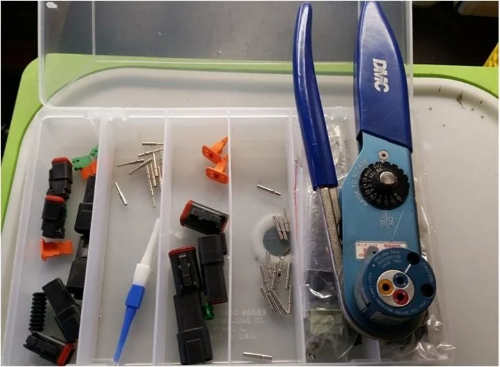

Metripac/weatherpack is junk. Deutsch all the way. They’re easier to work with, more robust/reliable, more compact, more resistant to dust and water. And they don’t break if you look at it wrong.
My barrel crimper is made by tool aid. It works as well as the adjustable Caterpillar crimpers but obviously the tool aid ones have different sizes for each range of pin. They’re way cheaper though.
Thats actually a decent deal. The cat deutsch kits are like 1000$ but that does include the adjustable crimpers.
yes, I can only assume they aren't genuine, but they work great for internal projects/shop/fun rigs
I went with the Deutsch DT connectors mostly because of the mil-spec style contact. I really don't like the stamped contacts. I also like the rear grommet sealing of the wires. I bought a minimum order to cover what I was working on plus some extras. I can always add to it as time goes on. The kits are nice but I think you'll end up with a lot of pieces you may never use.
