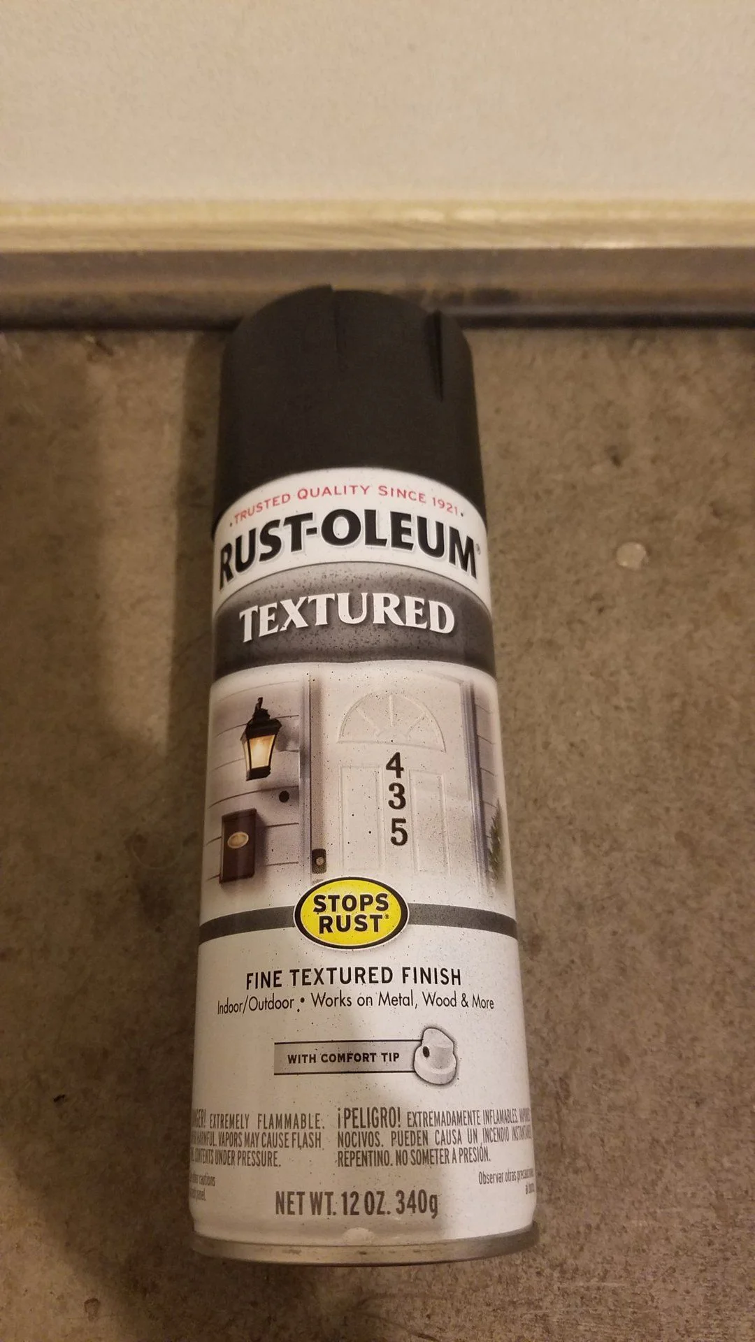

I have bior step sliders powder coated black and the Rust-Oleum black textured paint for touch up has worked very well . They start to rust in a few weeks if not touched up . I'm thinking that same textured paint would work well as a final coat, it's not slippery . Still might need grip tape though.
