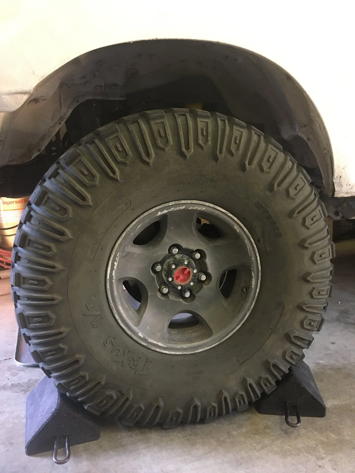

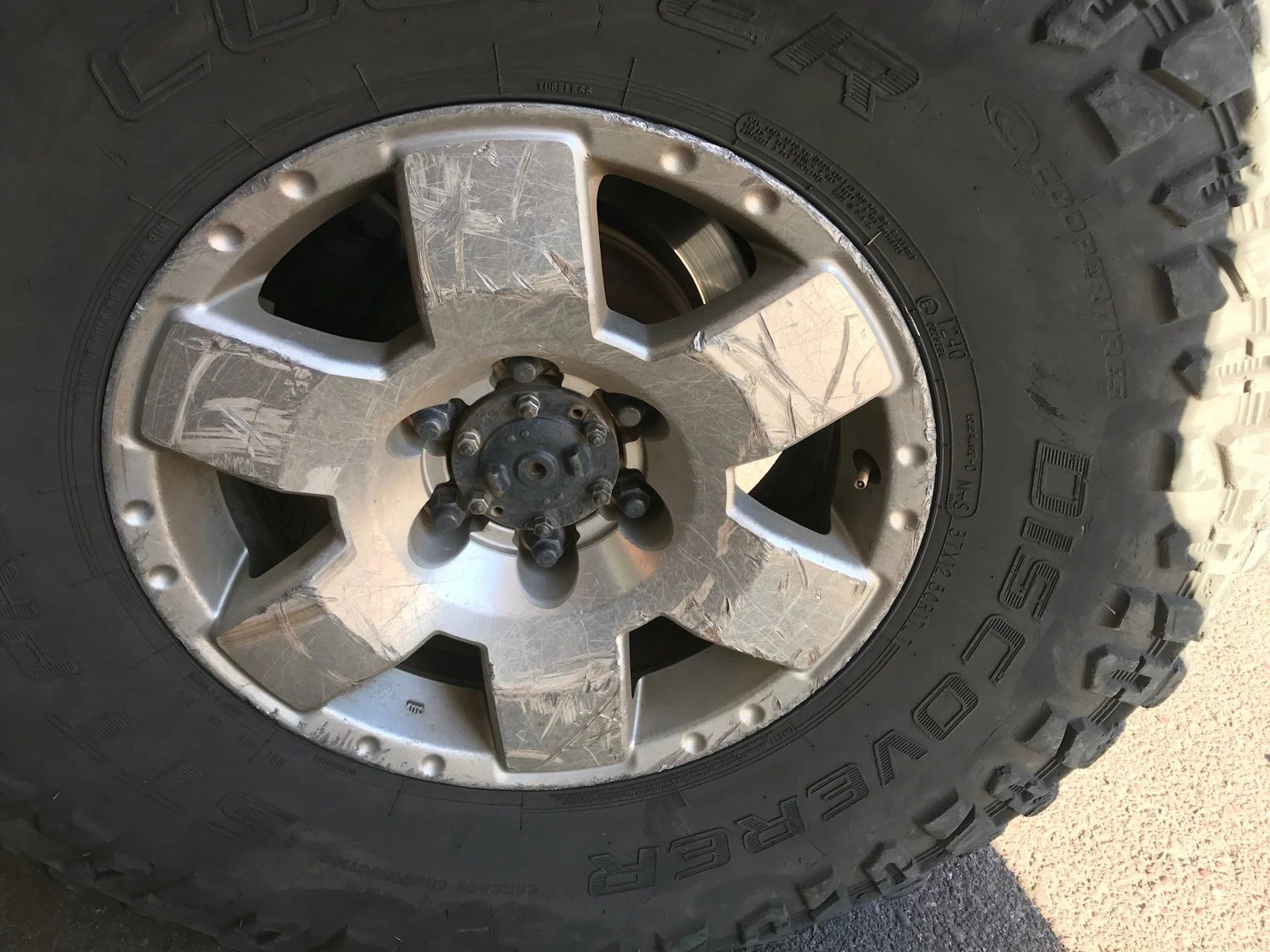

Duplicolor Matte clear over graphite wheel paint after about a year and a half of “light use”.

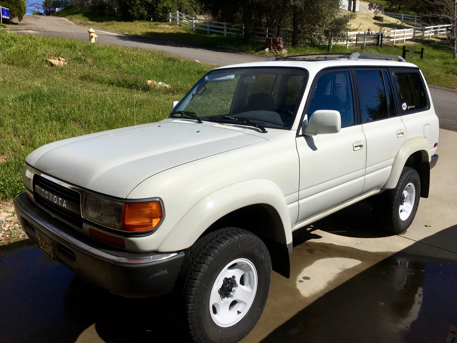

My steelies are glossy- I didn't know I had a choice when they were installed with my KA 02s. Nevertheless, I prefer matte.

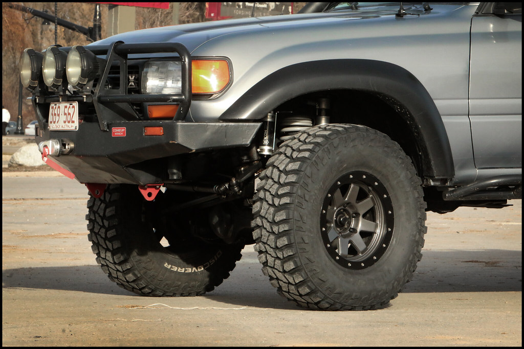

The best clearcoat result I've had from a spray can is a two-part clear from the Auto Paint supply store. When I resprayed the hood on my 80 I had them mix a spray can of the Moonglow 1A6 for a perfect color match and then used a two part clear that they recommended. It has a "button" on the bottom of the can that when pressed punctures a catalyst cell inside that gets mixed when you shake the can. The nozzle sprayed a very nice pattern and the quality and finish of the clear was surprisingly good. Most people have no idea I've repainted my hood, let alone done it with rattle can.
If you want a great clear finish but are still on a rattle can budget, it's worth the few extra bucks to hit your auto body store and ask them about a two-part aerosol clear.
Untitled by Adam Tolman, on Flickr

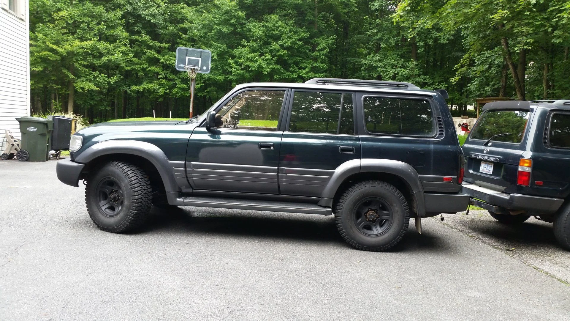

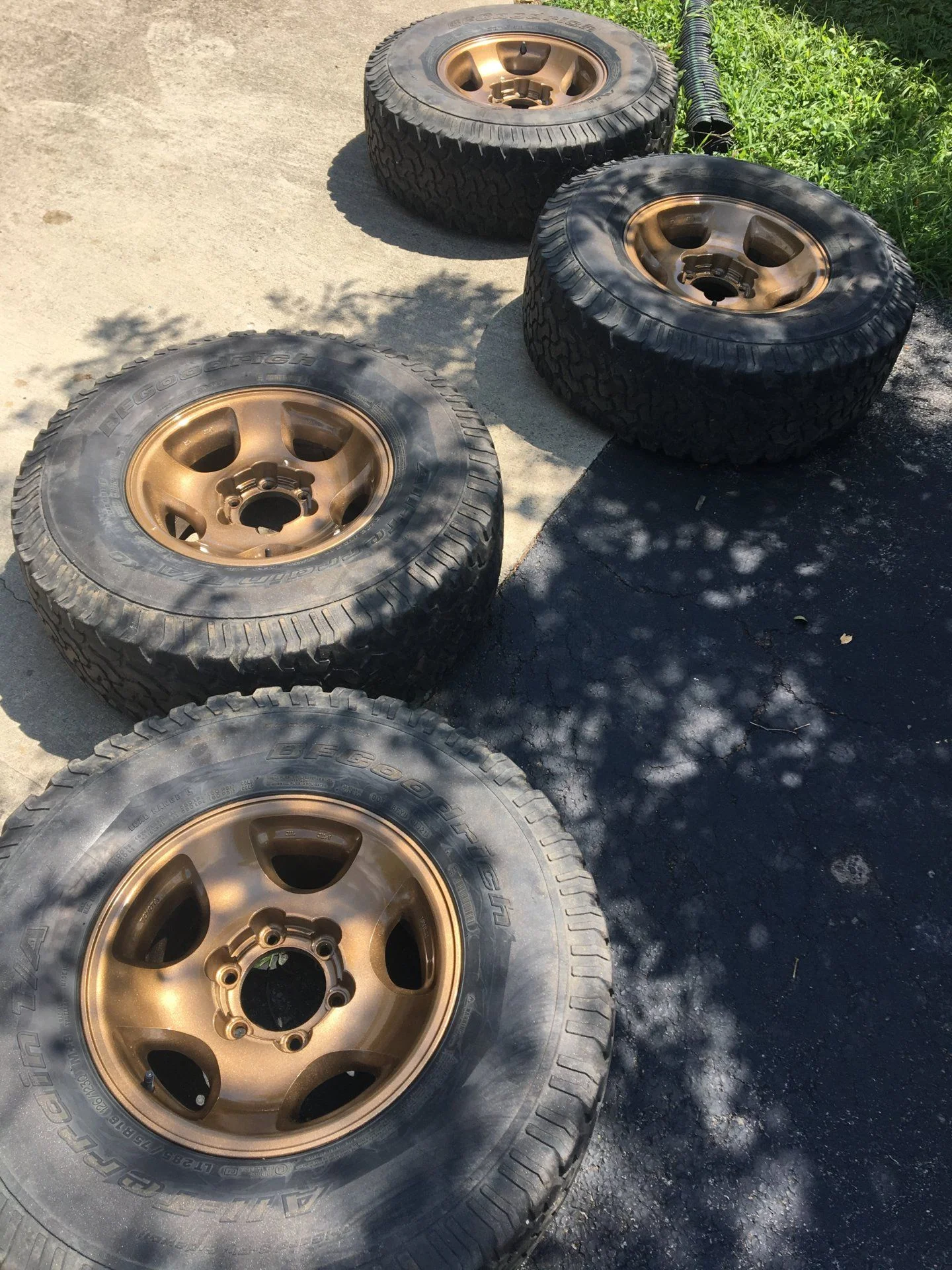

I used Rustoelum Graphite and I would not recommend the clear coat. The can doesn't call for it and those that have added it have reported problems and regret using the clear coat.
Mine still look great after two years in the Rust Belt.
As you can see in pot #3, there are no problems with clear coat, matte anyway. Prep and thin coats is key. Based on how I use my wheels, clear coating them probably was a waste of money though. :)

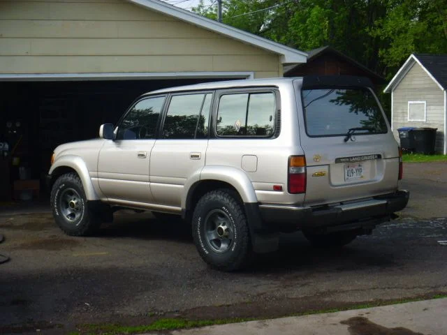

Rustoleum flat black. Plus side is that if the ever get nicked you just rattle and spray the spot.

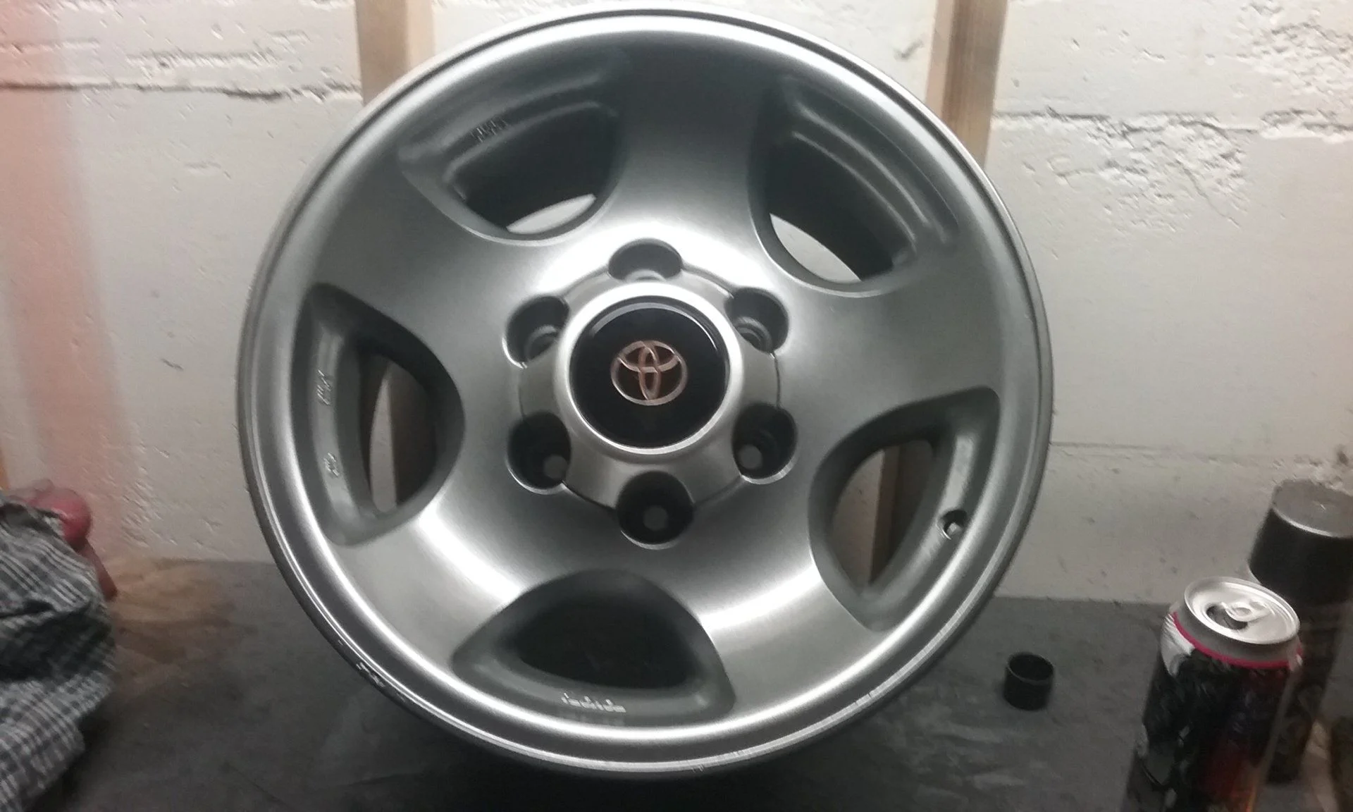

Anyone used duplicolor clear? I started with the spare. I used vht and duplicolor graphite paint. I couldn’t tell any difference in the color between the 2

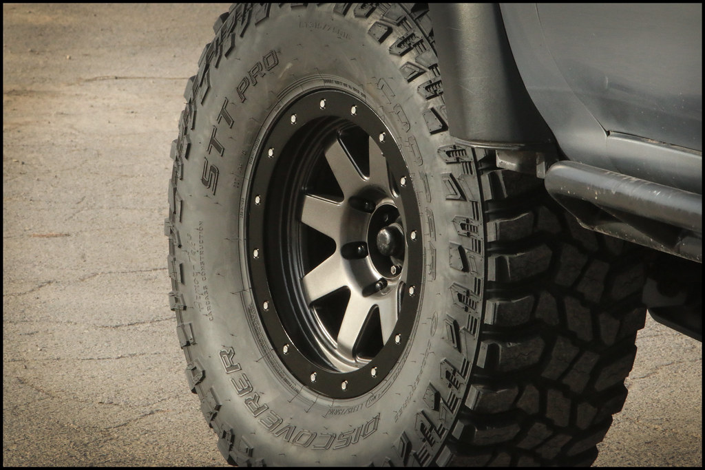

Before I settled on colour / finish I must have tried about 10 different permutations. Eventually went with matt black. Really happy with the look. Toying with the idea of having them power coated but I keep hearing stories about the heat compromising the strength of the wheel.
