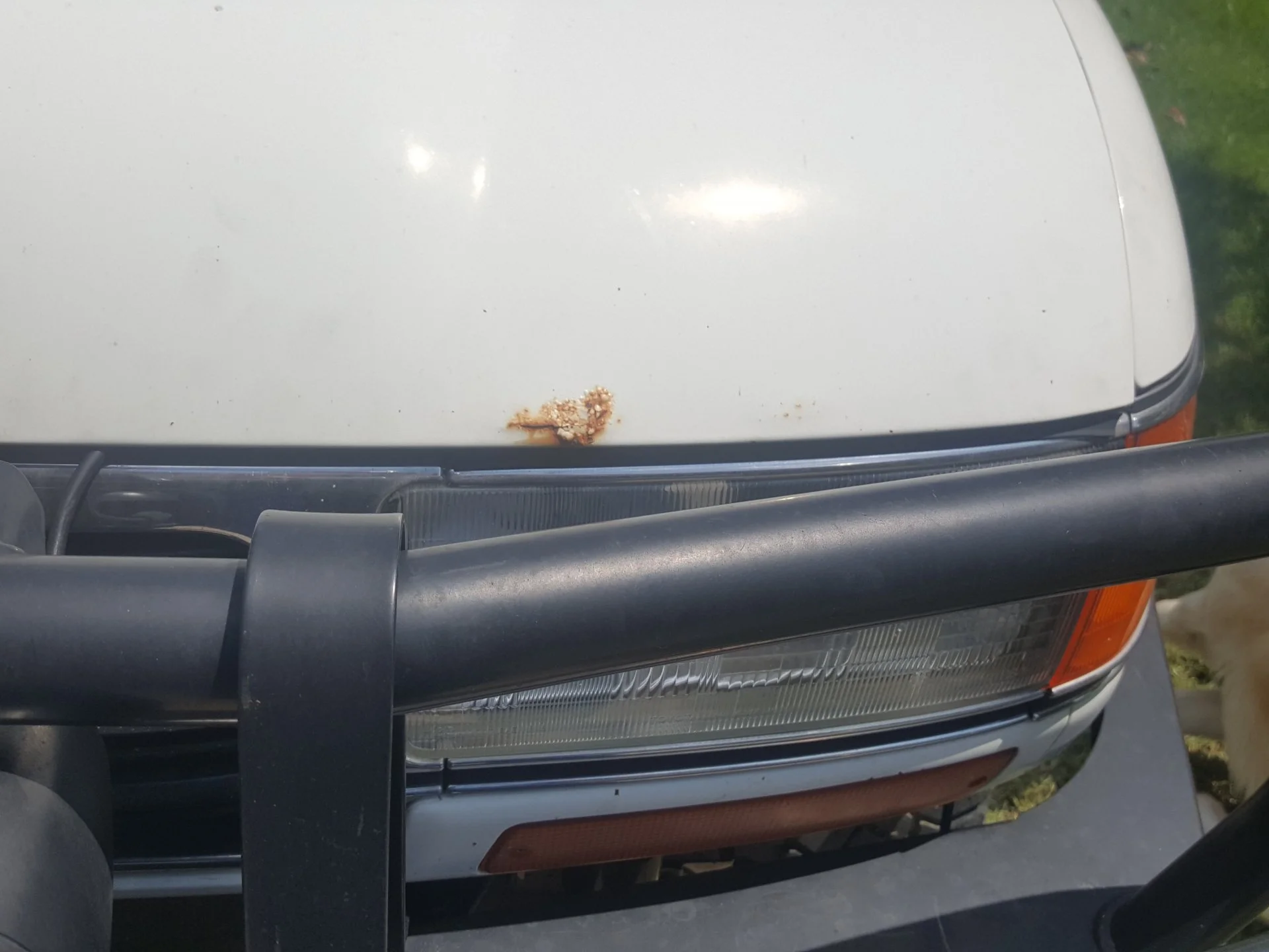

I'm about to address a couple rust patches on my hood and cowl, and will need to paint a couple areas. Does anyone know if the 045 single stage is an urethane or lacquer?
I'm looking into the PPG Omni acrylic urethane... im mostly worried the finish is not going to match and will be too glossy.
Anyone with body experience? I'd love to get your input and advice.

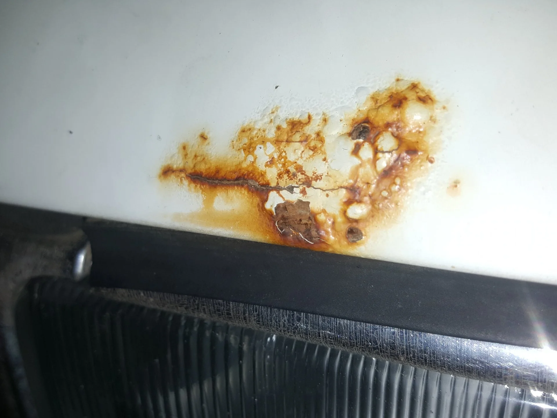

Here's the cold sore I'm trying to fix:
And the surface rust on the cowl
Any input on which brand of paint would blend best?

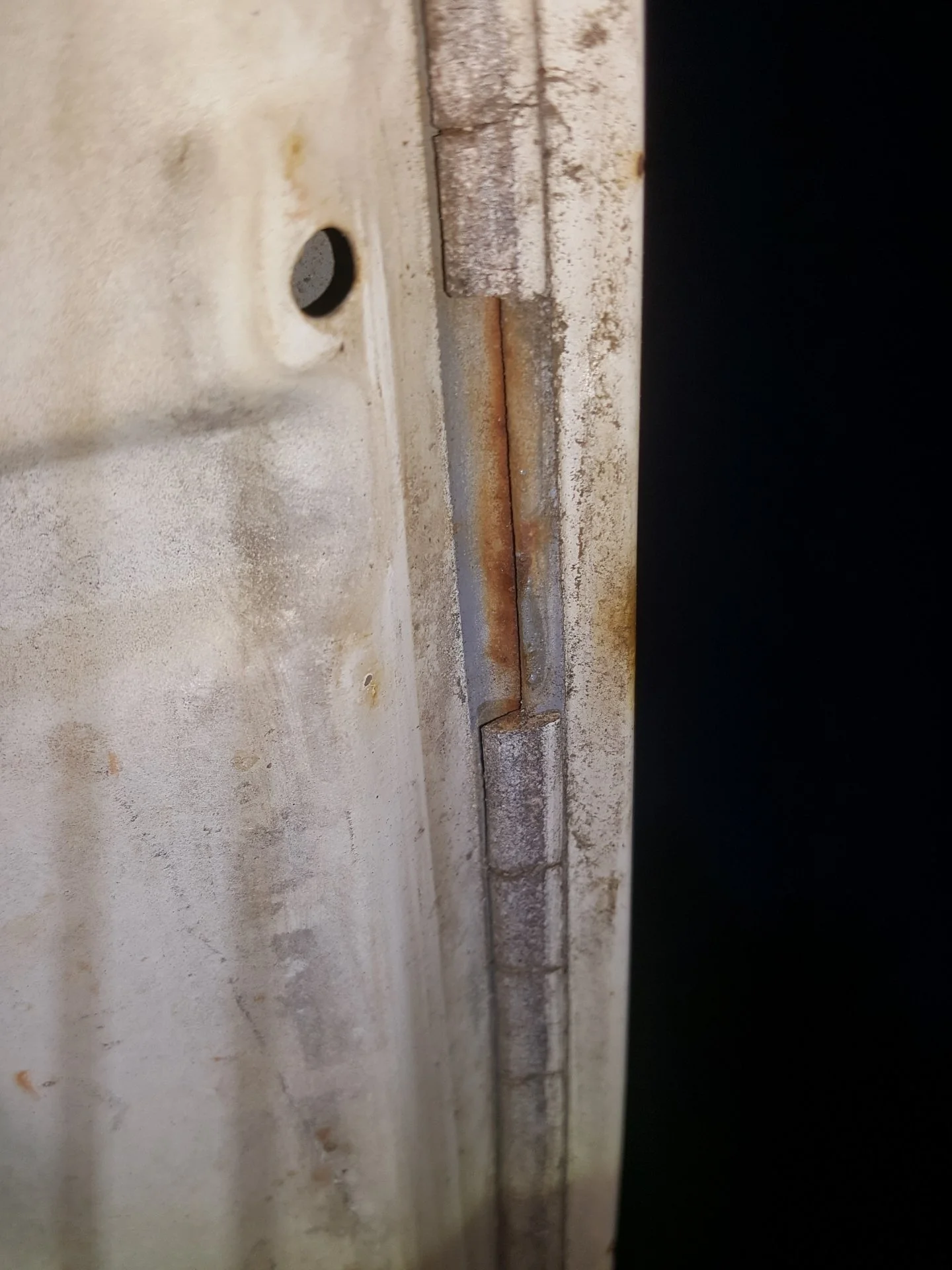

AsKnifght: have you looked at the underside of your hood ie: underneath where the rust is poking out of the sheet metal?
The hood is often one of the first places for rust to show up, it tends to start under the support/frame or where the factory seam sealer was applied underneath the "nose" of the hood ie: it rusts from the inside out.

i assumed it got a ding, but it could very easily be part of a seam. The seam bottom itself is rust free, but i can see surface rust up in there.
If this were my case... Would the repair be much different? I was gonna sand down to clean metal, apply rust converter, prime and paint.
Can you take a few more photos, hood open, from inside the engine bay looking out to get a photo of the backside/underside of where the hood rust is in the photo above.
I'm not a autobody/paint expert, but IME unless you completely remove or properly treat/kill any rust, it will come back. Main advantage of fixing it now would be to slow down future damage.
@Kernal ... I posted a couple pics in a reply post. (Or tried to anyway)... let me know if you cant see em.
I welcome anyone's opinion on how to fix this. Cheers!
I would remove the hood, take a 3M stripping disc on a 4.5" grinder, and take off all the paint in the rusted area and all of -- what I assume is -- old seam sealer on the underside. Then I would stand it up against a wall, nose down, and build a little pool out of plastic sheeting. Dump in Evaporust if you're fancy or Klean-Strip Prep & Etch (phosphoric acid) and leave it for a few days. I'm sure that seam is currently full of moderate rust that you have to convert.
Have you thought about just getting some touch up paint from the dealer to avoid hassle? The 93 Hilux I used to own came from the dealer with a can of touch up paint when it was bought new. No idea what they charge, but I can't imagine it'd be a fortune. For small touch-up jobs, it might be the easiest option.
