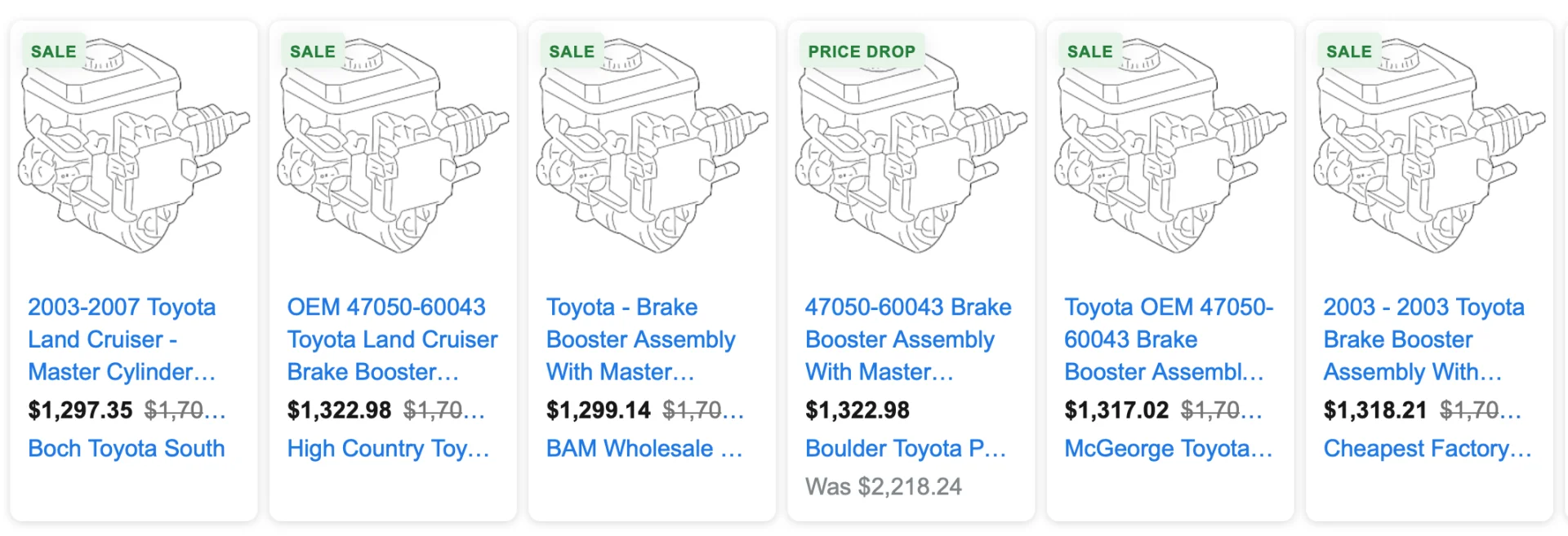

For whatever reason, the new OEM Brake Booster Assembly is highly discounted right now. Will it go discontinued? I don't know. @OGBeno
$1317 @ McGeorge
I'm a little confused on the pricing, because the list price seems low too for the whole assembly. A bunch of dealers have it listed at similar prices though. I'm not sure if I'm misremembering the price, or if there's a mistake in their system?
$1317 @ McGeorge
What a dealer sells the parts for has no correlation with whether a part will go discontinued. No correlation at all.
