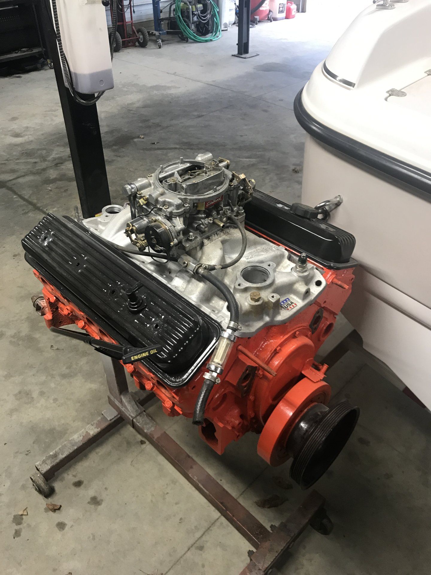

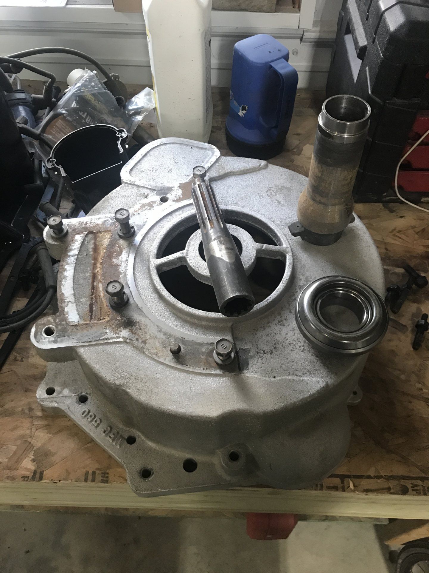

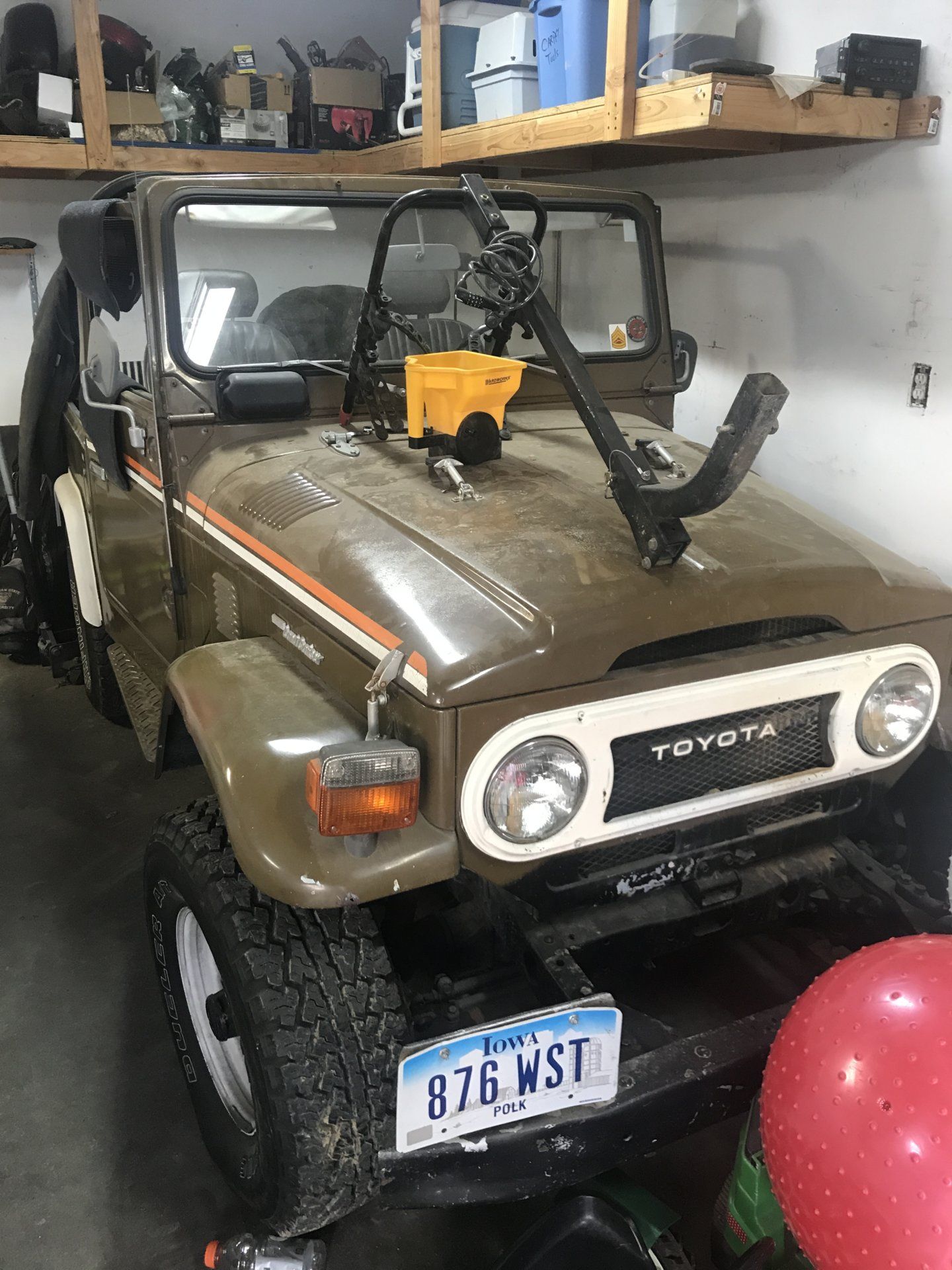

I have a 77 Fj40 with the factory 2f and 4 speed transmission. I recently found a marks conversion kit used for the right price (bell housing, shaft, jump shaft and a what appears to be a throw out bearing). It didn’t come with the flywheel or clutch. I’m wondering if anyone has info on what I can get away with running? Can I just use a basic 168 tooth flywheel and standard 11” clutch -pressure plate assembly for the 93 Chevy 1500 I robbed the sbc 350 engine out of? Adv adapts shows their stuff but discription is a little limited likely because they don’t want to do the leg work just to not sell their parts. Any advice?

1. Don't use a regular Chevy clutch, they require more travel to fully disengage than your Landcruiser hydraulics provides. Use my custom built Chevota clutch, message me if you need more info on this.

I have personal experience here with what Jim is saying above. My previous V8 FJ40 had a VERY poor homemade clutch set up from the previous owner. I drove it until it failed, then spent an embarrassing amount of time trying to source the parts only to find out they were incorrect to begin with. I reached out to Jim, from previous experience I had with his company in the late 80's and had my 40 back on the road in a week.
Didn’t marks have a couple different setups. One was a fat flywheel to make up the distance and another later setup I think he used regular flywheel and a longer spud shaft setup. I use the low profile Chevy clutch
Lol. Fenco brand #CA5473. It’s a special Chevy low profile pressure plate
