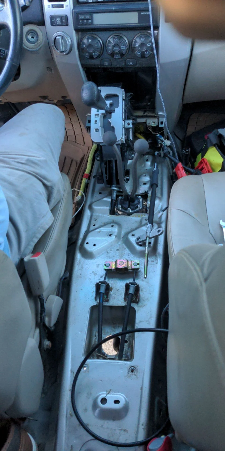

And i just dropped the old tcase, bolted the FJ Tcase in, and have been running it fine since then. since the v8 4r has and awd front axle, no actuators to worry about. attached it some frontrange twin sticks (if you wanna have a clean looking interior, you dont wanna do this lol) i shifted the transmission shifter to the front by pulling the cable and rerouting it.
