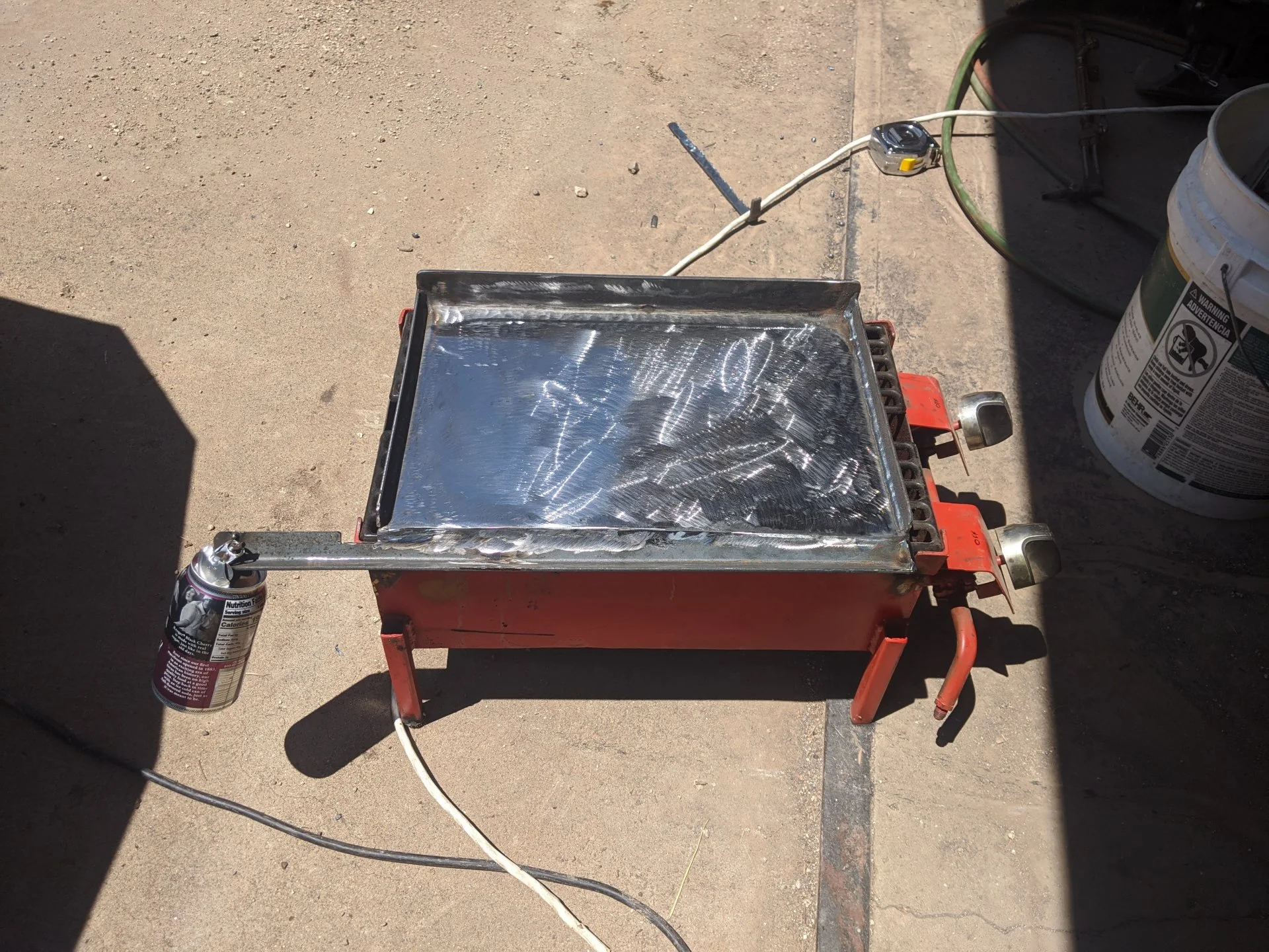

Hey @alia176 have you seen the griddle top I made for my quick-n-dirty grill? It's just a piece of 3/16" mild steel. I used a piece of angle iron as a grease trough and use an aluminum can to catch the grease.
I remember that now but thanks for providing the details. I need to get some 3/16"
