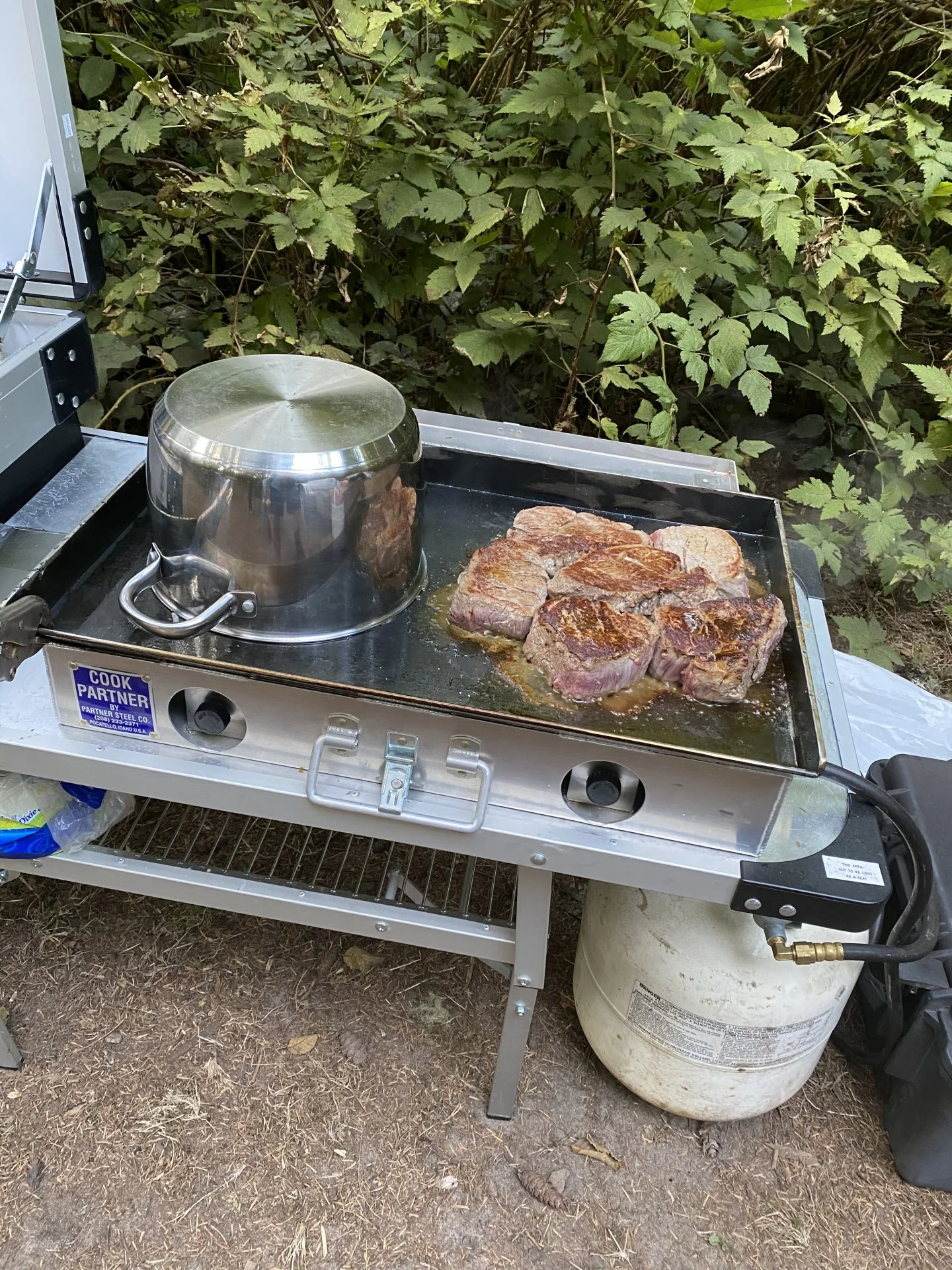

Whipped this up a few months back.
Sized it so a Cookpartner stove nests inside.
Works great!
Details man, details 😁
1/8" thick? Grease escape hole?
3/16th mild steel plate.
Back and sides are verticle, front is angled at 45 degrees.
No drain holes... Dealing with grease in the pan is easier than letting it fall through onto the stove/BBQ/Kitchen-stove.

I didn't want a raised fix'd handle as this packs inside a pelican case with the cook partner. It would be easy enough to add a slot on each end for a pair of hook type handles. Thats pretty low on the priority scale however.
What I will likely do is weld a coupling nit on each side and fab up a set of t shaped legs for using on a campfire. No reason handles couldnt screw in there as well.
yes, best not to have handles conducive to having the thing tilt over with a bunch of burgers on it while a hungry crowd is anxiously waiting...
