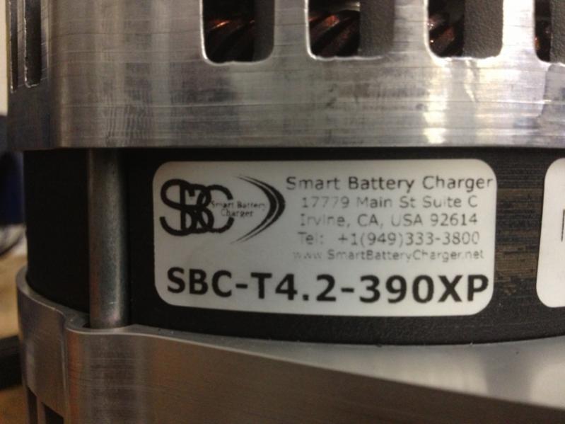

Great customer service from these guys. They offer "bolt on" alternator solutions. Specific to 1hz and 1hd-t

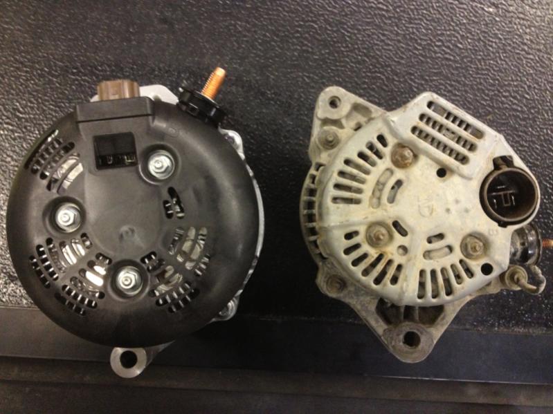

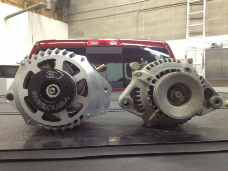

I got myself the 390A version and this thing is huge an heavy. "Bolt on" is in quotes because the alternator mostly bolts in. I had to modify the adjuster bracket and grind off 1.5inches from the bottom. I also required to use one size up on the fan belts and upgrade the cable that goes to the battery.

Just wanted to do a little update for anyone that plans to upgrade there alternator to one of these M2k.inc alternators. The direct bolt on is achieved by using this alternator adjuster bracket toyota part #16381-17020. -(this one works and I have tested it). you can also run the original sized belts!!!
the original bracket toyota part # 16381-17010 needs to be ground down due to the different arch in the bracket.
