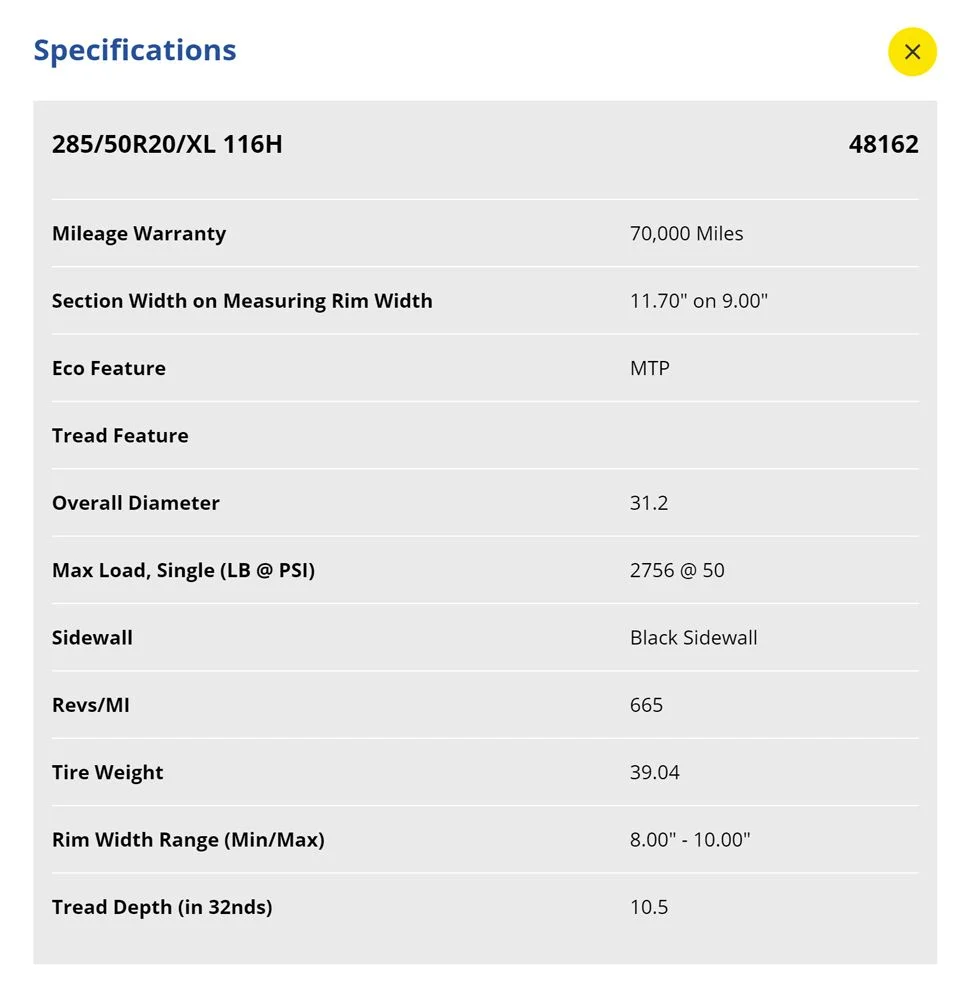

Are the LTX tires P-Metric and not LT load ratings?
I have less than 500 miles on the tires they were just put on a week ago. The tech also mentioned I should drive around for a couple of weeks for the tires to round out. They are the Michelin Defender LTX M/S
They are XL ISO-Metric:
And the RCTIP for these tires on OP's 2013 LX570 is 34psi F/R.
HTH
They are XL (Extra Load / Reinforced) ISO-Metric and should be inflated to a Cold pressure of 34psi Front/Rear on your 2013 LX570.
HTH
