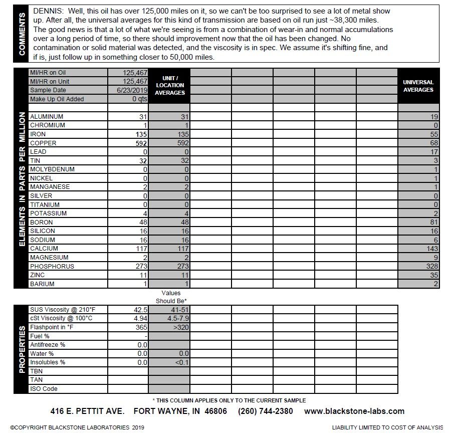

If anyone thinks that 120k is a good plan for their AB60F or that it's a 'lifetime fluid' ...
I'd recommend to start changing it at 60k. This truck was out of Walnut Creek, CA and had 104k on the clock after 5 years in service. So it was primarily highway miles. Reportedly, the PO had a place in Tahoe so it did see mountain pass use, but lots of highway at 21k/year. The receiver had no indications of any towing prior to me. So I wouldn't call it 'severe use' in the first 104k. In my 20k prior to the fluid change there was quite a bit of trail use and some towing.
