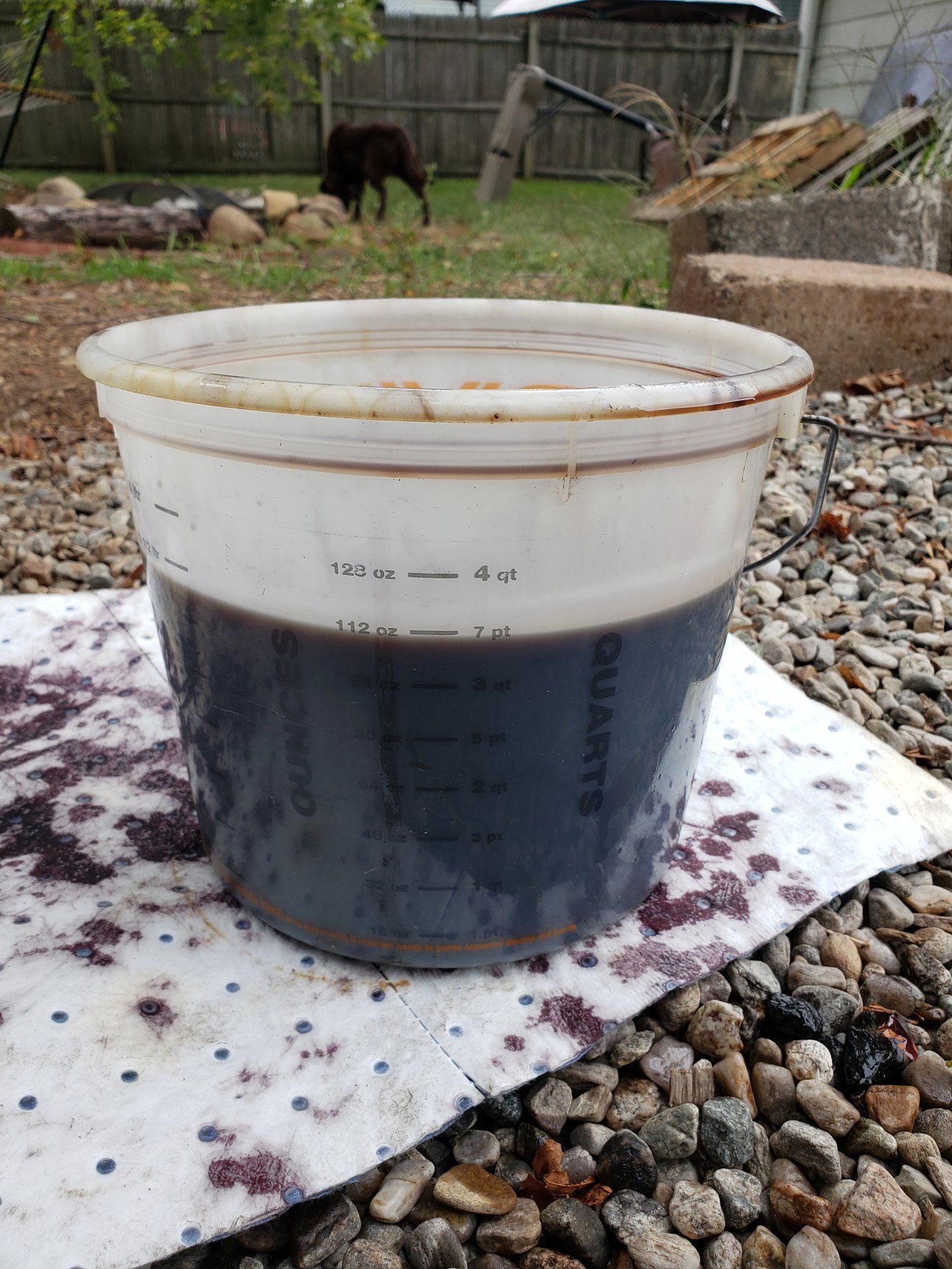

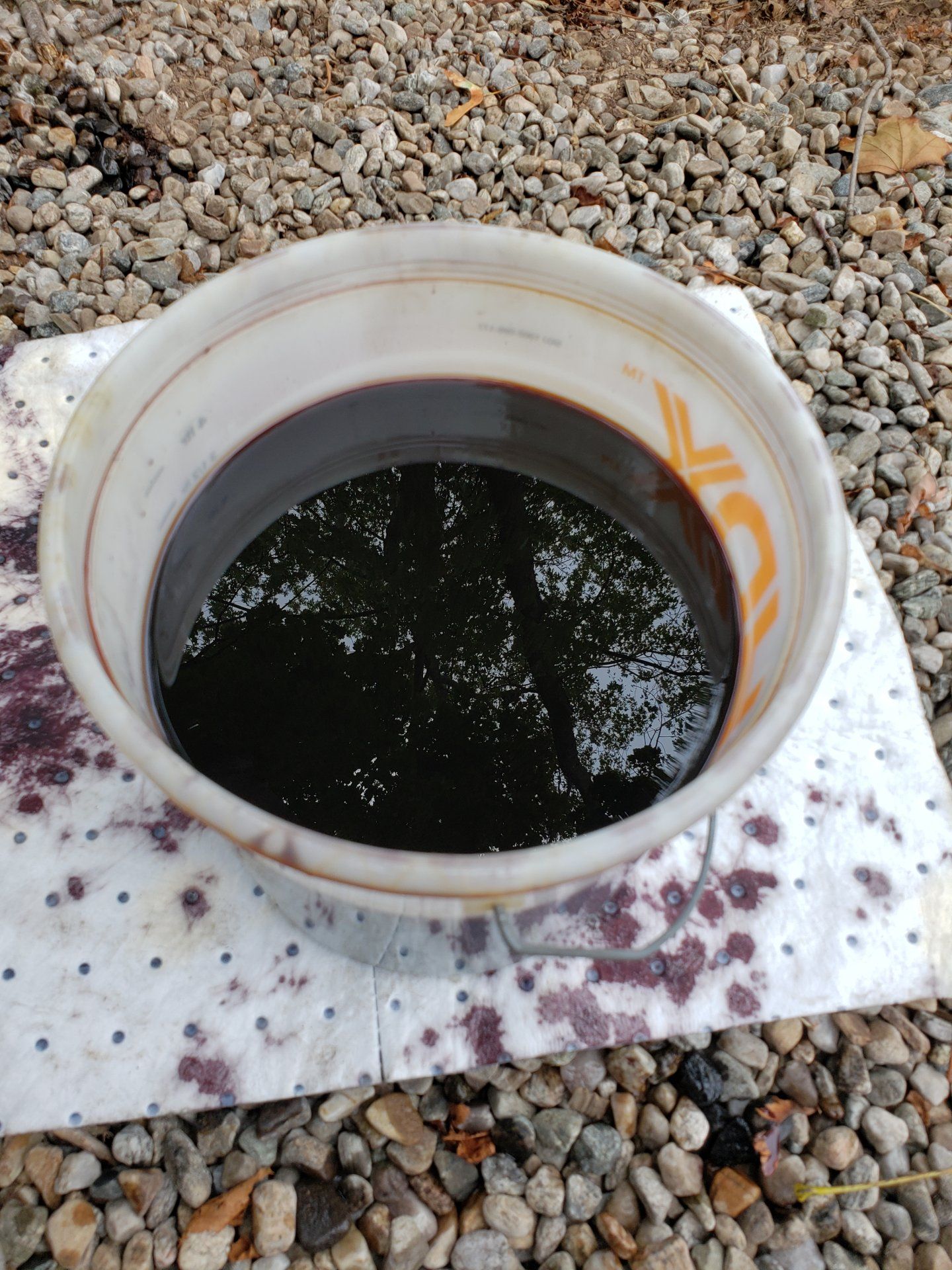

Here's what the 200k transmission fluid looks like on a dealer kept 08 LC. Was dark like red wine.. Didn't smell too burnt though. Im gonna do a couple more drain and fills for now. Maybe every other oil change. Almost 4 qrts came out.
I have 130k on my 14. Had the fluid changed last month and could tell the shifting from forward to reverse was much faster.
