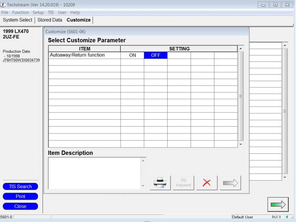

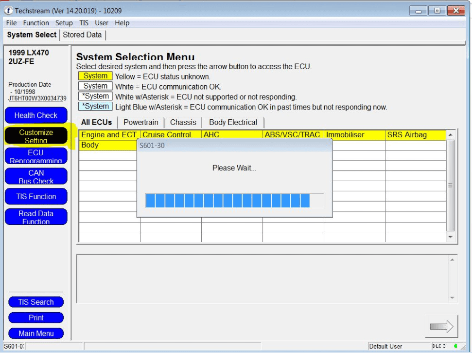

I just turned off Autoaway on my 1999 model LX470. Pictures below.
Go into the "Customize Settings" option from the System Select Tab.
Select "Tilt and Telesco" option and click the next arrow.
Click the "Off" setting and then the next arrow button to apply the change. Then click the red X to exit changing settings.
That turns off the "Autoaway T&T option.
