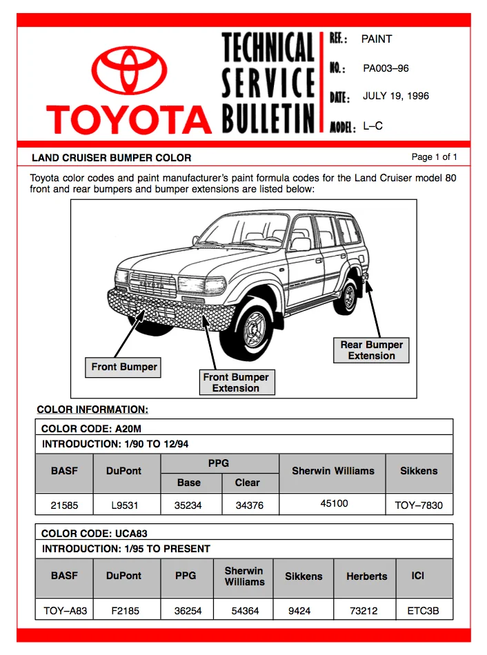

my front bumper has a ton of paint chips missing. not sure if it is from a massive haul on a gravel road or why it is so "cosmetically challenged".
but does this look like the right spray can paint code for this repair? "1A6 - Gray Metallic".
also, am i pulling the bumper off, sanding it down manually or with a grinder with some flap wheel attachment somehow - and then basically spray can painting it? is there some utility to my prepping it myself and trying to run it by a local body repair show with a paint booth? if so is there a paint code?
i found this link but for some dumb reason the paint code pdf from landtank is not opening on my desktop.
THANKS
here's that pdf with the paint code
whats the question? you asked for a paint code then posted the pdf with paint codes 🤷‍♂️
no.... 1a6 is moonglow pearl and different than the bumper color. The bumpers are darker and less metalic.
also the prep comment seems to be a question sort of? dont know how you are going to do it but that is one way. Depending on you budget and desire for perfection then yes there is absolute utility in taking it to a professional. Grinder will leave swirl marks that will likely need a high build primer first to fill then color to cover. Id swing by a local quality shop and ask them how theyd do it and how you can help if trying to save some cost. Id imagine a sand blast, prime, and paint would provide an ideal solution.
yeah. sorry. not very direct.
i’m wondering if the spray paint brand and type sounds like it will work for the 97 LX, if the paint code is correct (someone recently said there was a newer toyota supplemental on the code for the 97 vehicles) and how i would best prep the bumper if i wanted to DIY.
LX450 bumpers are different colors than Landcruisers.
thanks a lot. i’m obviously not a genius with this but is that the “UCA31 (96-97) Dark Gray Metallic paired with: 202, 6M1” for the bumpers? meaning UCA31 is the grey bumper paint?
