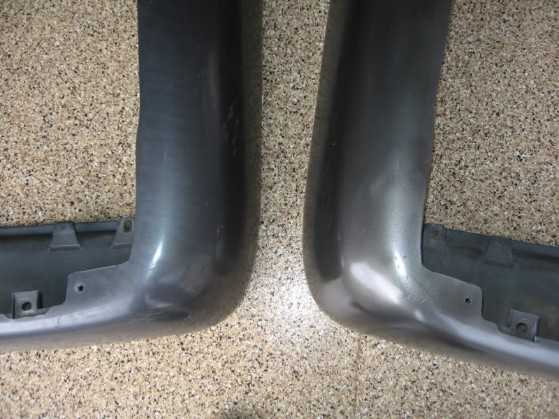

I repainted some rear bumper wings yesterday using off the shelf spray paint. It was a graphite/gunmetal paint that is made for wheels. I'm almost sure it was DupliColor brand. I'll check when I get home.
The color match was very close. I also used it to respray my grille. It matched the grille paint EXACTLY.

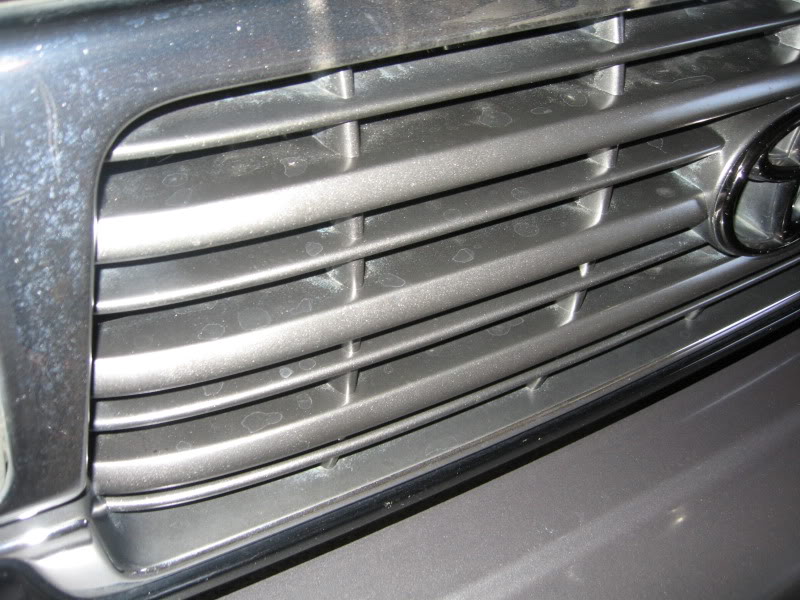

Top and left are original, bottom right is Duplicolor High performance Wheel Coating, in Graphite color.
Left OEM, right Duplicolor.
Exact match on grille. I did not mask this, and you cannot tell where the new paint blends with the old.
