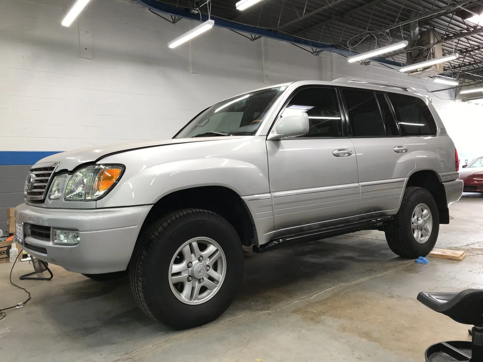

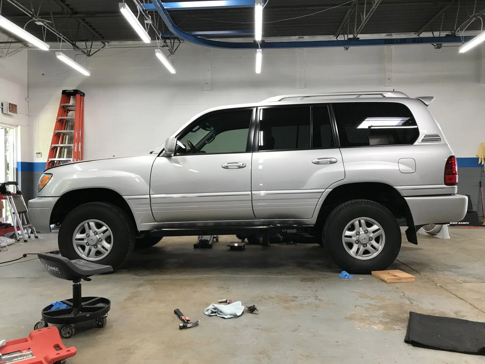

I got two sets of those 16s. One with street Michelin’s and one with ko2s. Fit with no issues at all. My lx is an 07.
