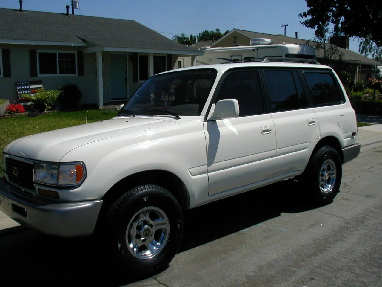

Looks like a "Toyota" on the rear hatch lock and the lack of emblems on the back lead me to ask if it has been in some wrecks?
lots of white overspray from what im seeing in pics. also front quarter panel not lining up in side view pic view down the body.( sorta sticks out).
white overspray underneath. looks like maybe front quarter and front end been resprayed.

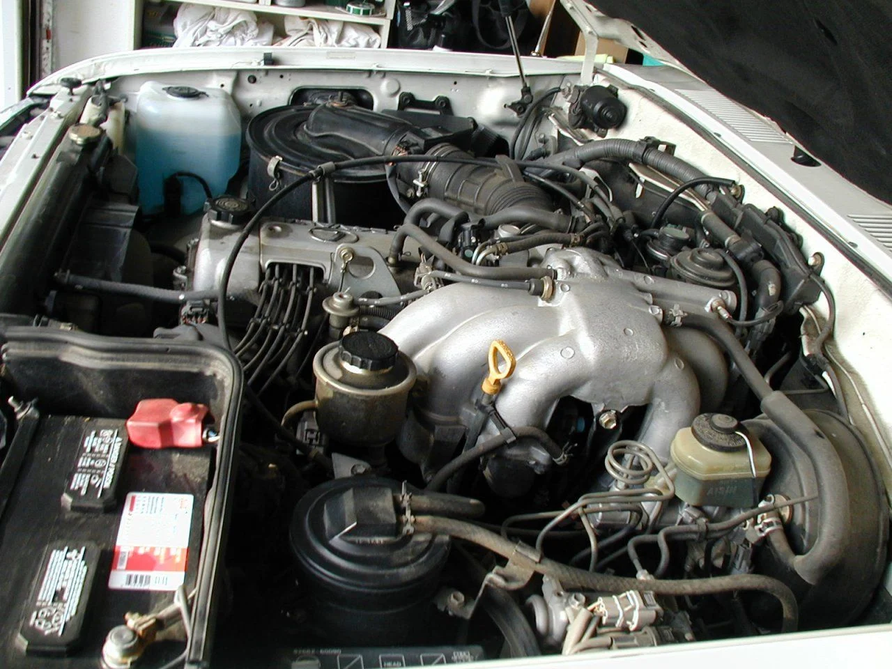

other giveaways- hood bolts white. engine bay quarter white. possibly reworked and sprayed.
- drivers side door moulding lower plastics replaced slightly low. slight overspray near b pillar.
- firewall pic shows two bolts with white heads. likely from fender area put back on firewall.
- hood hinge white.
- antenna tip bent
- hood not lined up even
- cat protectors not in-line ( rear cat replaced) typically cats last over 100k miles
- left sway bar bushing replaced.
- rear main seal leak ( wet sway bar or valve cover leak on that side)
- mirror posts white
- brake fluid res. low needs topping off
- door handles white
