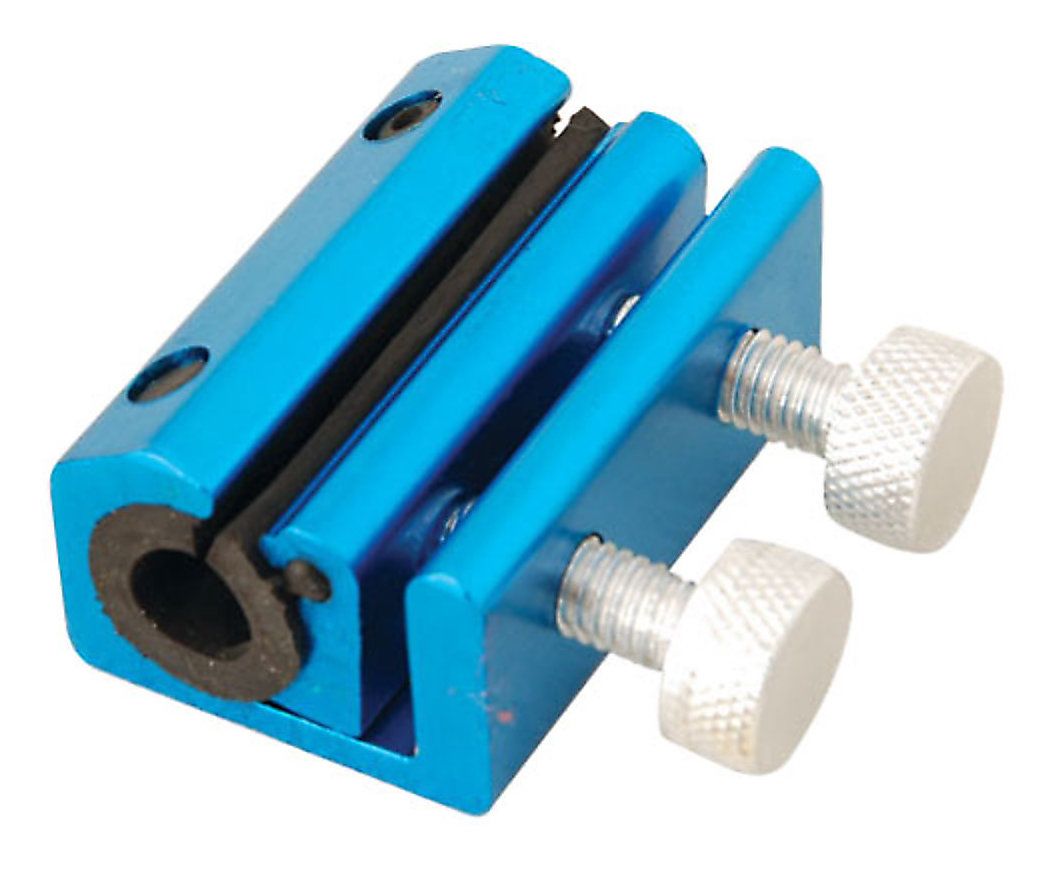

Cycle Gear on Sprague by Home Depot, I got a can of PJ1 cable lube & an applicator there a few years back & it works like a charm on every cable I own.
What was the applicator? Something like this?
