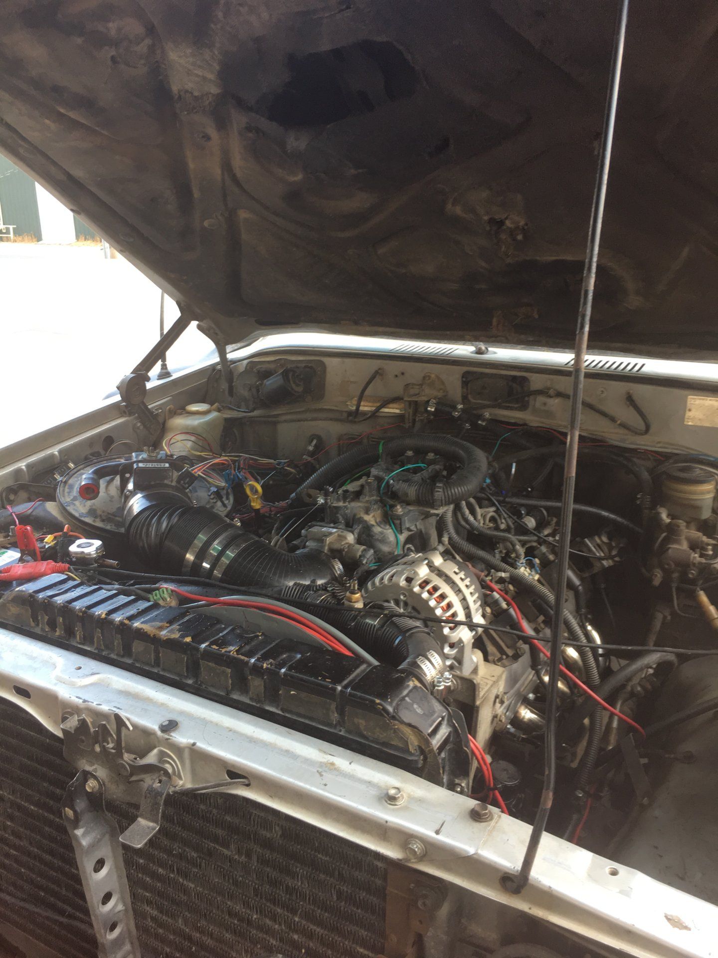

finishing up with my 4.8L swap into my 60.
Time for the shift lever for the ranger To go in meaning time to cut a hole
Who has this setup installed in their rig.
Where and how did you guys run your shift lever. Pics are greatly welcome
Trying to get this wrapped up before sas2

In and mated just working all kinks out

Very nice, how high does yours sit in the engine bay? I tried to be conservative but think it may have ended up a little too low
same boat I think I’m low but letting it ride right now being as I’m trying to get it done for the solid axle summit.
Might end up raising it when I get back but not much room to raise
