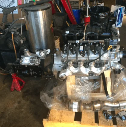

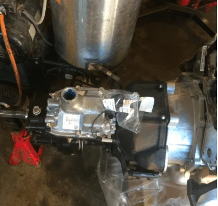

For those of you that absolutely, positively, gotta fawkin' have a 5 speed, here is a shiny new Vortec bolted up to an H55F by way of a bellhousing adapter and some other technical stuff in there. Keeps the trans/TC in about the same position as original layout.
Not my junk - but another Torfab production on its way into a 60. These LC9 / eRod crate motors are sweet - clean, cheap, easy to acquire and they come with all the parts plus a 24 month GM factory warranty.
My Norse gear guru and his gang have a swap waiting list kind of like the one for Seahawks season tickets...
