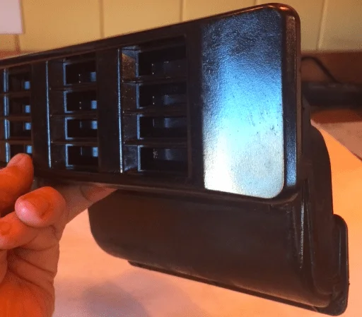

Unpacking, cleaning, etc. some bits that have been acquired through the kindness / generosity of strangers.
Soon to take their rightful places on the 73.
Here's an example - thanks Alberto!
Glad you will get to use it, Ward!
Happy New Years :)
-Alberto
