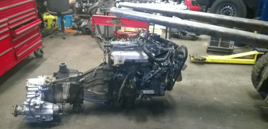

Torfab crew de-installed the 3B, with the help of a "real" fork lift (Toyota, of course).
To be replaced with one of the shiny things at bottom.
So that's what a clean 3B complete with exhaust heat shield looks like!

WILL IT FIT?
Not the Vortec, the 3B......on a pallet......We are shipping the combined engine/trans/TC to its new home in the 13th Colony and at 60 inches, it just doesn't fit on a 48" pallet. Need to find a 4x6.

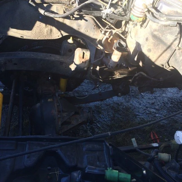

Interestingly, the combined length of the Vortec/4L65E/AA adapter/TC is just a couple inches longer than the old drivetrain, so we should be in good shape for the rear driveline length (not too short). Also, there appears to be plenty of room between the front of the Vortec fan and the radiator.
Early indications are that non-GM exhaust manifolds (Hooker block-huggers) will likely be required to clear the frame rails.
