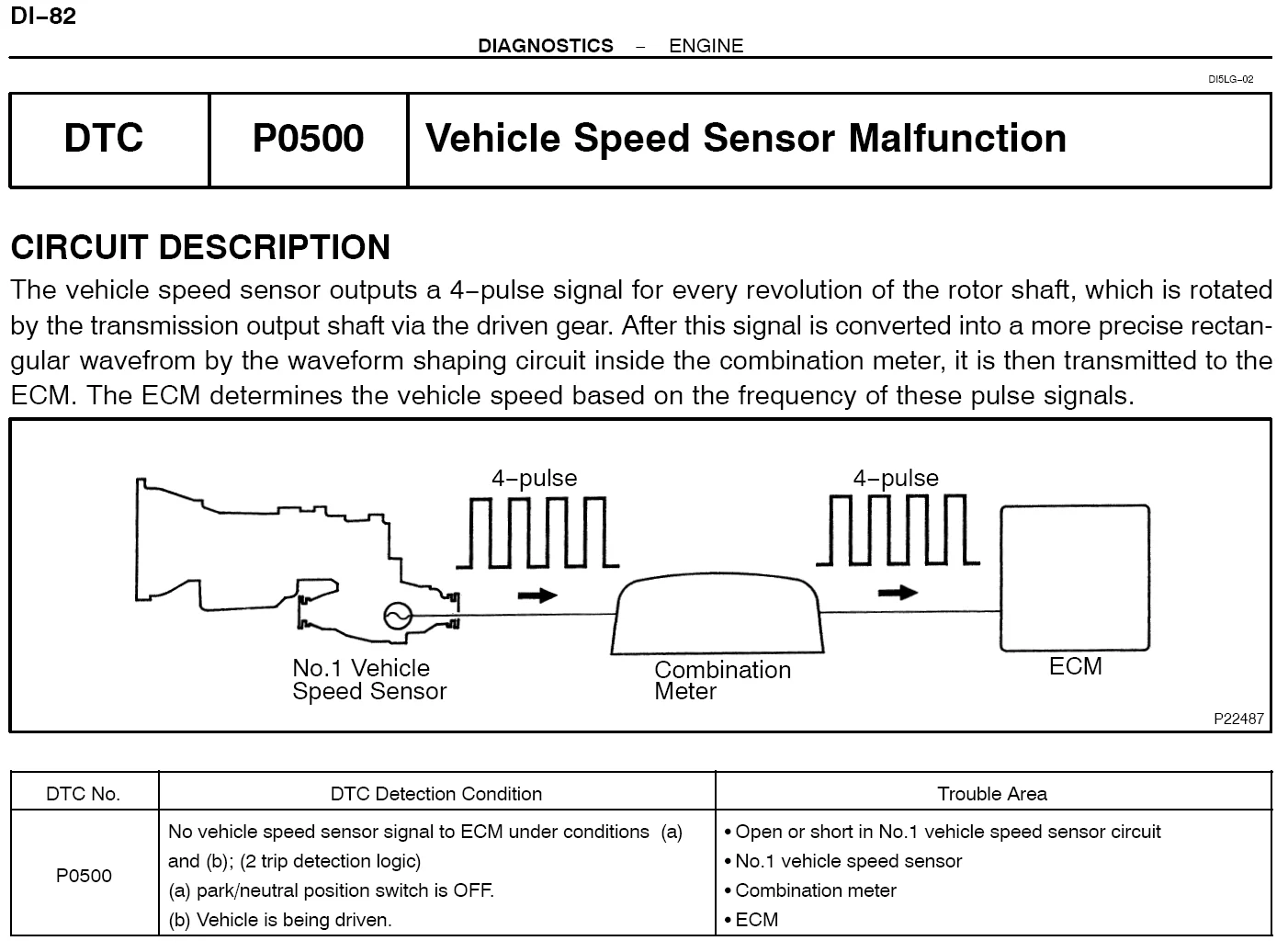

Coming to an end on ls swap with nv4500 swap trying to get ls ecm to except the landcruiser vss output as vss input also trying to do this without a Dakota digital box if possible witch I've done before but trying to eliminate the need for it. Engine guy has the ecm and ready to reprogram it for wat output I have as far as pulses I thought it was 4 pulses but can't find a the answer I'm looking for.
Thanks Tommy
Looks like it is indeed 4 pulses/rev
