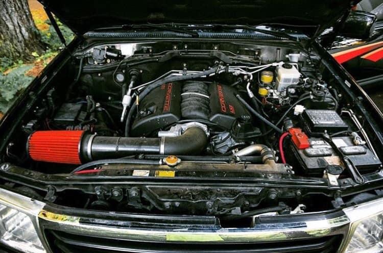

Thanks for your response. I just want more power. Our motors in our truck just doesn’t have enough power. I honestly don’t want to turbo or supercharge our high compression motors as it’ll cause even more problems. I think buying and installing a supercharger will cost just as much as a swap (maybe I’m wrong). I honestly need more info.
Someone on the Facebook forum posted this photo and said the thread was on mud. I have yet to find it.

Have you looked into the Doug Thorley headers and an unrestricted exhaust? @RobRed showed some serious gains on his TLCfaq site from just an exhaust if I recall correctly. If you can deal with the louder exhaust note, there's a significant power gain available for relatively little effort.
If you need even more, I would chase after a turbo or supercharged approach. "Good" engine swaps are a big ordeal unless somebody has already created a complete kit to do the swap. All the trouble to figure out mounting to frame, mounting to trans, AC compressor/lines, steering lines, exhaust, etc.... could just go towards mounting a turbo and the associated intake/exhaust plumbing. The 2UZ is an under-stressed and extremely reliable motor which had a factory supercharger add-on. It can handle a little forced induction. 5 psi would be a blast in a 2UZ.
Also worth noting the FI or engine swap route negates the largest draw towards the 100 - reliability. Not saying it's not worth chasing, but that's why you'll find such little info on it.
Might as well just go full monty and tackle the SAS while you're at it, too...

9.6:1 is high compression?? News to me.
