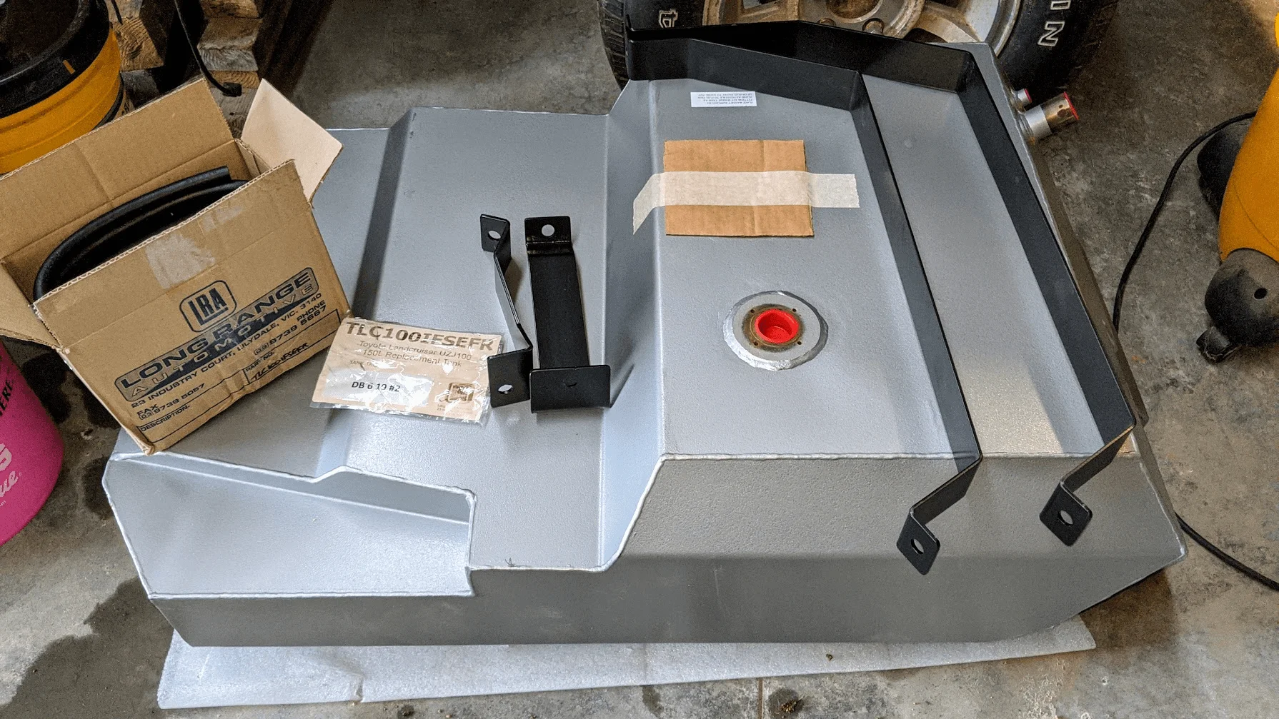

Here is the tank kit unpacked.

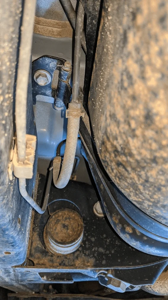

The first step of the install is to remove the stock fuel tank. Run the fuel level down to about 1/4 tank so it isn't too heavy to manage. Start by disconnecting the rollover valve vent line toward the front of the tank.

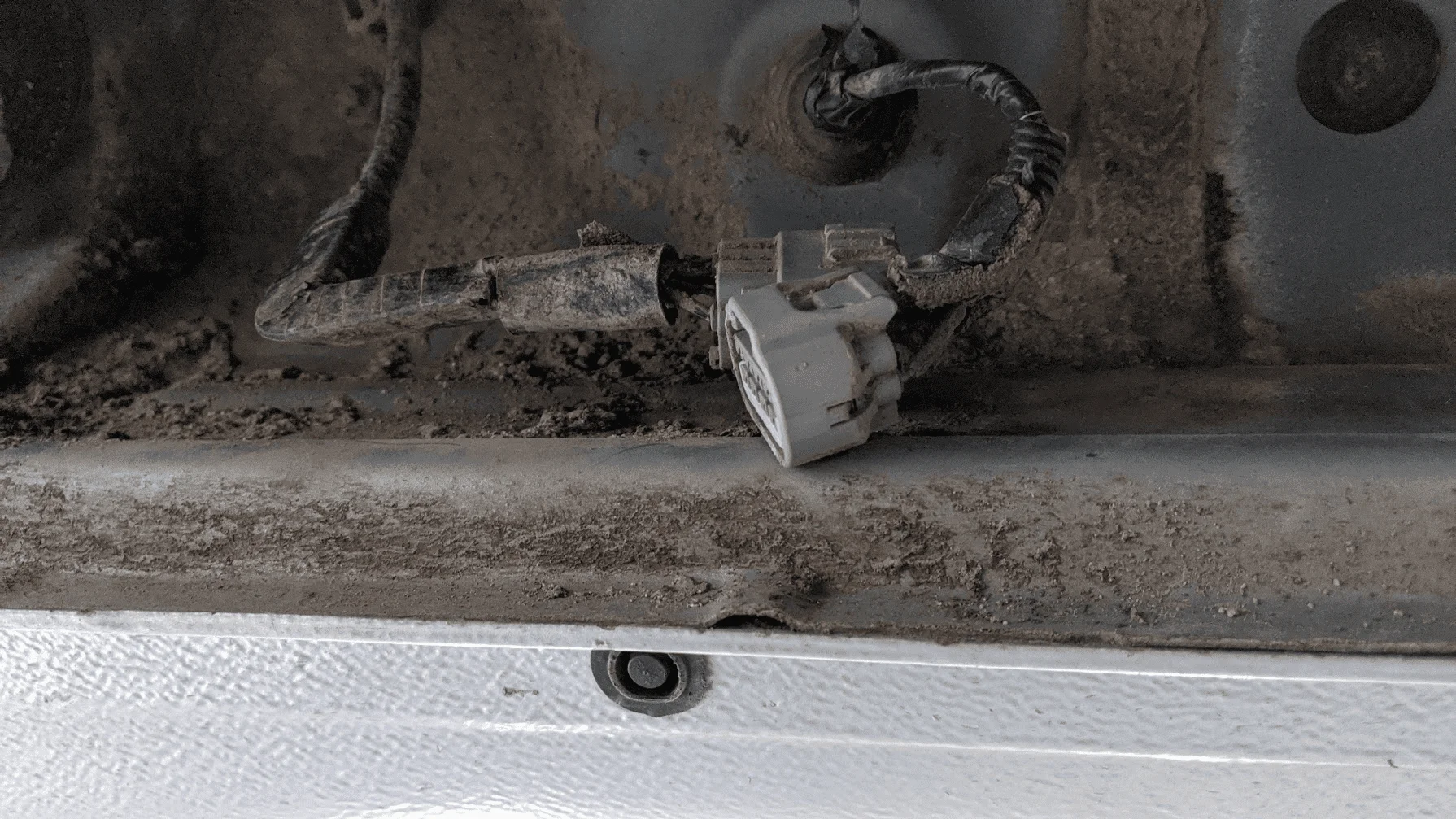

Disconnect the fuel pump wire harness and pull it from the body.

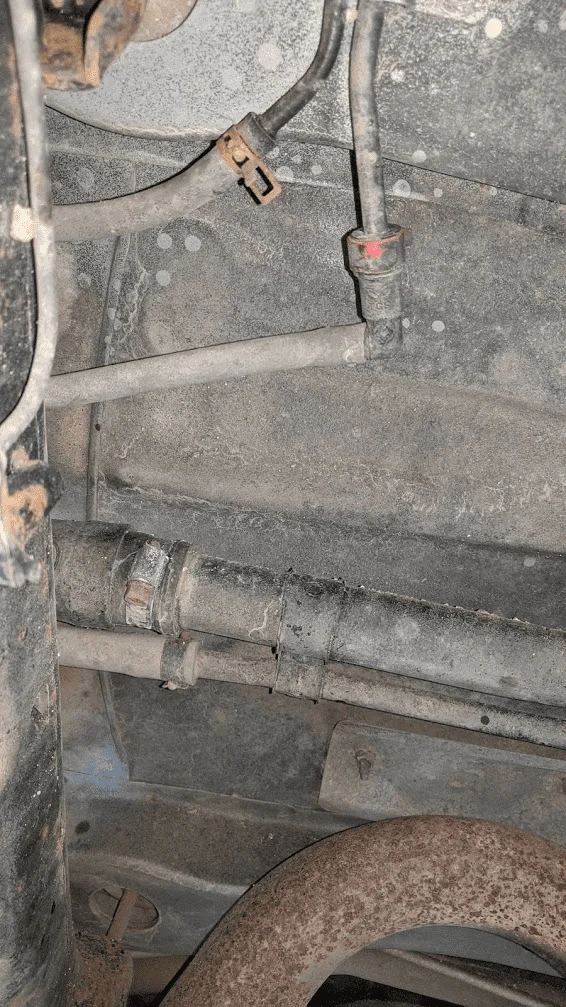

Then disconnect the fuel fill hose and fast fill hose followed by the fuel return line and fuel pressure hose. Follow this order unless you like gasoline dripping on your face.

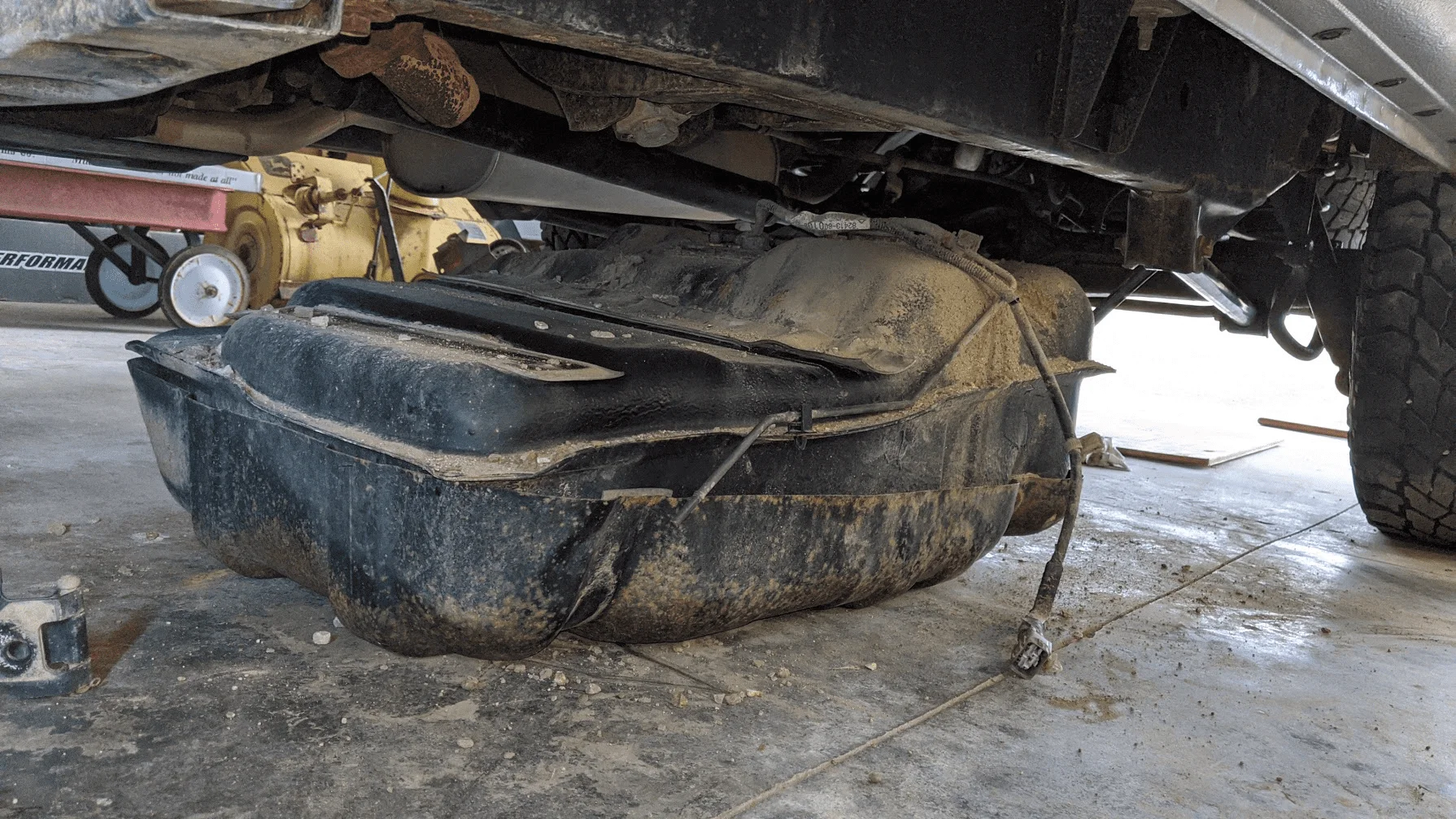

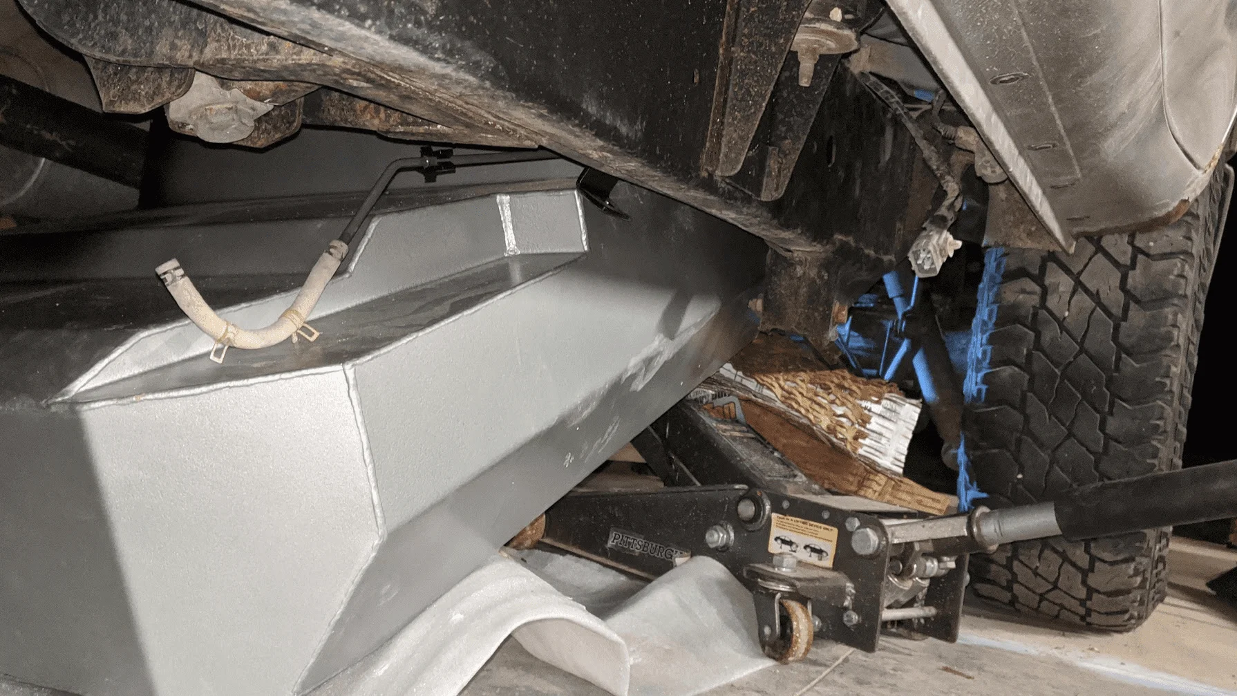

Support the middle of the tank with a floor jack and remove the front tank strap via two 14mm bolts. Remove the rear inner tank strap bolt (the outer strap bolt will be inaccessible at this time). Slowly let the tank down, tipping the front downward while sliding it forward. The tank will come out relatively easy and set on the ground. With the tank out of the way you can finish removing the rear tank strap.

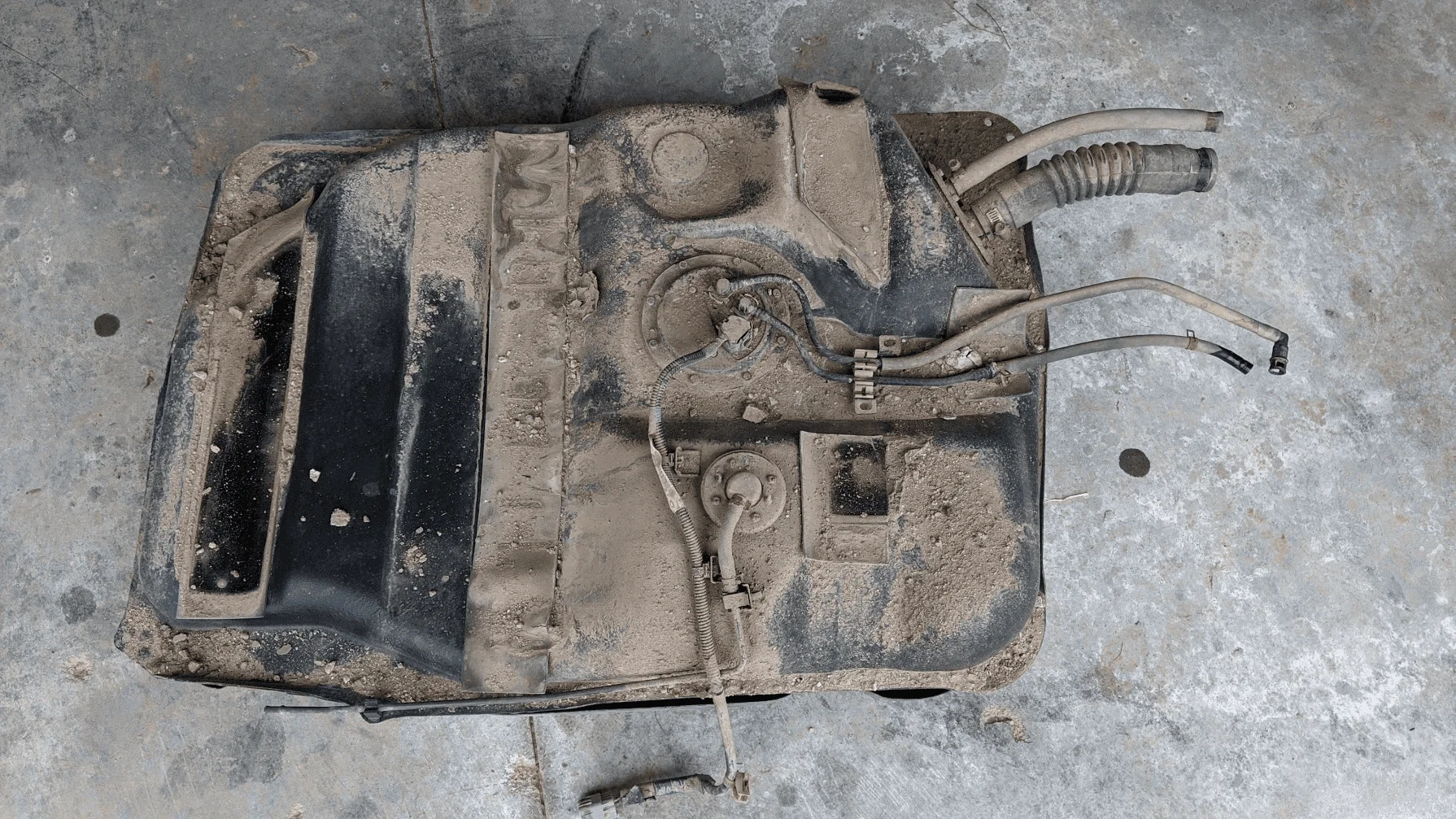

Here is the stock tank removed from the vehicle.

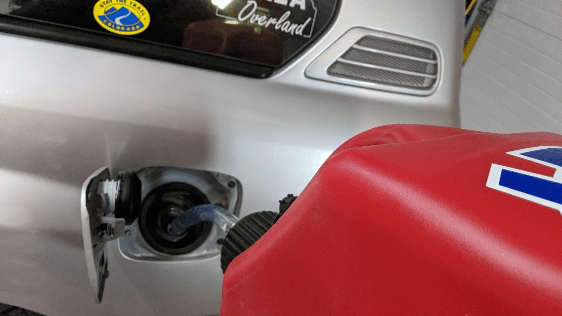

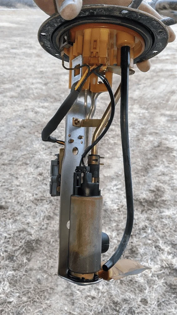

Clean the top of the tank and drain the remaining fuel into a gas can by pouring it out of the fill hose. Then remove the fuel pump assembly using an 8mm socket.
Strip the fuel pump bracket and extend it using the the bracket included in the kit. Cut the fuel pump bracket at the mid point between the bottom and where it tappers. You will now weld the new bracket between the two cuts you made in the fuel pump bracket to extend it. Then extend the fuel sending unit float arm 75mm by cutting it in the middle and welding in the float arm extension. I used small neodymium magnets to hold the arm together for welding. After the welding was done, the magnets were no longer magnetized. Extend the return hose using the supplied rigid plastic tube and joiner. This part took for-ev-er! Hot water helped getting the joiner and hard plastic hoses together, but boiling water would have probably worked better. Extend the fuel pump wire by soldering the included wires and finish with the fuel resistant heat shrink. Finally, install the fuel pump, sock and extended hose. I chose to install a new Denso fuel pump since the old pump had 330k miles on it.

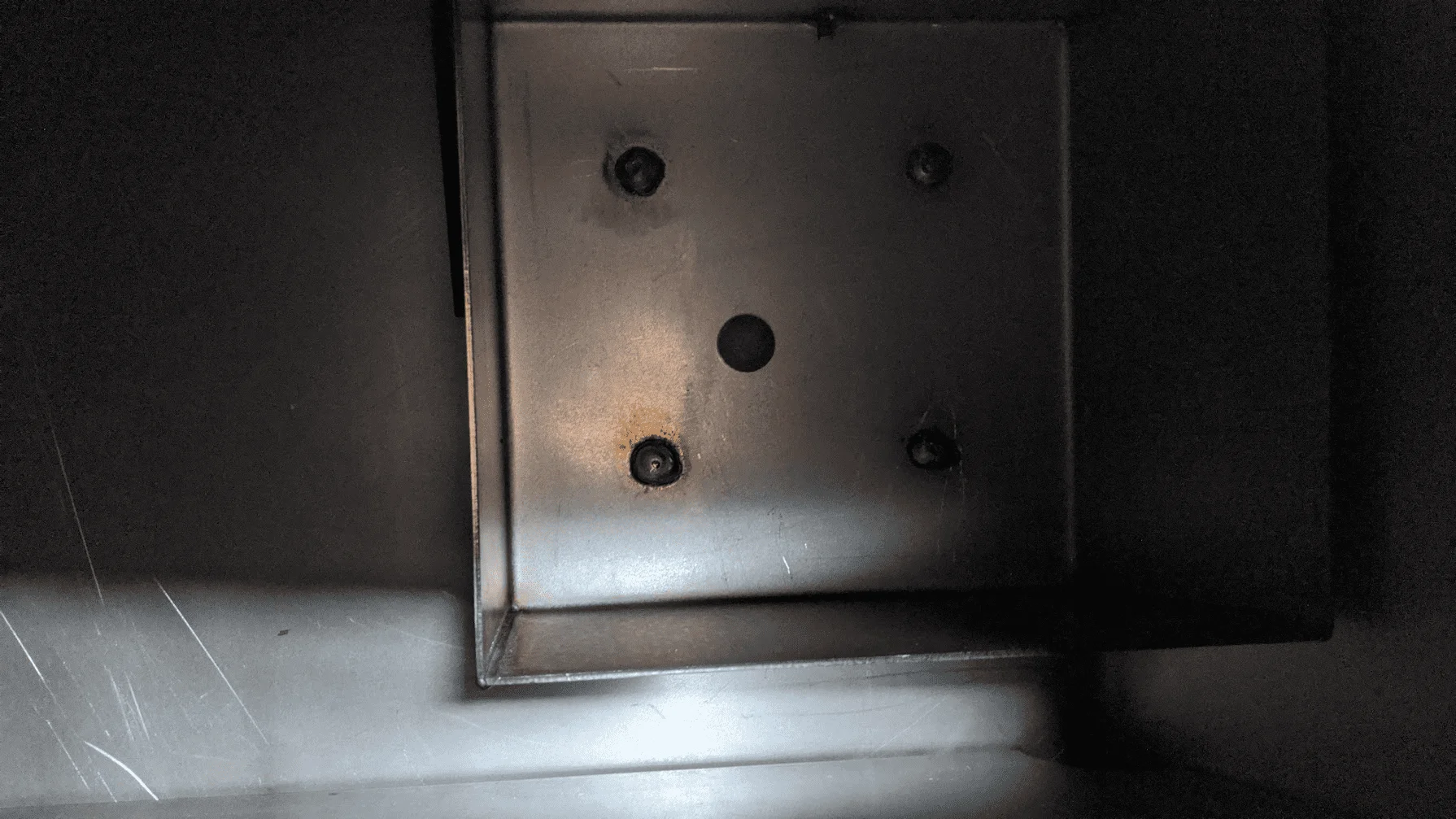

Install the supplied magnet in the tank near where the fuel pick up will be. I was happy to see the 40 gallon tank was internally baffled like the original.

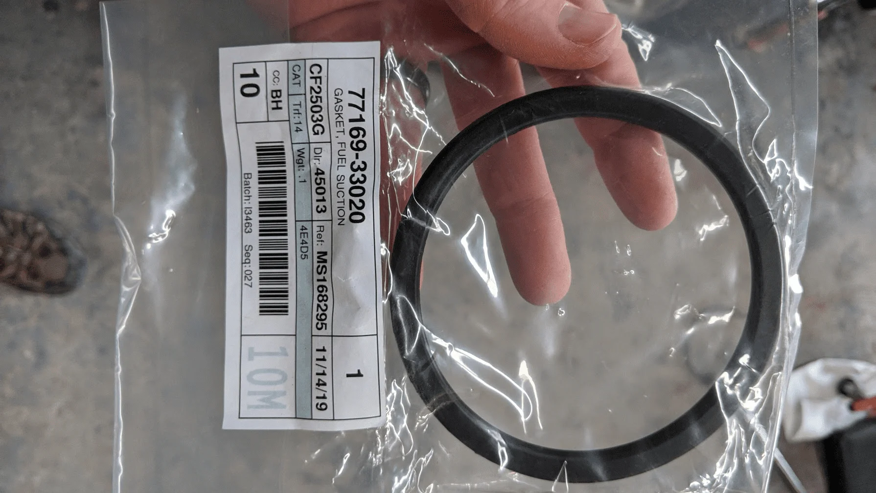

Install the fuel pump assembly into the tank. The assembly will only fit one way since the top of the tank is drilled in a pattern. Use a new gasket.

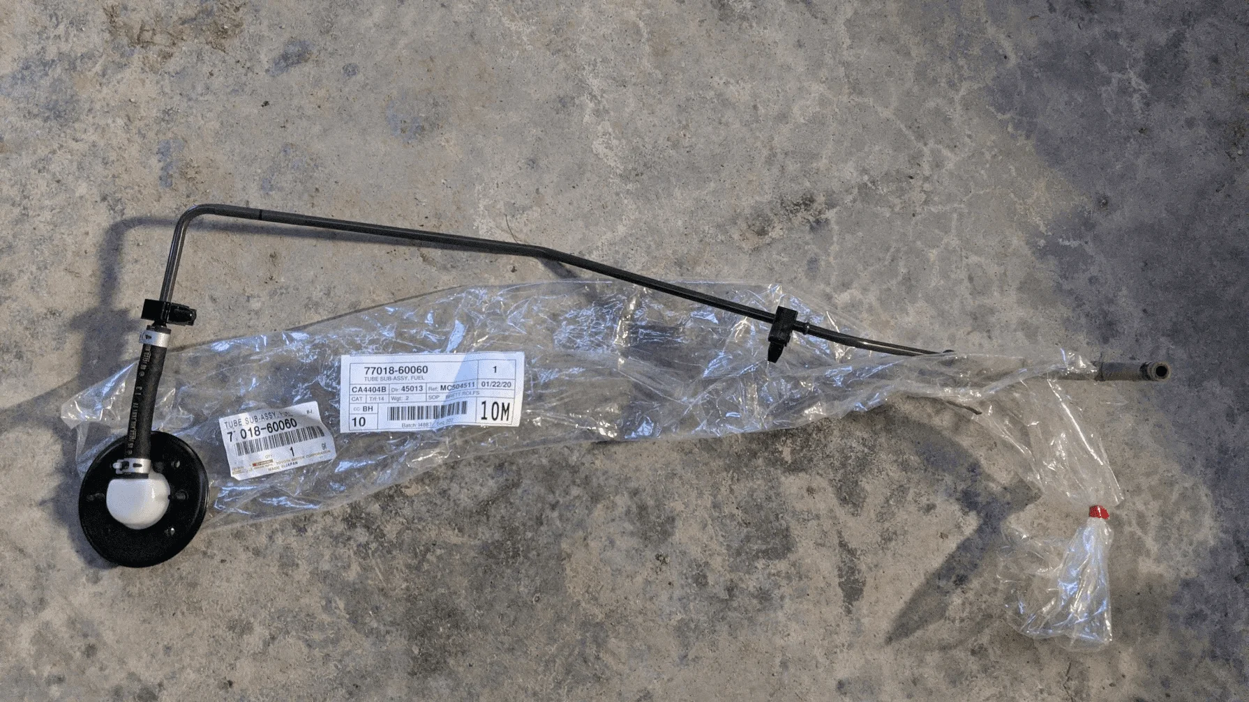

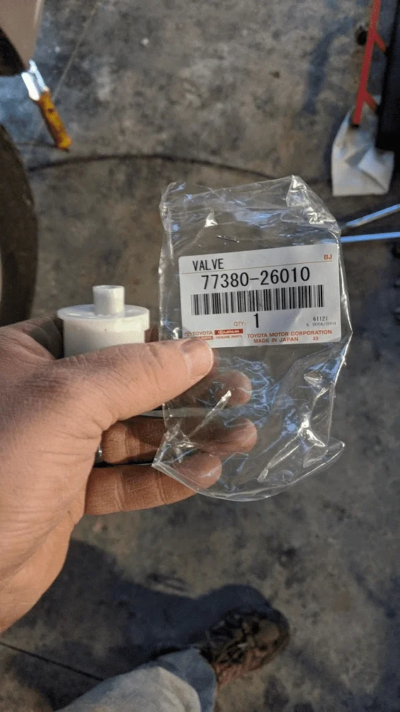

Install the rollover valve and tube assembly. I used a new tube assembly and rollover valve and recommend installing a new tube assembly since it includes the gasket for the rollover valve.

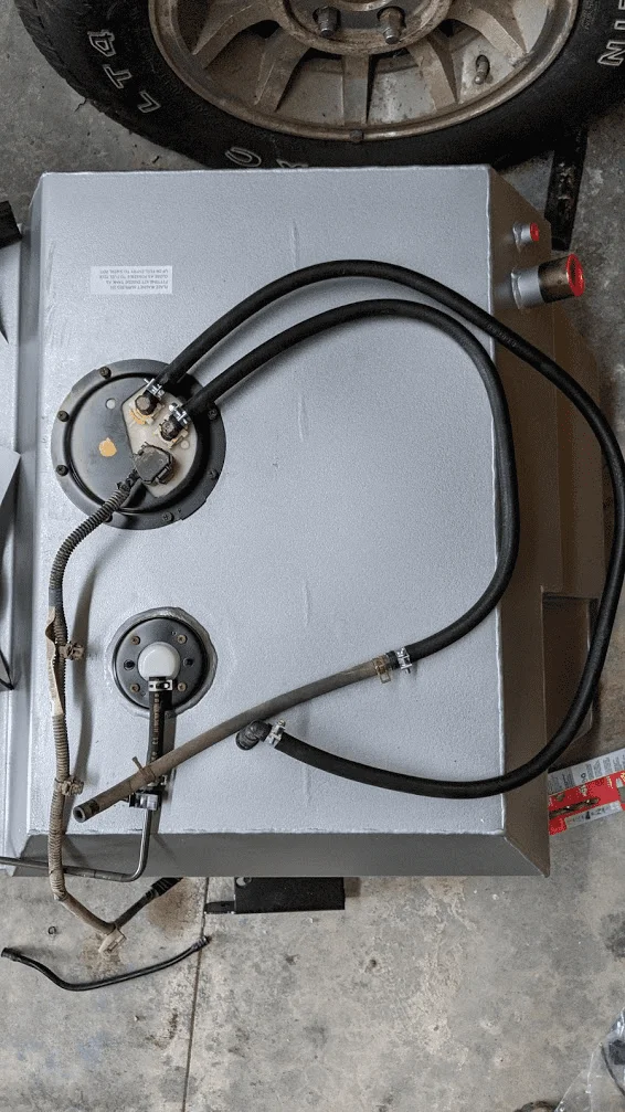

Extend the fuel pressure hose by carefully cutting the couplers from the stock hose and affix them to the provided 1000mm hose. Extend the fuel return hose by fitting the existing coupler and joiner to the 600mm hose.
Here is the tank fitted with the fuel pump assembly, fuel pump wire harness, rollover valve assembly and extended fuel lines:

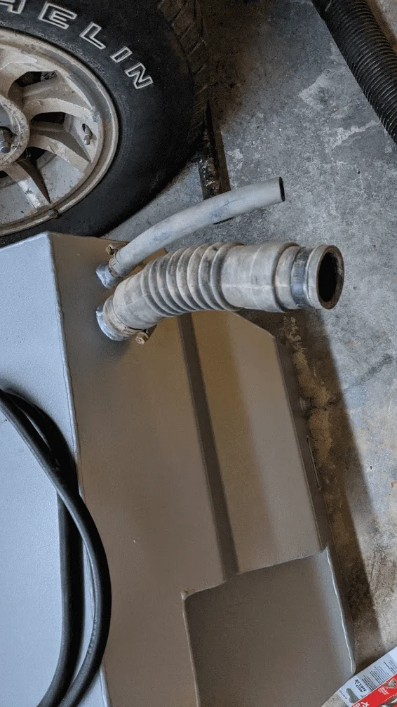

Trim 90mm from the fast fill hose and affix it to the tank with the provided brass barb. Install the fill hose.

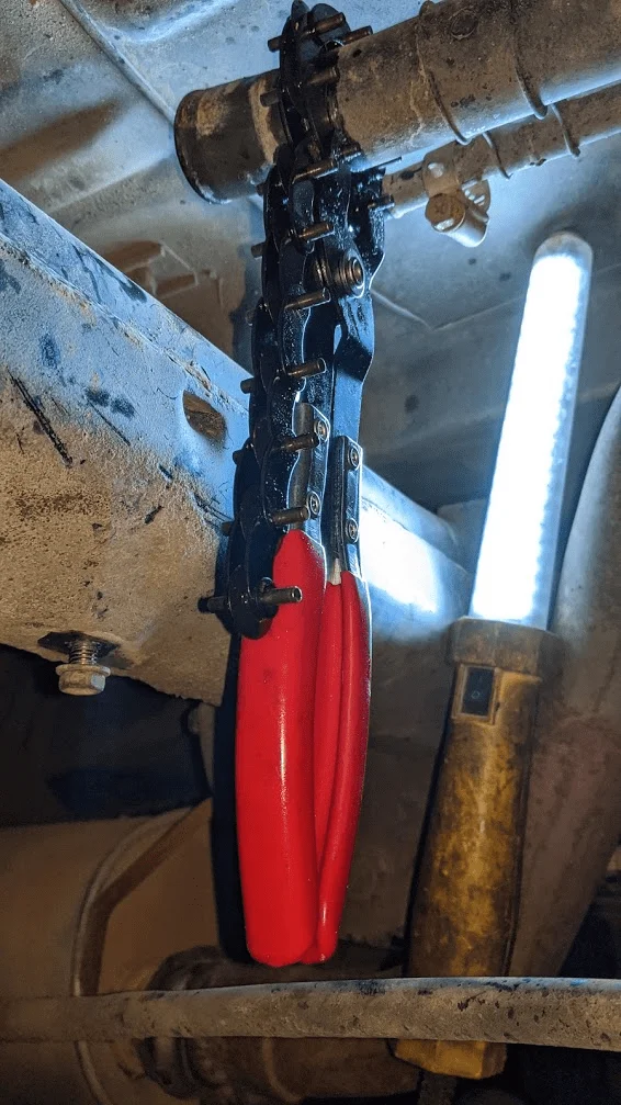

Use a tailpipe cutter to remove 50mm from the tank end of the steel fill hose. This was my first time using a tail pipe cutter like this and it was surprisingly easy.

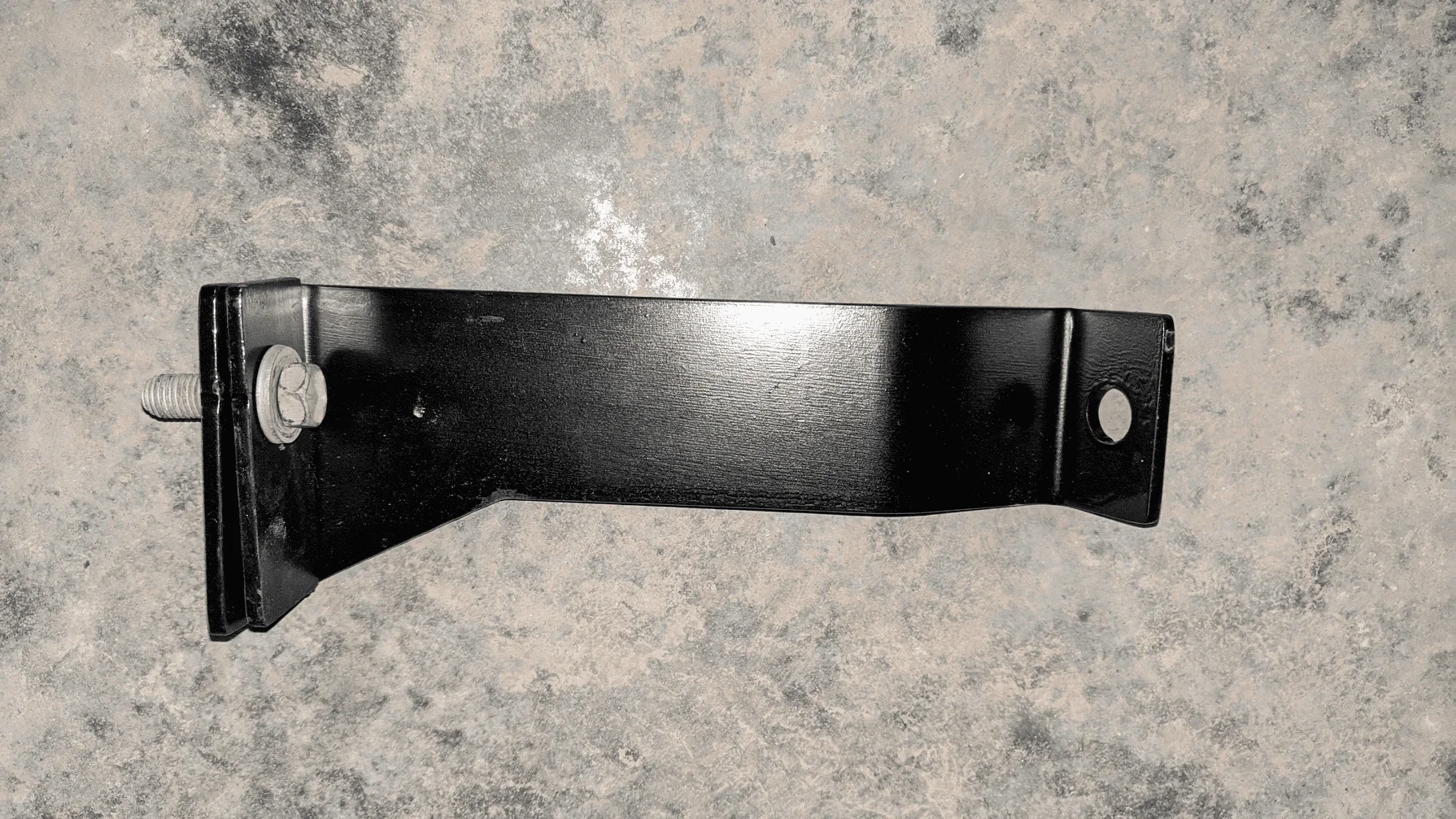

Install the front inner fuel tank strap mount. Reuse the original tank strap bolt and included 8mm bolt to fix it to the body. Using the bracket, use a 21/64" drill bit to cross drill the body. Install two 8mm bolts.

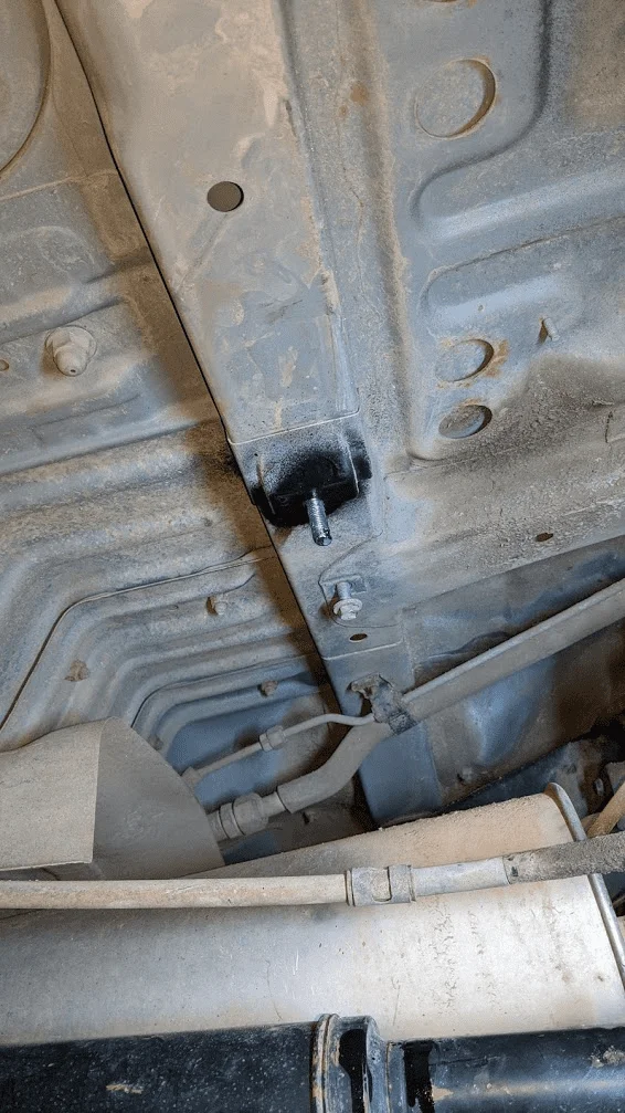

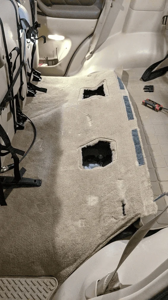

Install the rear inner strap mount. Fold the rear seats forward and lift the carpet. I held the carpet up with a 4x4 chunk of wood to prevent the drill bit from damaging the carpet versus removing all the trim to fold the carpet forward. Using a 13/32" drill bit, drill through the hole in the OE tank locating bracket and through the floor. Install the floor brace and bolt through the body.

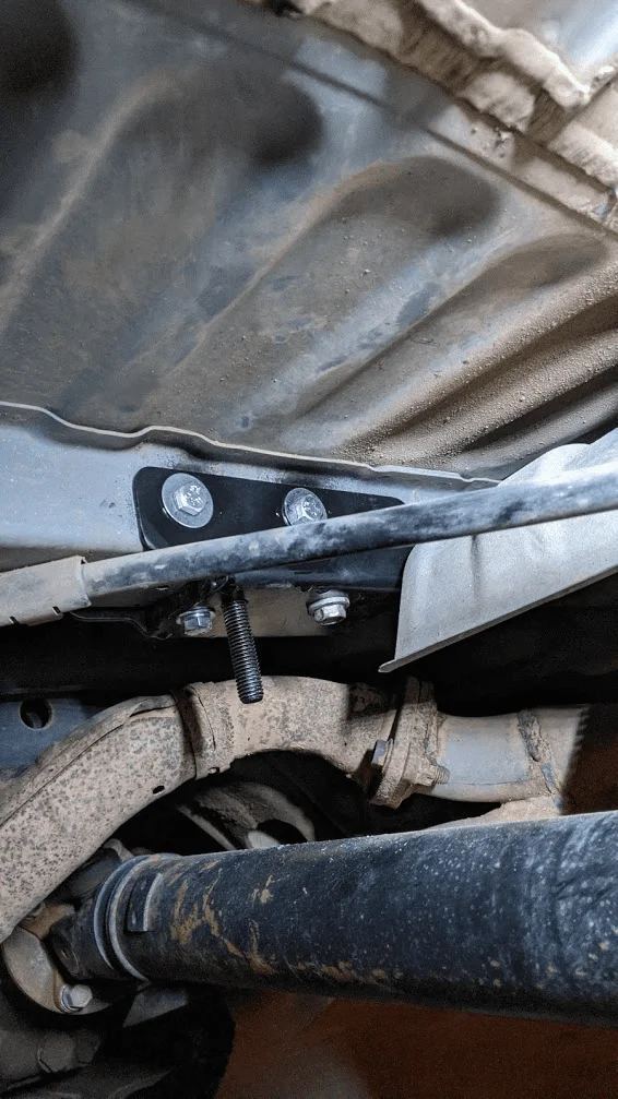

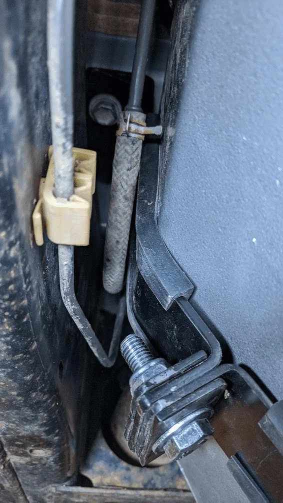

Install the outer side tank strap brackets. Use the original bolts and don't forget the reinforcing plates included in the kit. The long strap bracket is the rear bracket.

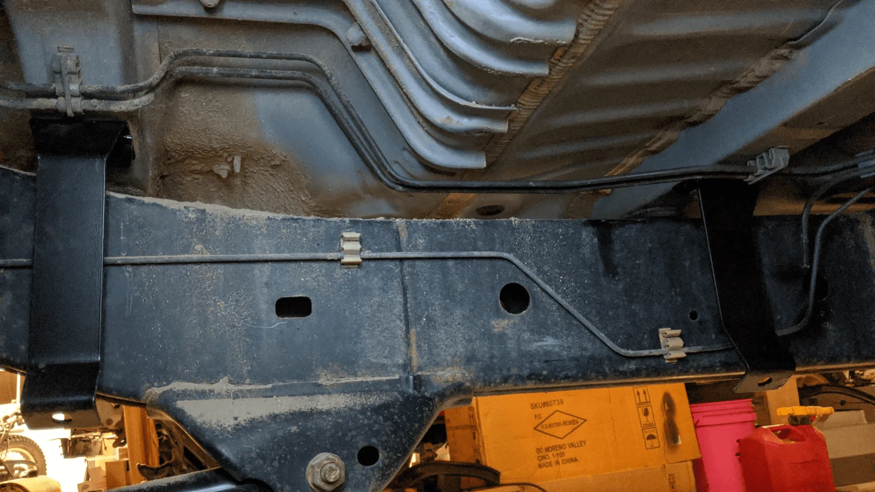

Slide the long range tank under the cruiser. If your cruiser is stock, you may need to lift the frame some to fit the tank under the frame rail. It was a TIGHT fit with my OME 2866 coils. Lift the tank into position guiding the filler hose onto the steel filler line. Position the fuel pump wire harness over the frame rail to prevent it from getting pinched.

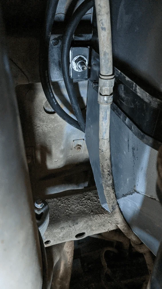

Fish out the fuel and return lines out the side of the tank before securing tank to the body.
Fit the tank straps with reinforcing plates and tighten to secure tank.

Reattach fuel pump wiring.
Fill the 40 gallon tank with the fuel you drained from the original tank. I also replaced the gas cap.

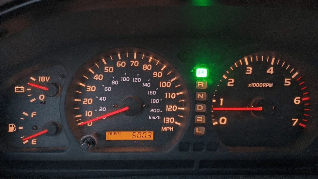

My observations for tank level at the gauge:
3/4 - 35 Gallons
1/2 - 22 Gallons
1/4 - 11 Gallons
Low Fuel Light ~ 6 Gallons

The Roll Over Valve, Tube Assembly, Fuel pump gasket and gas cap were about $70 from McGeorge Toyota.
