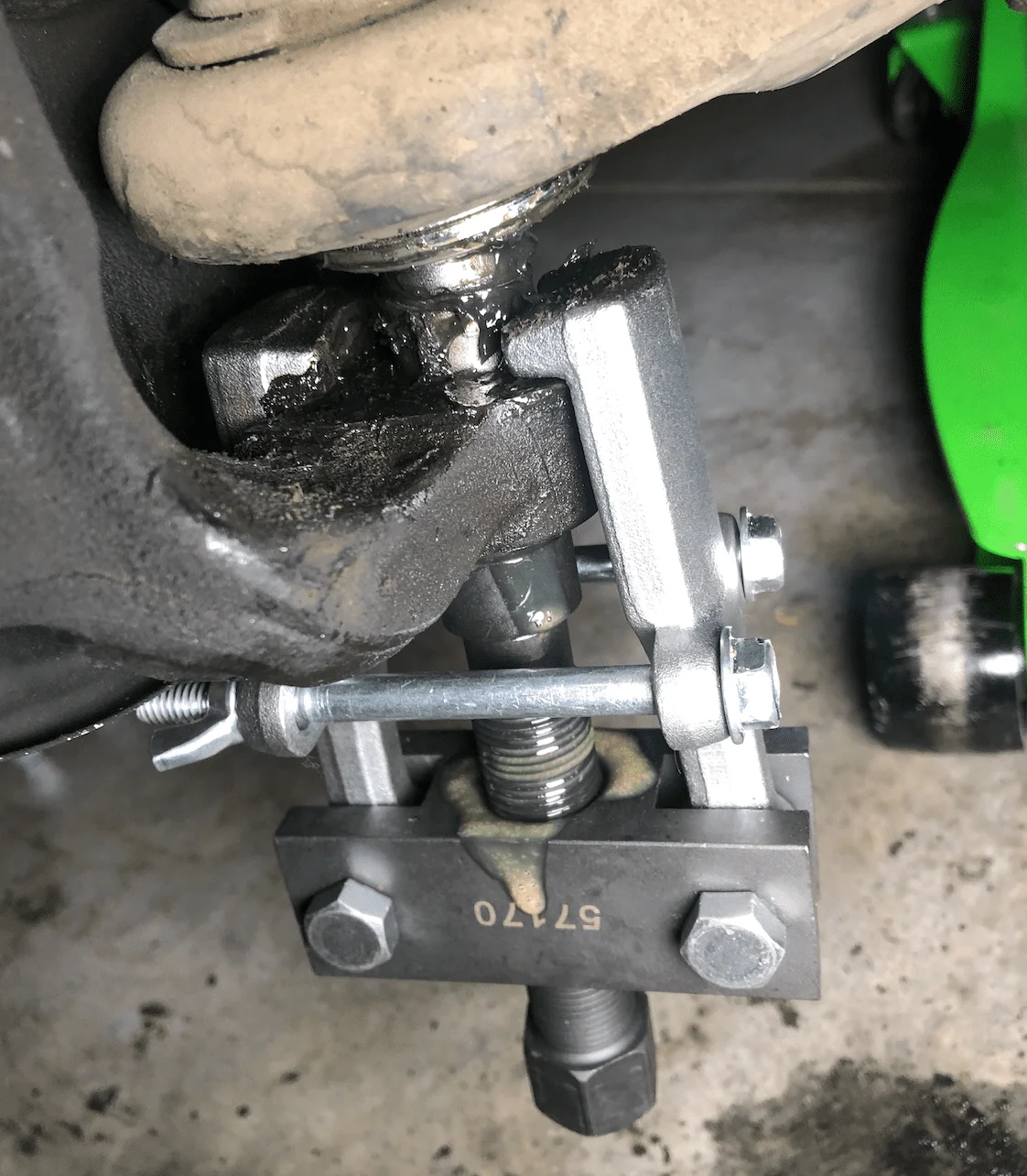

Thanks, I am fighting with my stubborn LBJ, already cost the whole yesterday night, no progress. I will try the adjust puller I just rented from Autozone this afternoon. How about removing the shock first? will this relieve some tension in the lower arm? Or try to jack from the LBJ bolt directly will do the trick?
OK, I finally get this su*ker out, below are the tricks (probably only for the case you want to replace with new LBJ):
1. directly try the "adjustable puller 27170/57170" from Autozone and if you bought one from amazon is also good, because this probably your Life-saving straw in some cases in the future. Don't waste your time and money on something else~ The reason it will work because it is disassembled then you can insert one of the arms behind the brake rotor dust plate then found the right position.
2. If you use that adjustable puller, it is better to remove the rubber dust cover from the LBJ to give enough space for the setup
3. suggest using the little adapter that comes with the puller (hang on the chain), it will make the turn very easy
4. Extra-long handle rachet or brake bar required.
5. Be sure to do this in the morning (or after anytime you have a good rest ) and after using the toilet, I am happy I follow this, otherwise, I will not have that much of energy and probably already wet or s*** in my pants when you heard that thunderbolt from the final cracking.
Below is a pic of the position:
