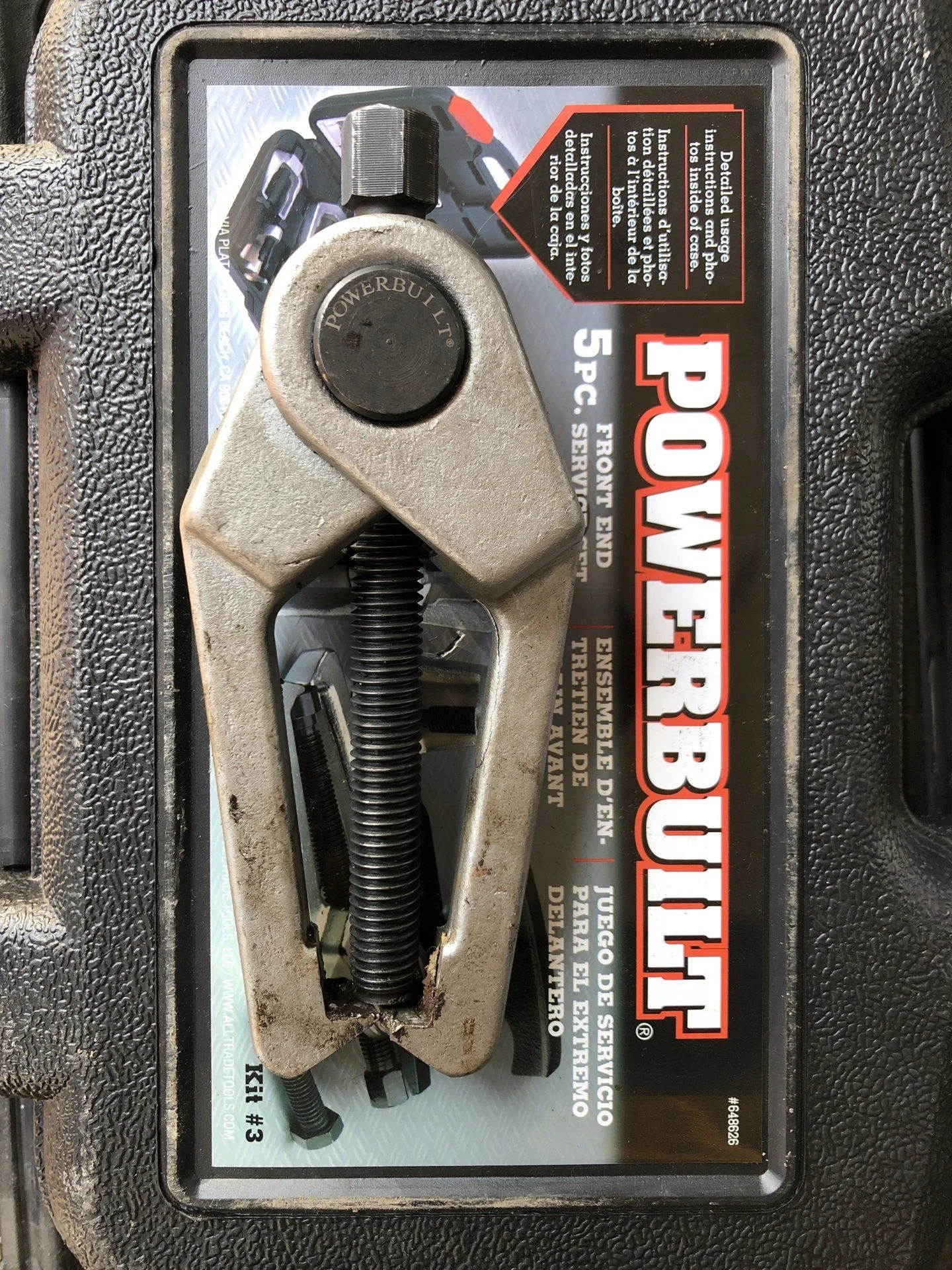

The ball joint separator I was using today keeps popping out, so I was going to try another one from Harbor freight.

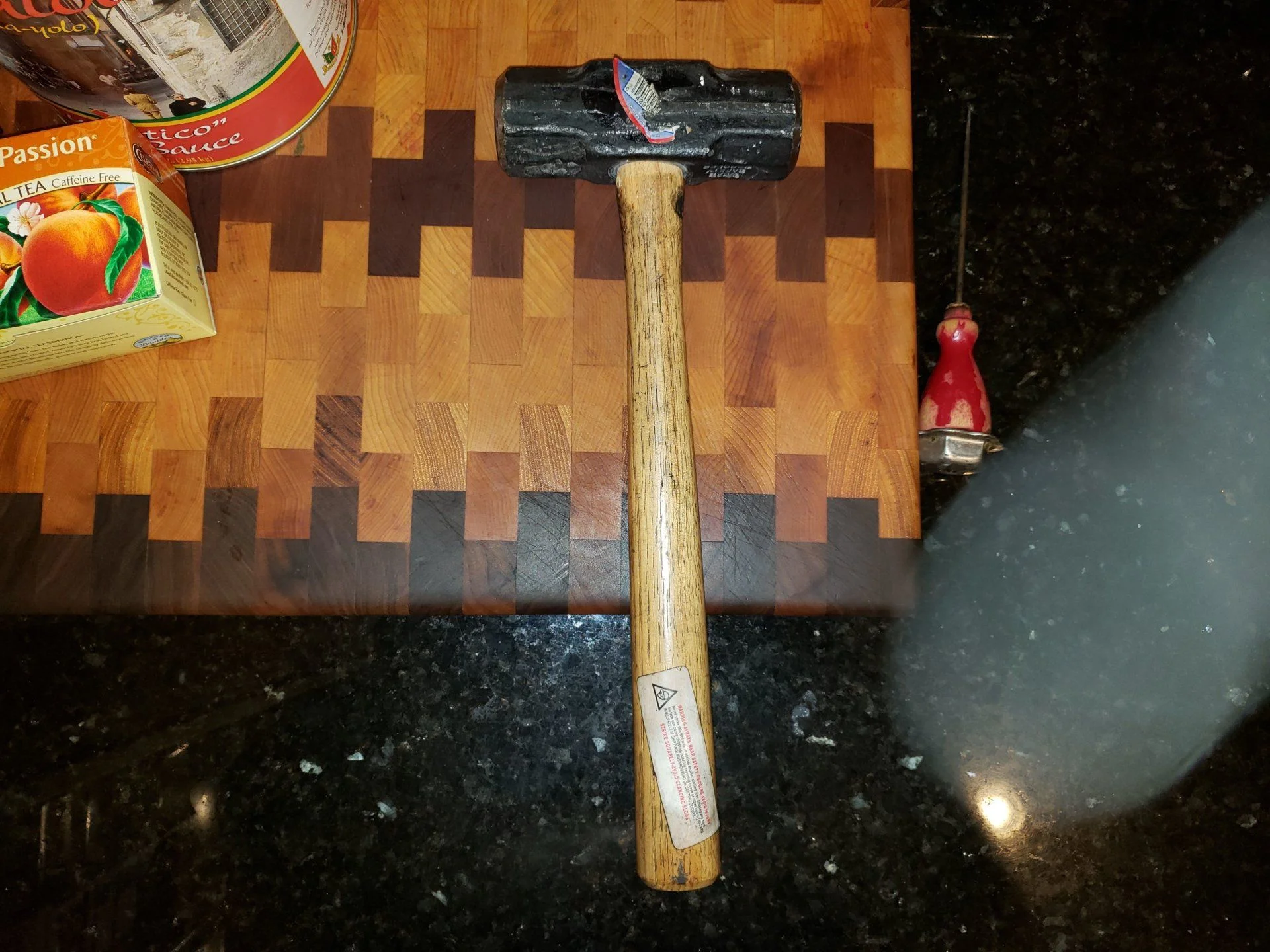

What kind of hammer are you using? It's gotta be one of these ...i've worked on many many rusted rigs and never had one stuck on me like you're describing.

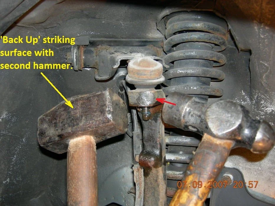

Ball joint separator (to put pressure on it) and the judicious use of 'two' hammers will usually free it up. It is VERY important to 'back up' the striking surface (opposite it) with a second hammer in order to impart enough shock to do any good. Rarely had that method fail.
Last resort (if you aren't going to re-use the ball joint) is a 'good' air hammer with pickle fork adapter. It WILL come off with that.

Here's my hammer, it weighs a pound more than yours does(yours is sexier looking though...), it was also victorious in separating the other 5 joints in the front end.
That separator was what I was hoping to work today(one like it) But it keeps wiggling it's way out. That one you show is a Harbor Freight I think. I am going to get one of those tomorrow.
Last resort (if you aren't going to re-use the ball joint) is a 'good' air hammer with pickle fork adapter. It WILL come off with that. View attachment 2249214
I've got another big hammer, I see what you are saying there.
