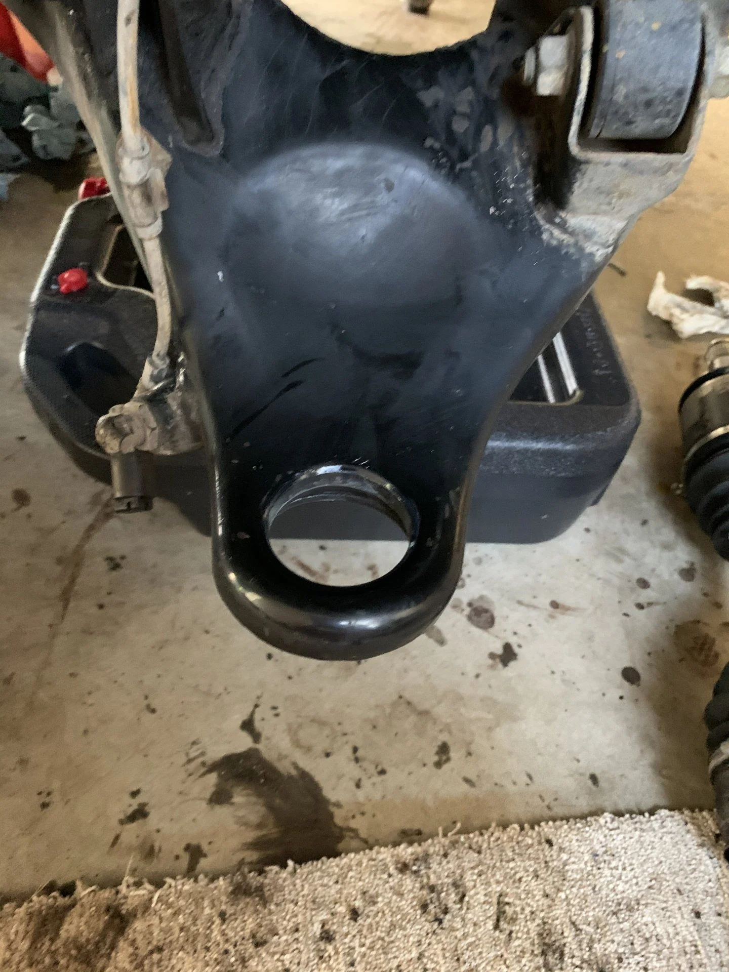

Yes, that picture illustrates the problem perfectly. The "thumb" that is on the spindle of the BJ will walk off with pressure. That looks exactly like the tool I am using.
In that case you might want a tool with a larger opening. So the pivot point is higher. Like this:
2 jaw puller and some love taps worked on both of mine. I did have to cut 1 3/4 and 1/2 inch sections of a 2 1/8th i.d. pipe to press the new ones in. It all together sucked.

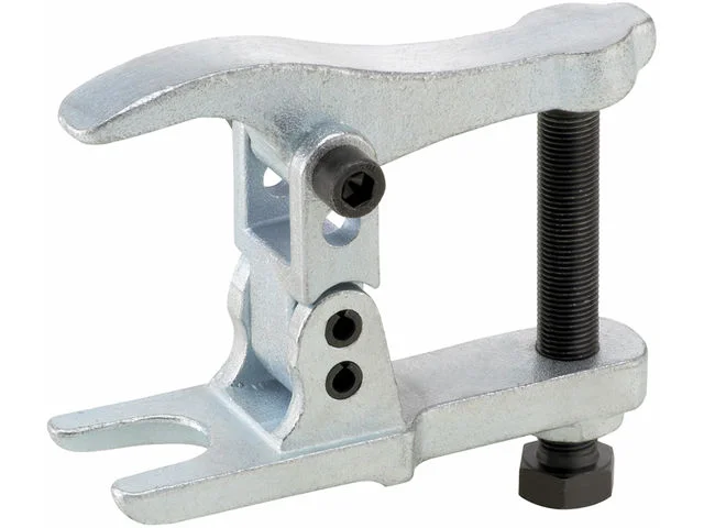

It was posted in a link above, but I think the gold standard for separating the lower ball joints is the OEMTOOL 27170. Right now I am looking at it with much affection! :)
Pushes straight which is key. Has strap bolts that keep it from flying off and also centers it. You have to remove the disc and dust shield to get it on though.
The screw feels like it is made out of good stuff. Impact banged it and it was off.

Oh yeah, nice. That looks a lot like the Toyota Special Tool prescribed in the FSM. Which costs almost $300, IIRC, so I passed on it . . .
