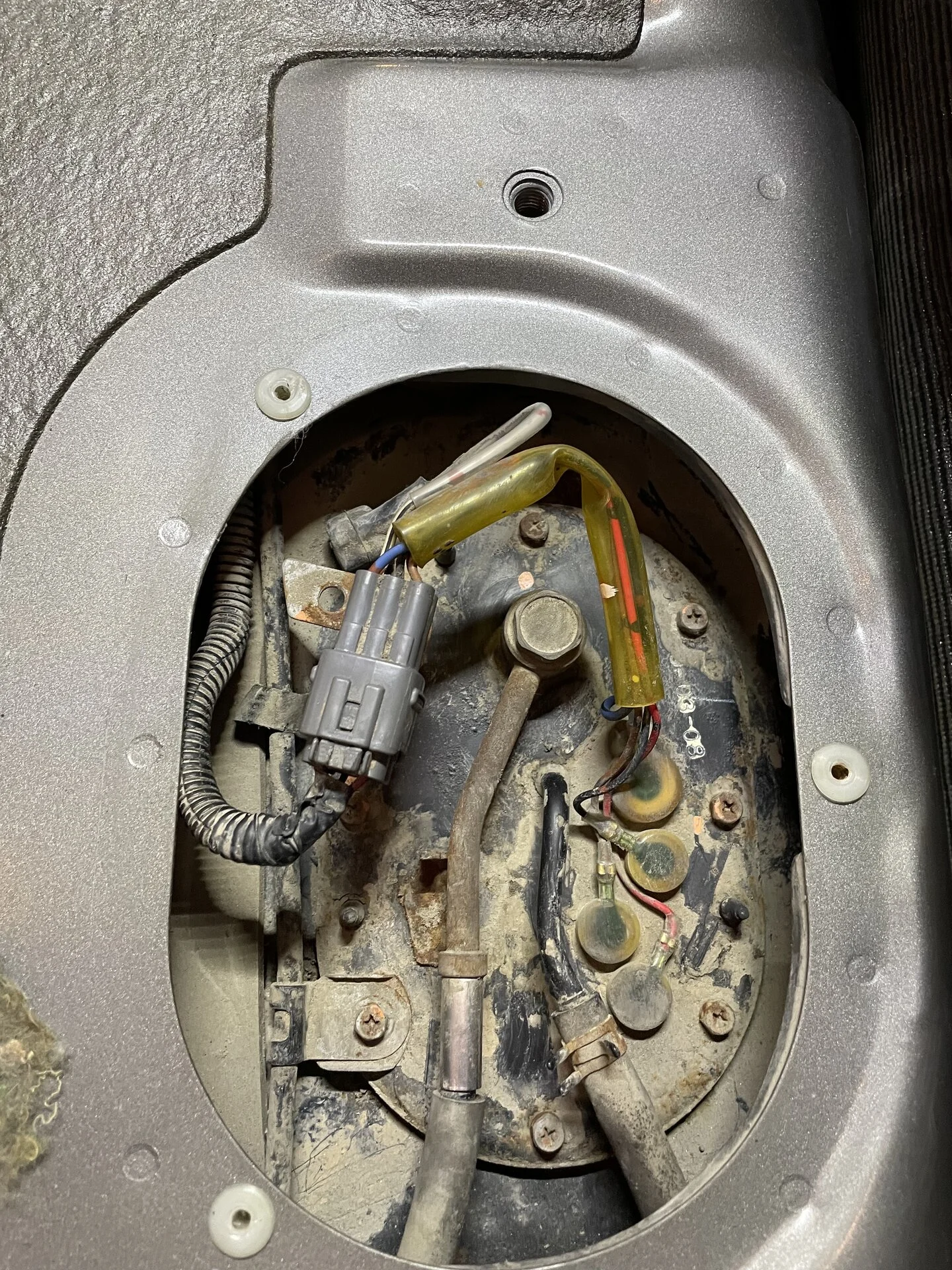

Interesting.....might have to break out my EWD and look into that....but one thing that challenges that, is that mine in intermittent. I wouldn't think that an LED light would cause that at times and then not.
Ah - mine's steady, but definitely started as soon as I put the cluster back in with LEDs in a few positions (not that one, since it needed to dim). Haven't gone back in, holding out for a better theory than just rolling all the lights back to OEM. Let us know if get a win on this one.
I did the same thing change my cluster with LEDs and low fuel light is on. Anyone have a FIX?
Thermistor on the sending unit is bad or wire is shorted.
