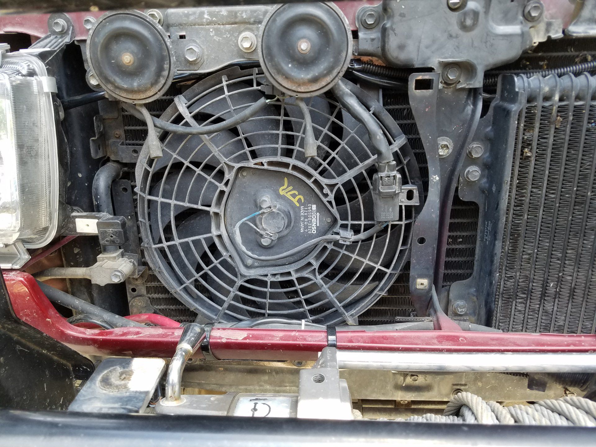

i pulled the fan and fuse/relay block from a 97 Camry I also got a spare fan from a 96 Camry and paid 24 bux for all of it.
I then made some custom mounts from aluminum and used the AC pressure switch to control when the fan activates.
Very neat setup and looks like it was a factory install!

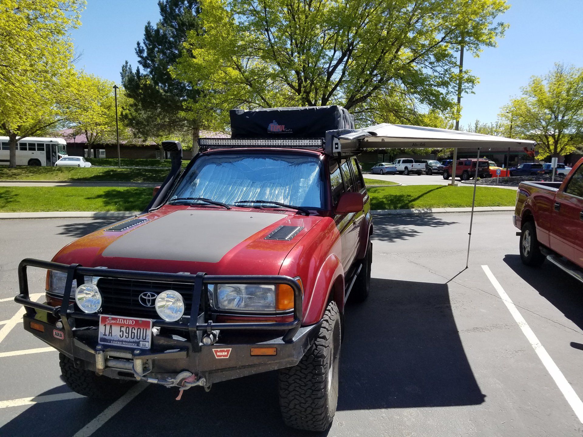

Been a couple years since I picked up the louvers from the link posted in this thread. Finally put them on:

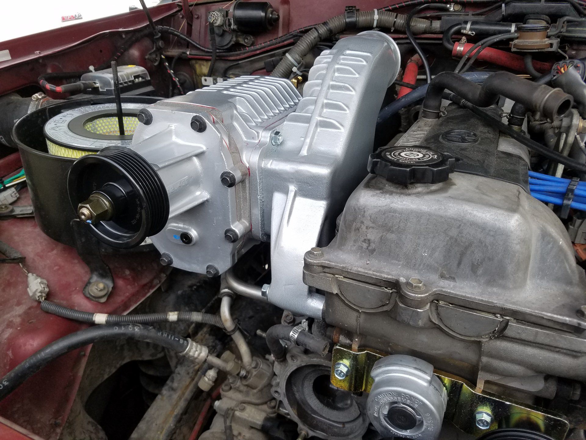

Been thinking about air flow in and out of the engine bay too. Anyone wonder if there’s pressure in the PS wheelwell with it being open(where the factory exhaust routes) ? ? Plus, the radiator shroud and fan are mostly on the right side as well . . .same with the exhaust.
Anyway, once it’s all back together I’ll be checking airflow at the vents on both sides with a Kestrel. My 80 isn’t stock at all though. I’m running an electric fan so the DS is far more open. Much easier to remove and replace the S/C belt too. Gotta seal off the PS wheelwell still after routing the exhaust inside the frame. The controller for the fan keeps it right at 195° at idle(but the hood was open). It’ll be interesting to see how it all shakes out. I considered not messing with the vents, but I’m glad they’re on finally. 😃
After looking at the paint surrounding the louvers, the left hand side (drivers) has a lot more heat coming out of it. My drivers side paint is a bit hazy behind the louver.. I would have bet the right would have been hotter being above the exhaust.

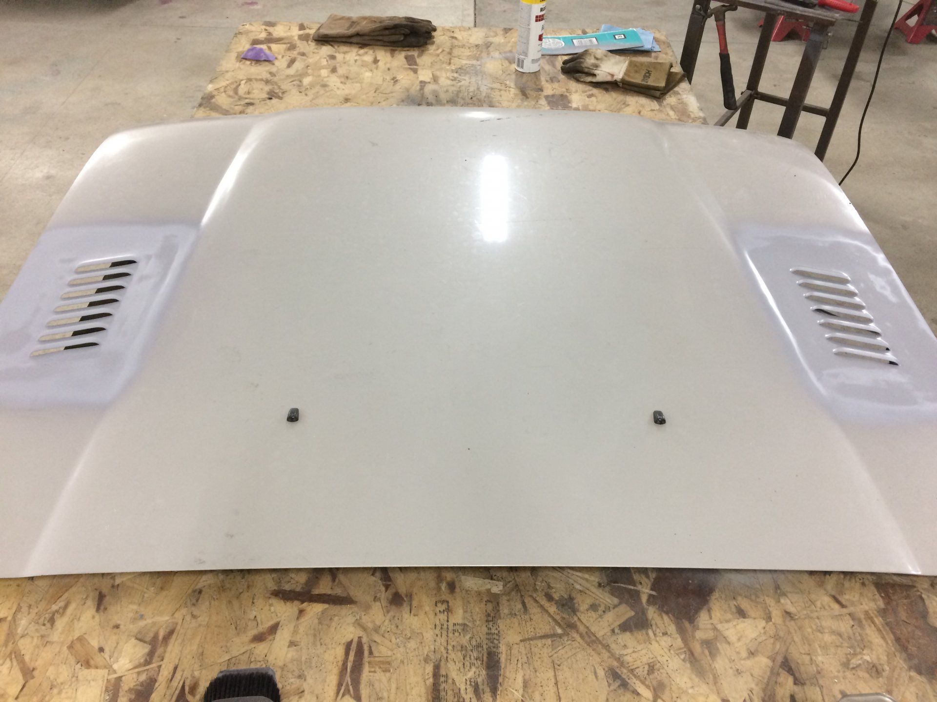

Also, do you have any pics of your install and under hood shot where the cut was made. I expect these overlap a brace or two based on the length.

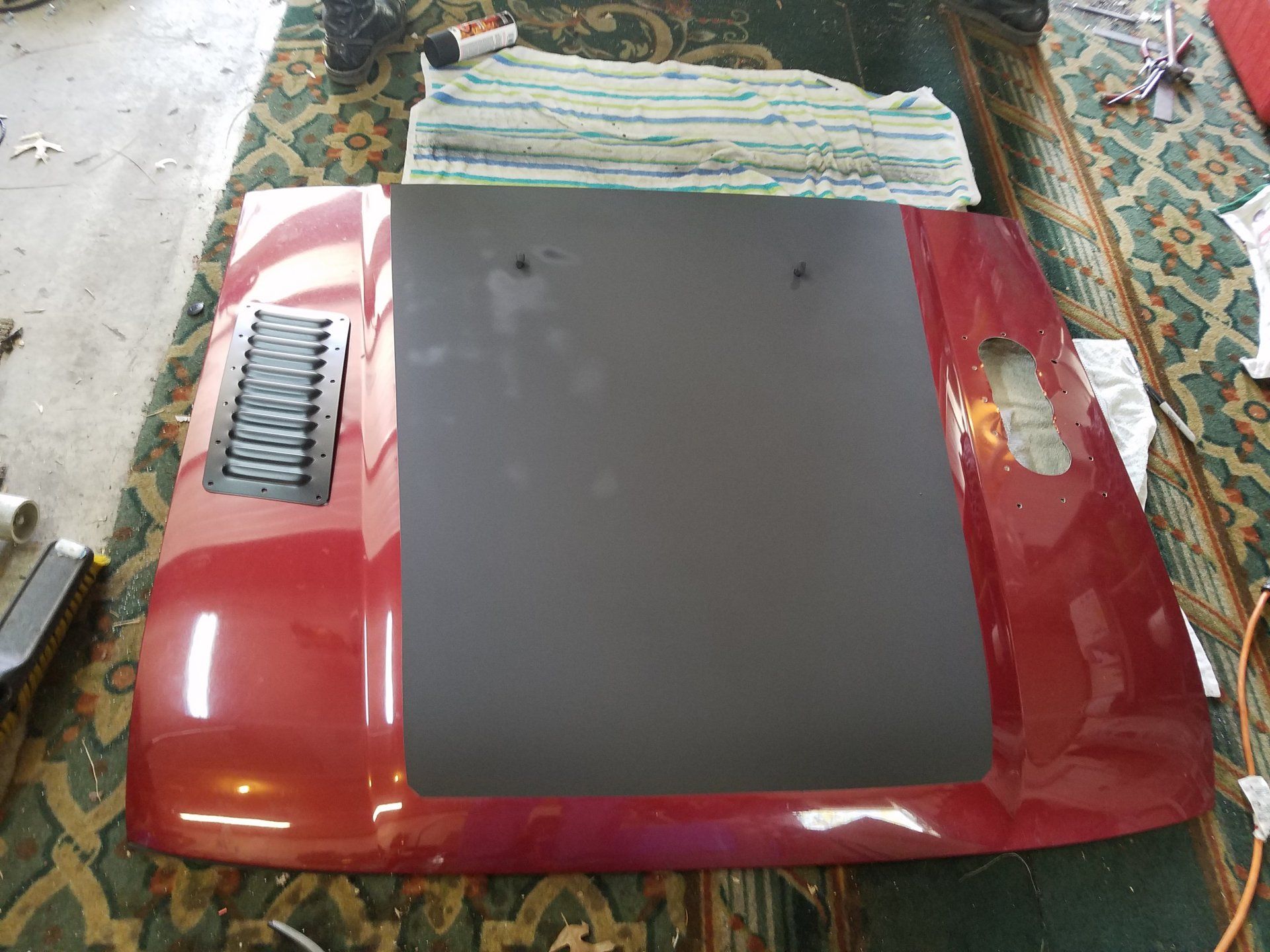

I just centered the Louvers over the section of the hood that is not braced. I used a 4" hole saw two cut three holes in the section and used a jigsaw to connect them to make one large hole. I had to drill 3/4 inch holes in the braced area to access the lock nuts on the bottom side ( I'm sure it weakened the hood supports but its an accepted risk ) , that way I don't have bolts hanging down into my engine compartment. I also trimmed the factory hood insulation for air flow. If I had to do it over again I would have used nutserts for a more professional look. be very careful using the stainless allen bolts and nuts he provides... they gall up real easy,, and seize.. don't ask how I know! Use anti-seize or tighten slowly.
