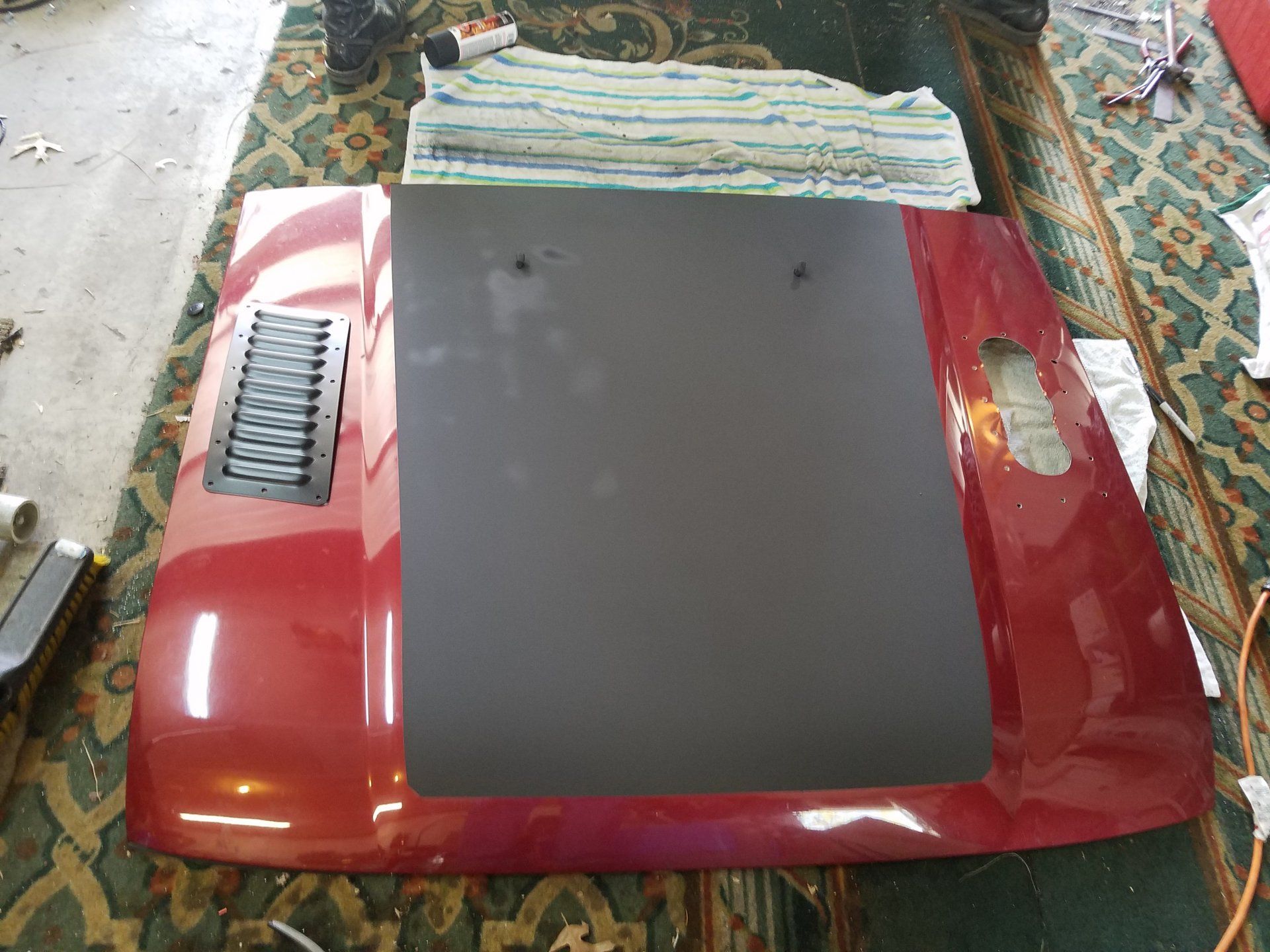

My louvers were also purchased from Rod's via Ebay. Great product! I had them powder coated before install.
Thanks for the pics. That 80 is awesome man. Looks like I will be getting a set of louvers from Rod's. BTW where did you get your electric fan?
