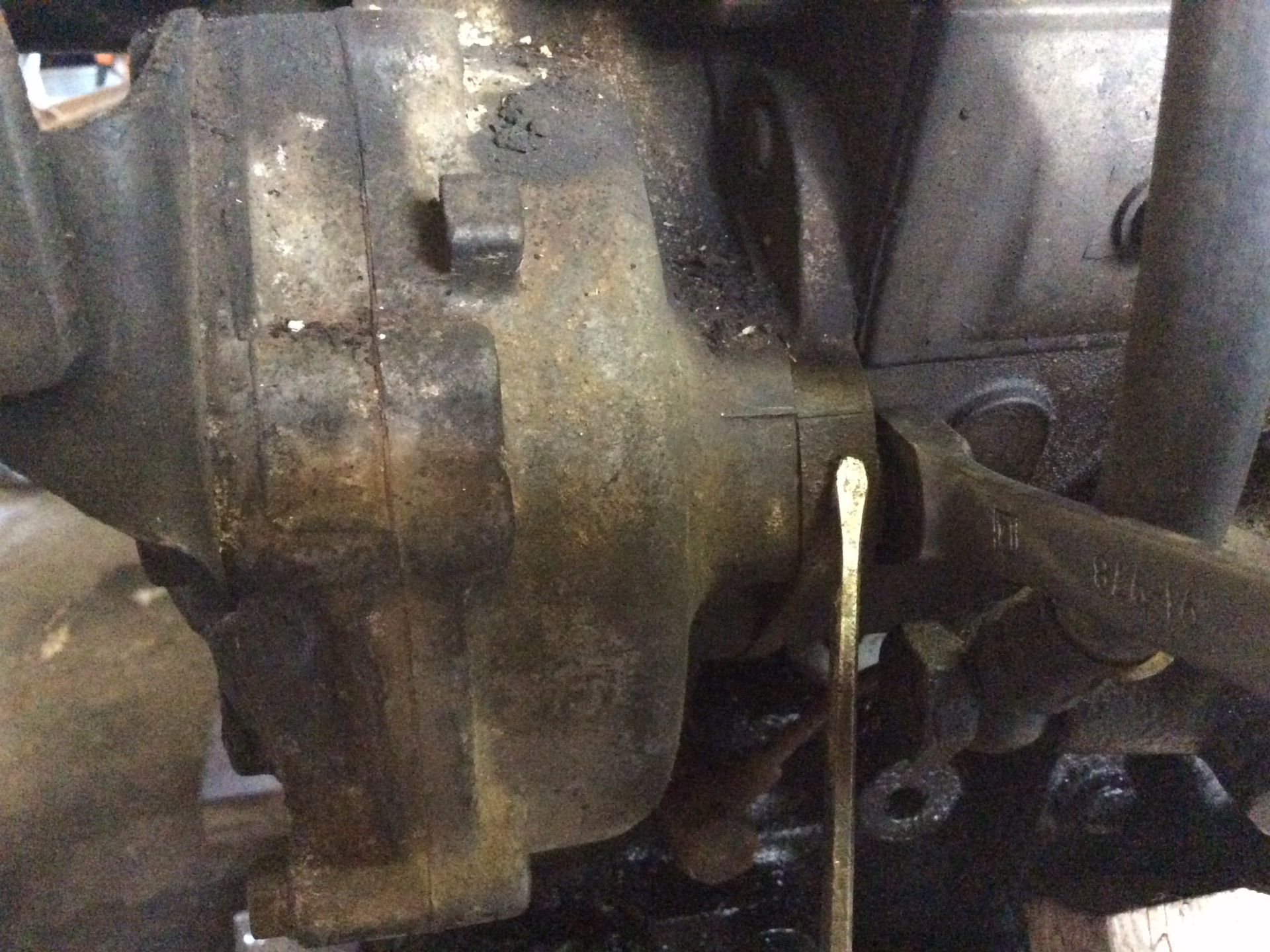

As long as the timing gears are set right
And the notch on the injection pump is lined up your timing should be close enough it wouldn’t smoke like that.
*Edit had to go way back to find this but here is how the pump timing mark should be set for a B with a turbo as per Gerg.

Thanks, yea looks like my timing looks good. One thing I just noticed now is that the old injector nozzles have the whole almost two times bigger than the new ones I have. And now that I remember, right before the overhaul I had black smoke which was excess of fuel.
