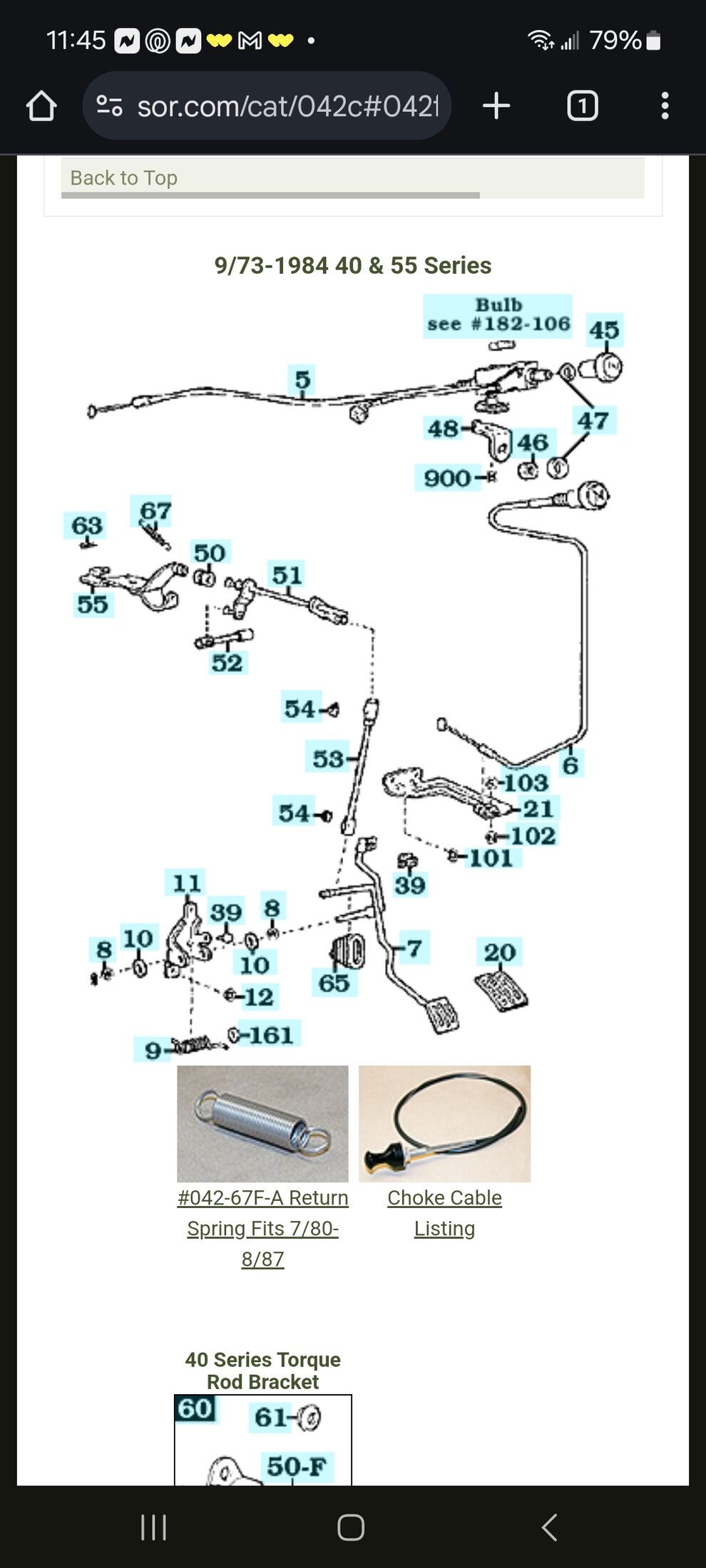

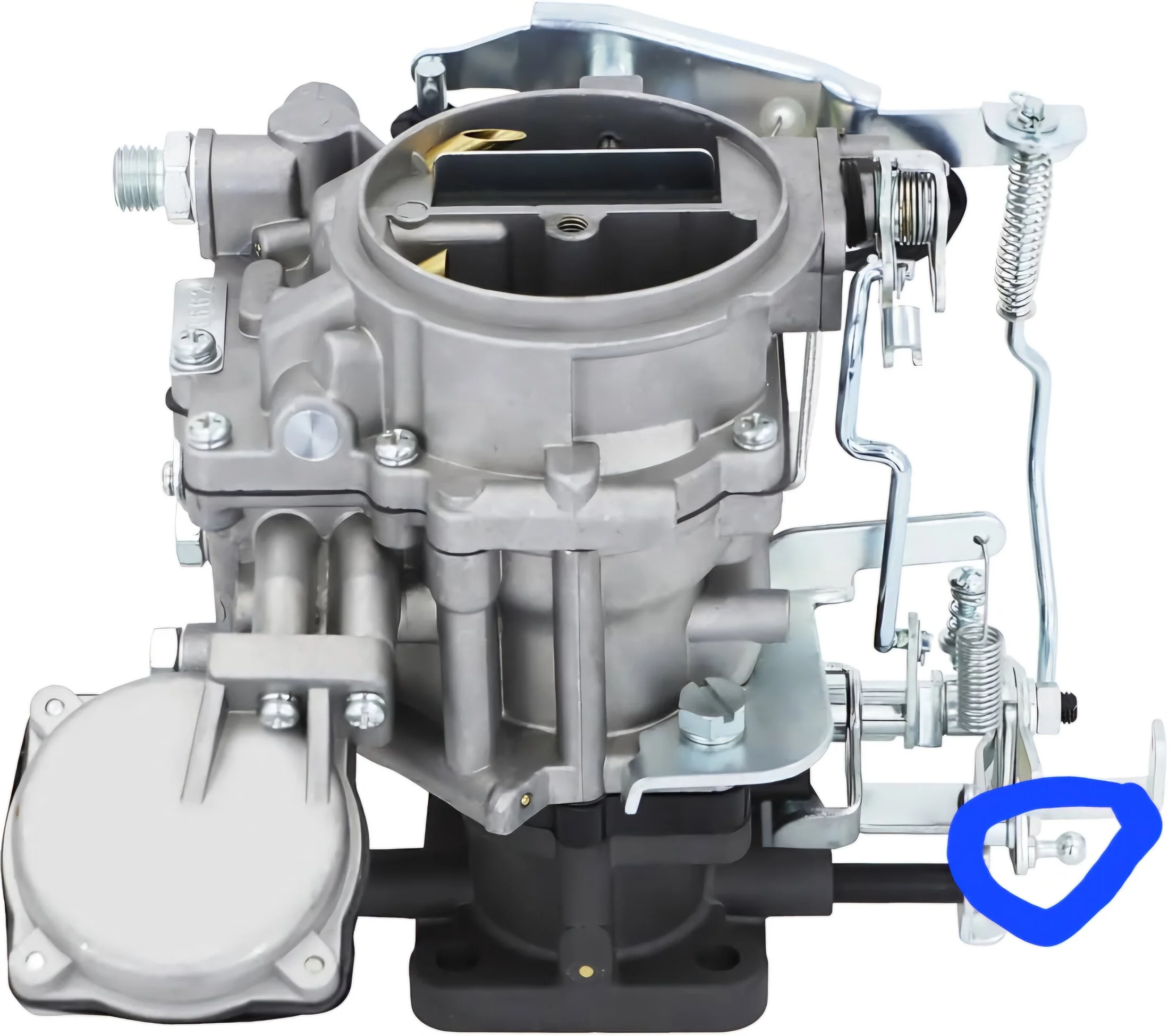

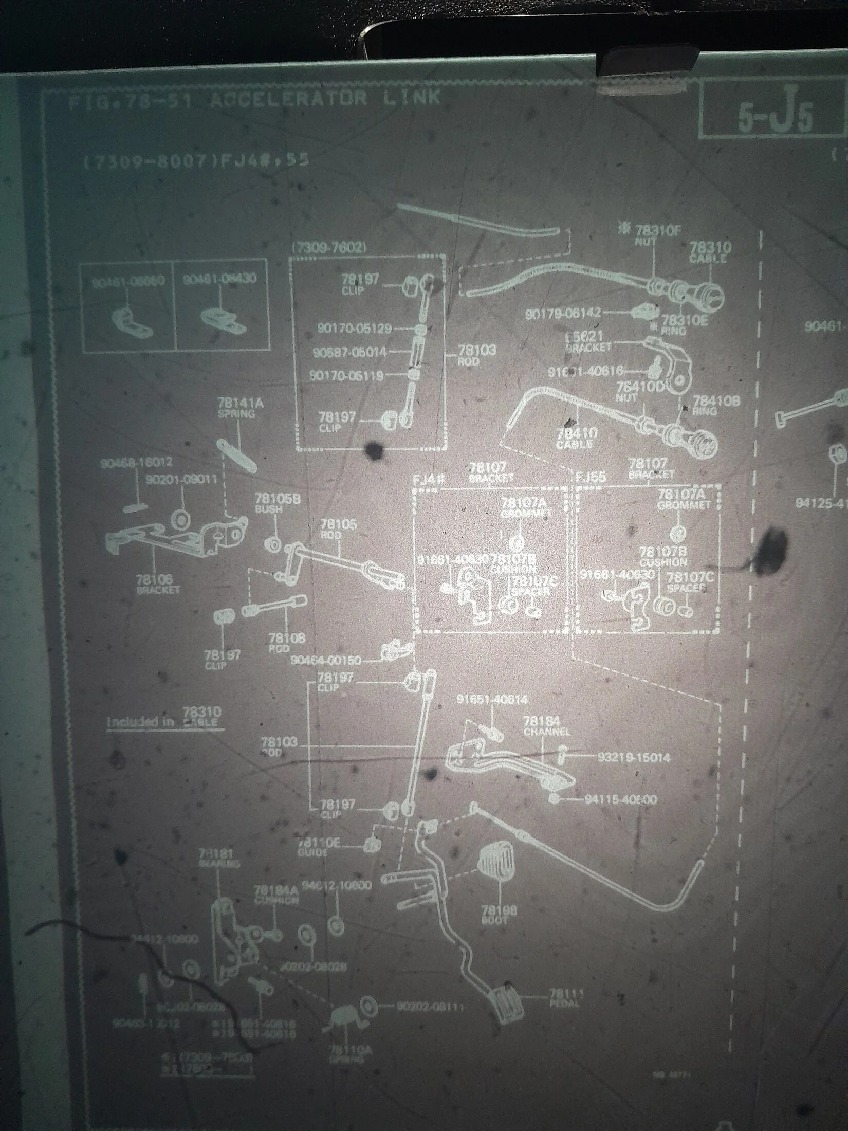

I lost the accelerator rod for my carburetor that goes where I circled on the carburetor picture. Is that part number #52 on SOR's part diagram?

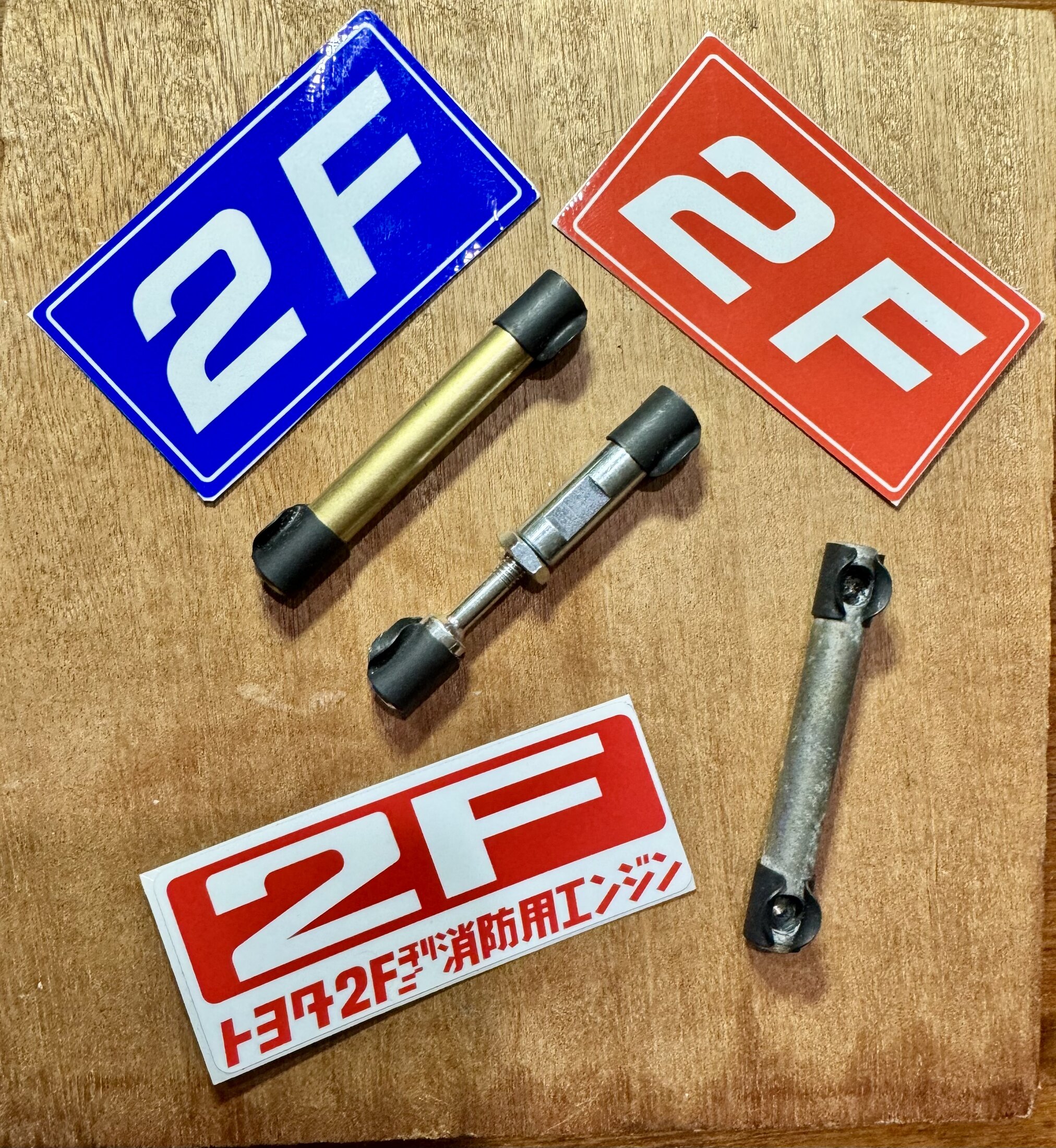

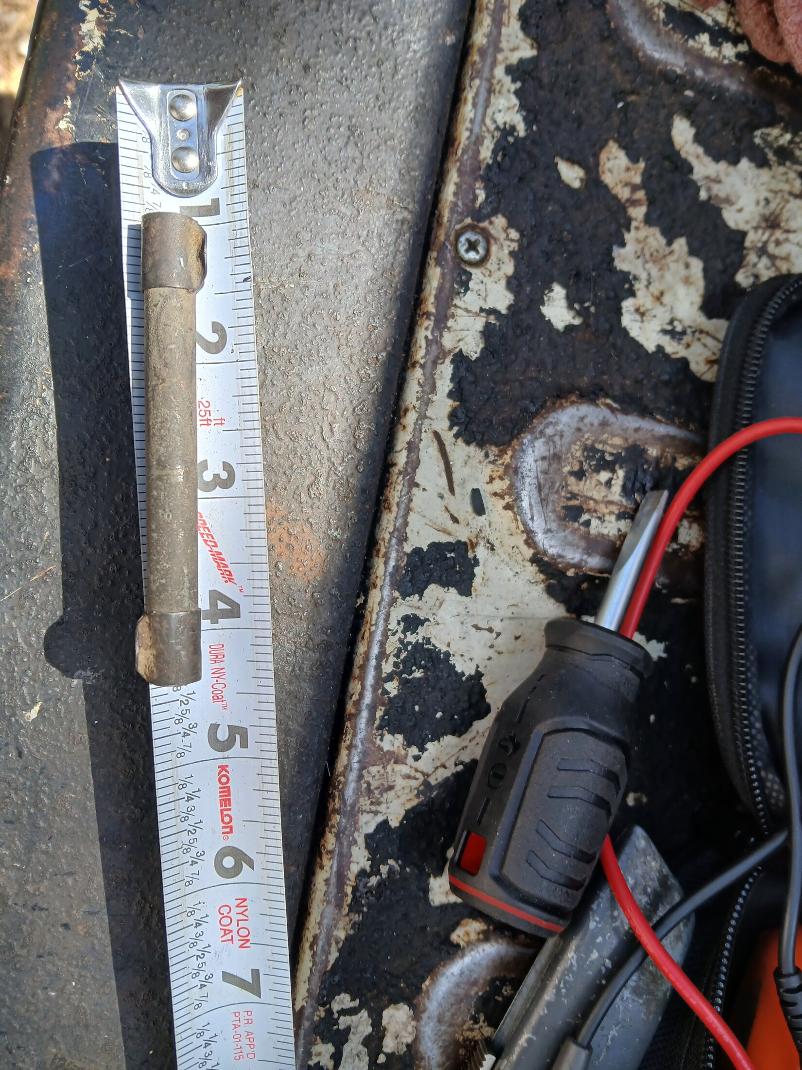

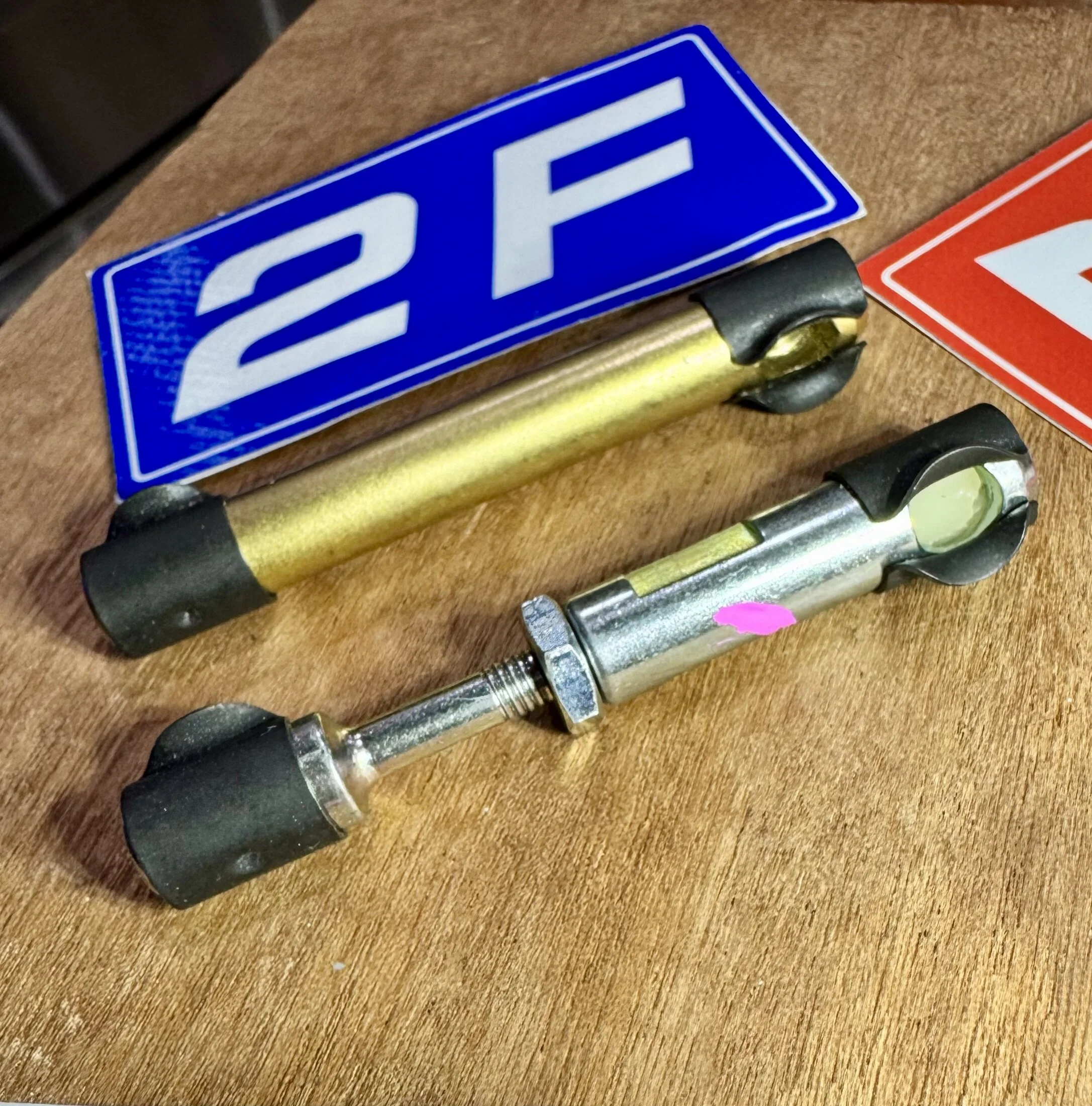

Maybe. Did it look like this?

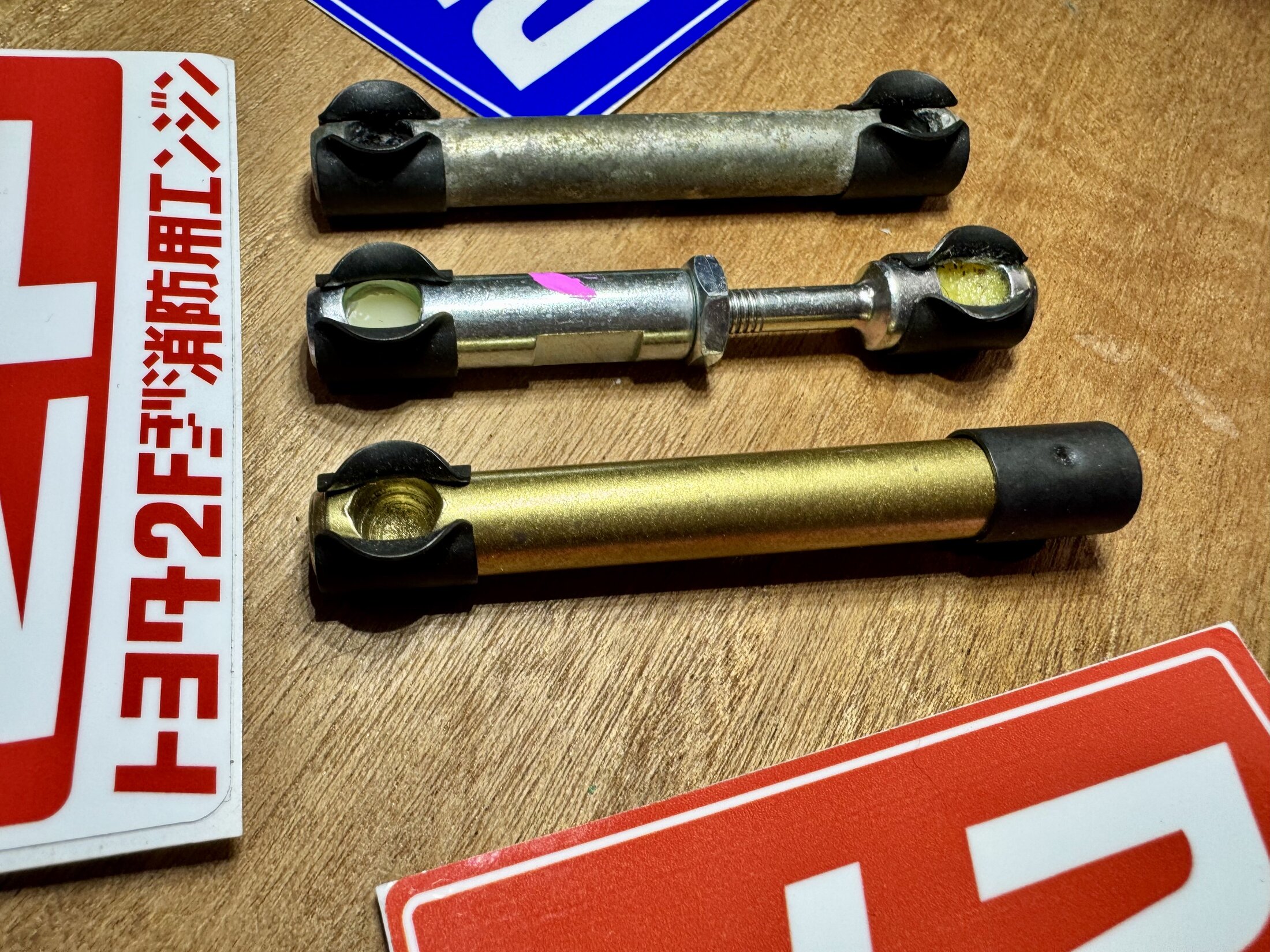

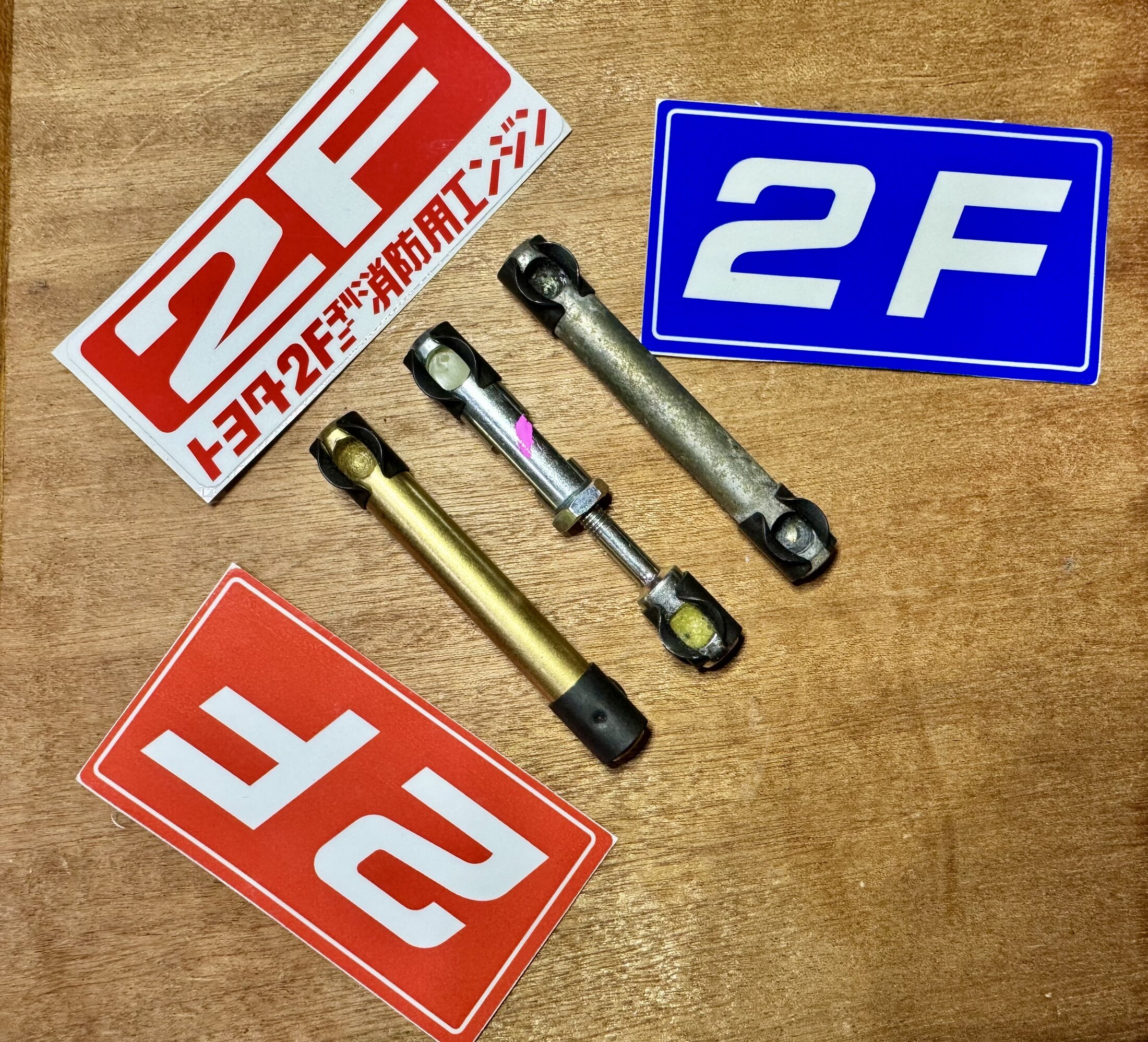

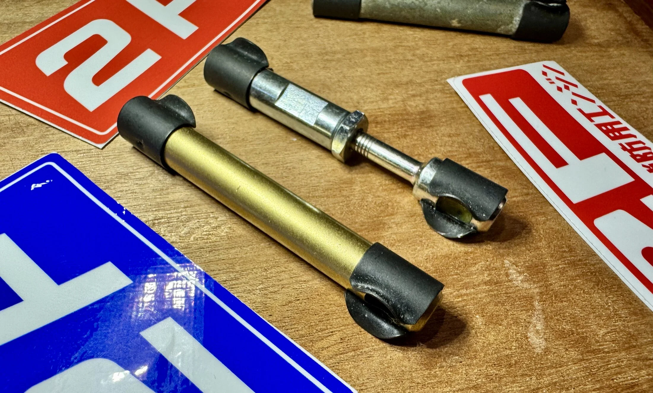

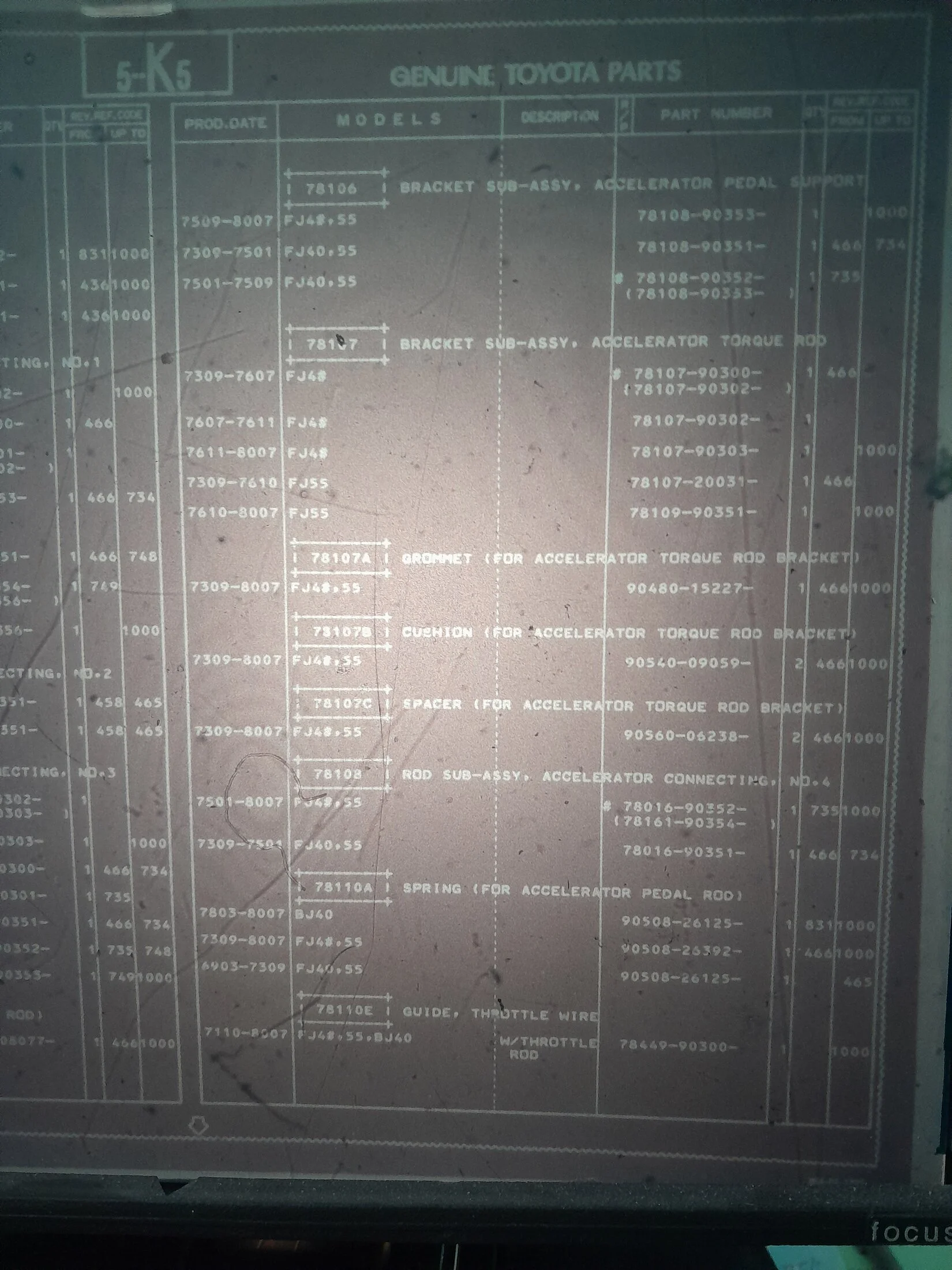

i have a fresh update and modern age 2025 one stop Call out # 78108 on the real OEM microfiche , the above is SOR.com 's ....fyi
my fully adjustable 360' degree #781108 covers
1/75-9/87 2F FJ40 FJ55 FJ60 FJ45 etc .
it also will un-wind and telescope out to the 73-74 F1.5 correct length female socket ball CTR to Female socket ball ctr
i have been plugging away at this for a few years now , it is comprised of 100% japan spec. parts , as always .....
there are some 3F carb applications i have not quite mapper out yet
- i need to pipe dream up the fitting part # ?
- maybe
78016-73F87 🤔
