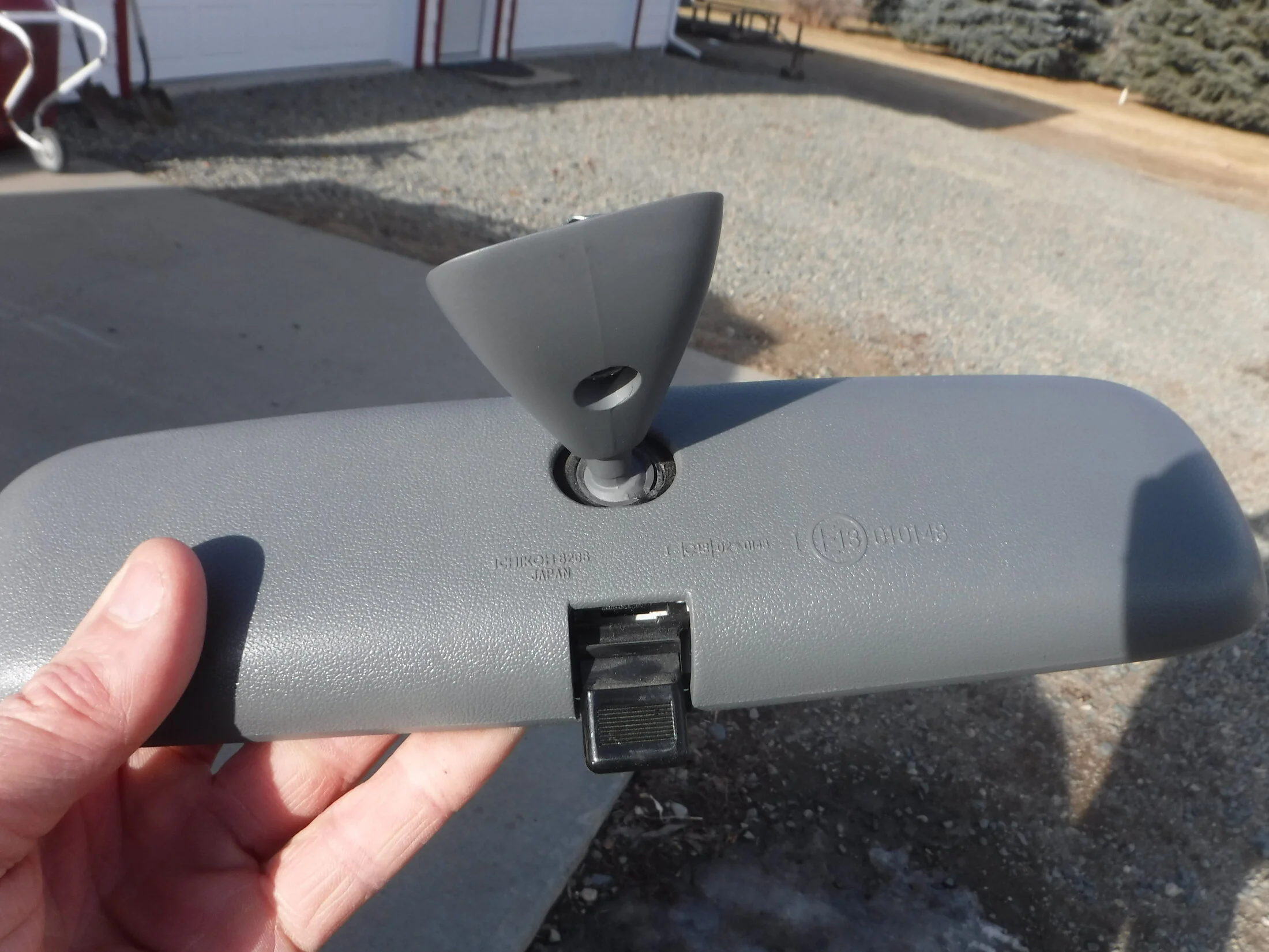

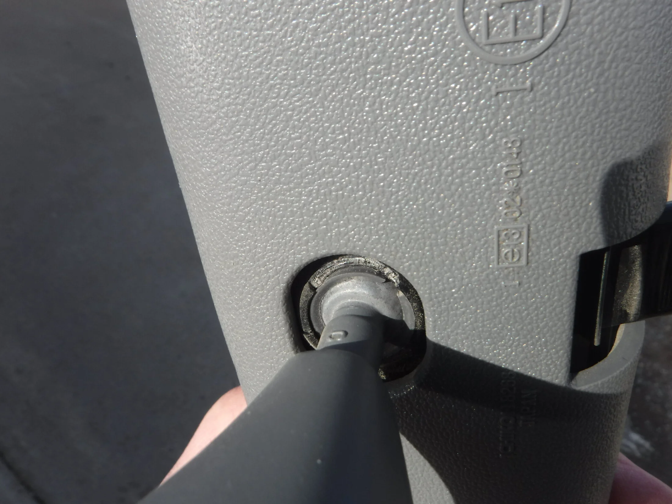

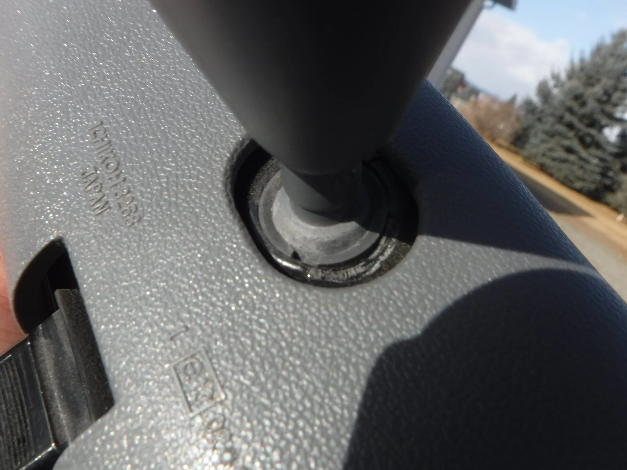

maybe I'm missing it but I don't see how to tighten the socket and ball connection
looks like the plastic pieces of the socket are broke missing thus not being tight to hold the ball
is the only option to replace?
Yeah, looks busted. If looseness in ball, replacement may be only option.
Most times, it's the two little micro philips JIS screws, you can see now with mirror & arm removed.
If it shaking at the ball you need to replace it. If it is shaking at the windshield you can tighten up the screws that mount to the plate on the windshield. It is not like the old ones with the little phillips screw that you could tighten to adjust the adjust-ability.
