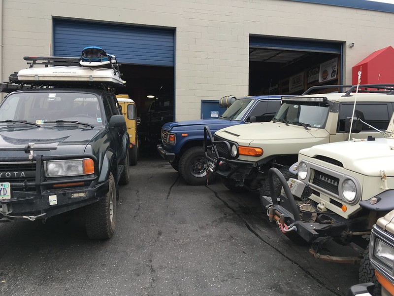

Just wanted to give a shout out and big thank you to @torfab for helping me out and having a good used hub in stock! :cheers:Super nice guys and it was a real treat to step foot in that shop. Amazing, and so many awesome cruisers! Just test fitting the wheel studs I can tell they are going to fit much tighter. Time to paint it and reassemble! Also, big thank you to @beno for the chat and the idea to contact Tor. It hadn't crossed my mind and I didn't realize how close they were to my work (15min) :slap:
