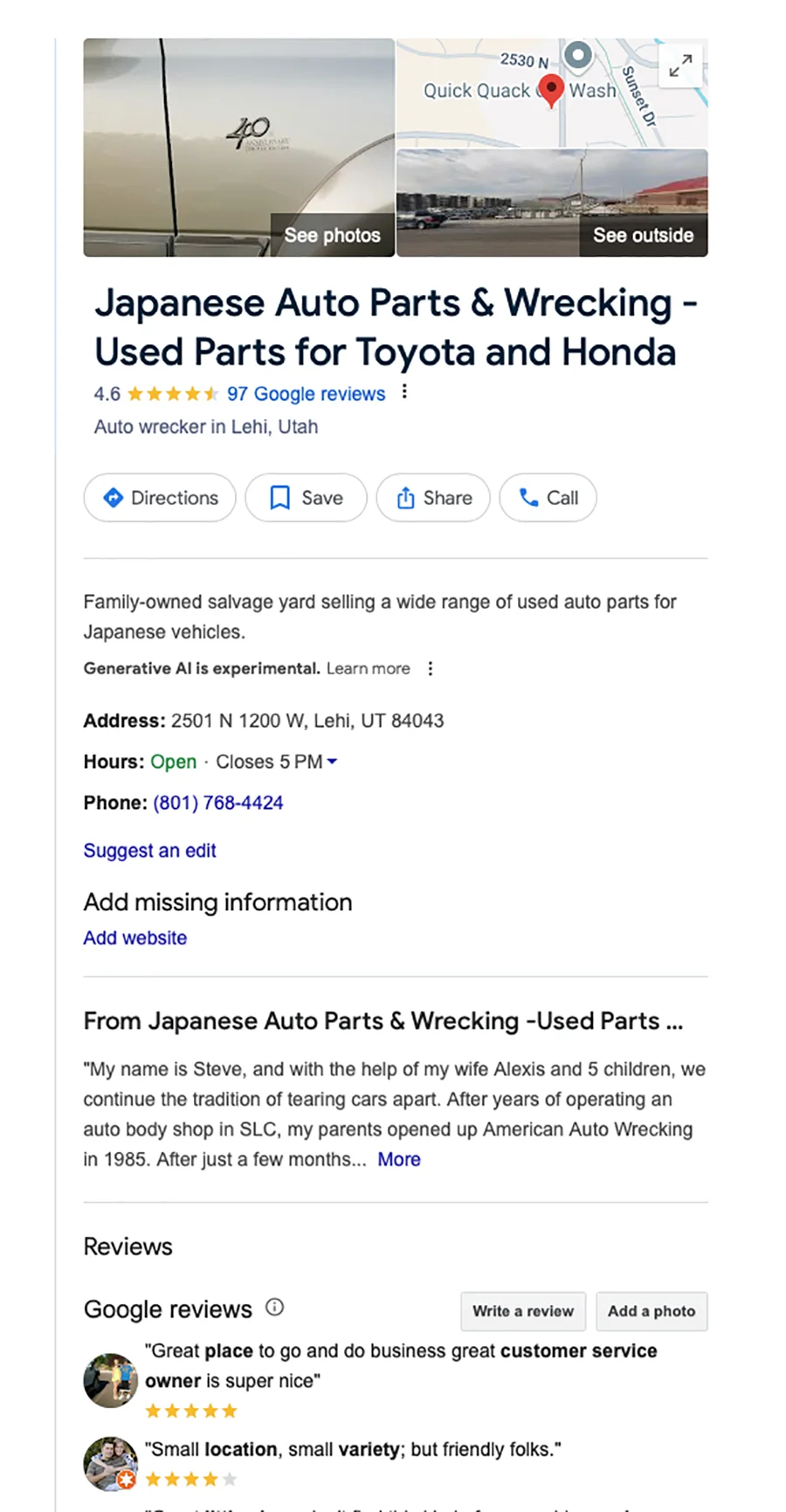

This guy, his name is Steve. He Parts-Out many 100's (So used, not new)
He has a thread in Parting Out Classifieds but it's better to contact him directly.
No website.
