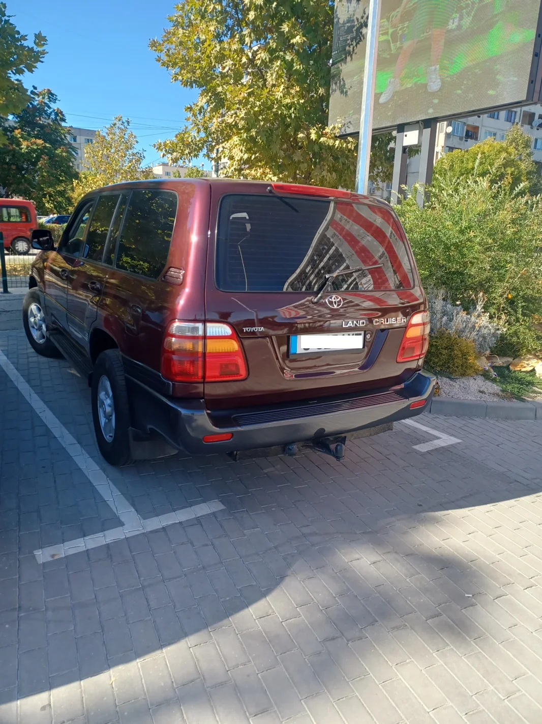

I am looking at a 2000 LC100 4.2 turbo diesel.
the car look in good shape cosmetically and looks like it has no rust.
the seller writes "Serviced thoroughly. Oil (Toyota 5W30) + all filters, belts, and rollers have been replaced. Front calipers and all brake pads have been changed. Documents are in order. Genuine mileage. First owner. Brand new Toyo MT tires (285/75/16). Driven daily. No rust.".
the seller also told me the car has the original air suspension
the car has nearly 400,000 km (245,000 miles).
what are things I can ask additionally the seller before I go see it in person? and what should I check at the spot? the car is 900km from where I live so if I go there i will buy it unless something is very wrong with it
by the way I live in Europe, and this car is from south Europe which is nice and explain the rust-free state of it.

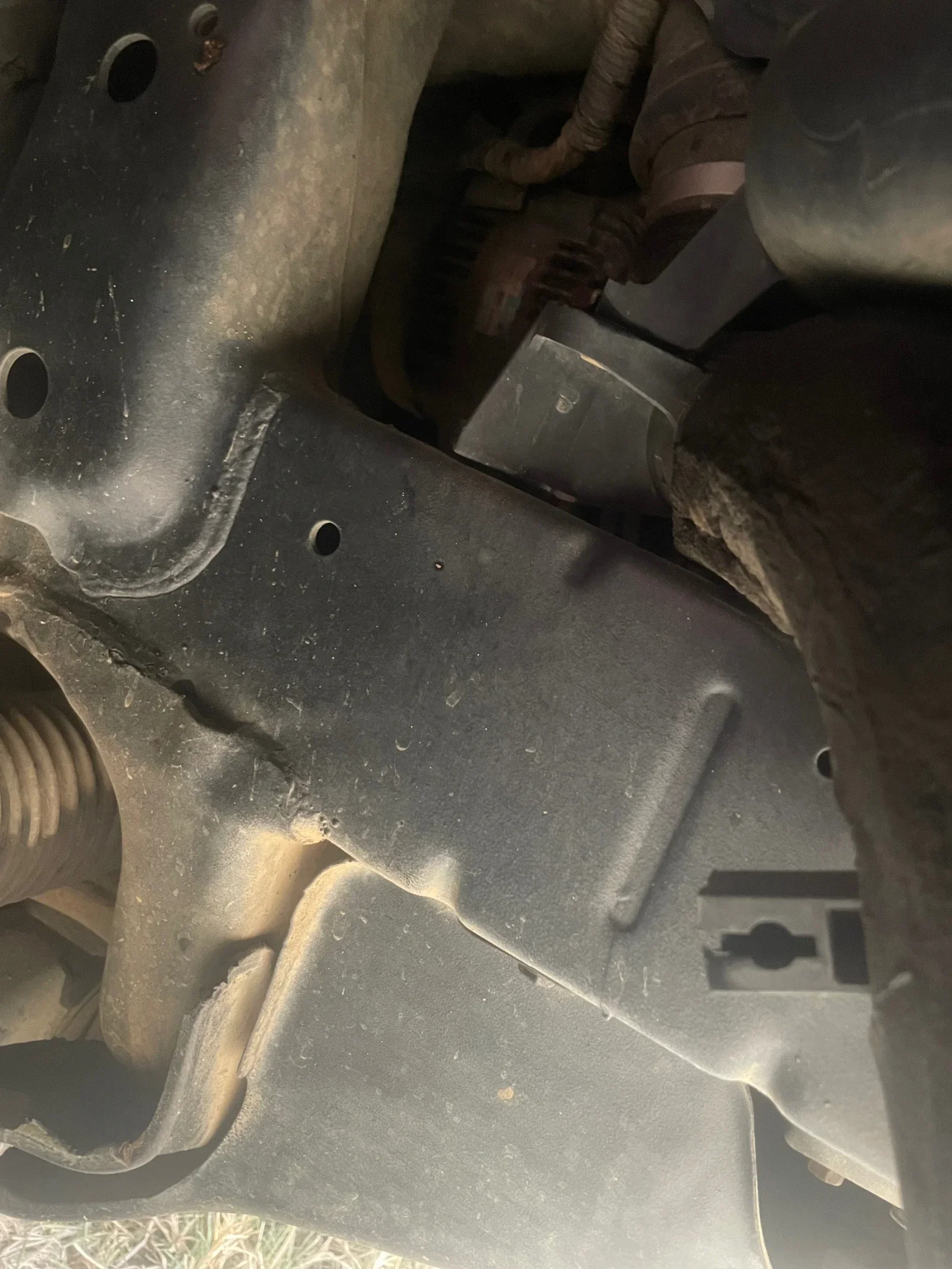

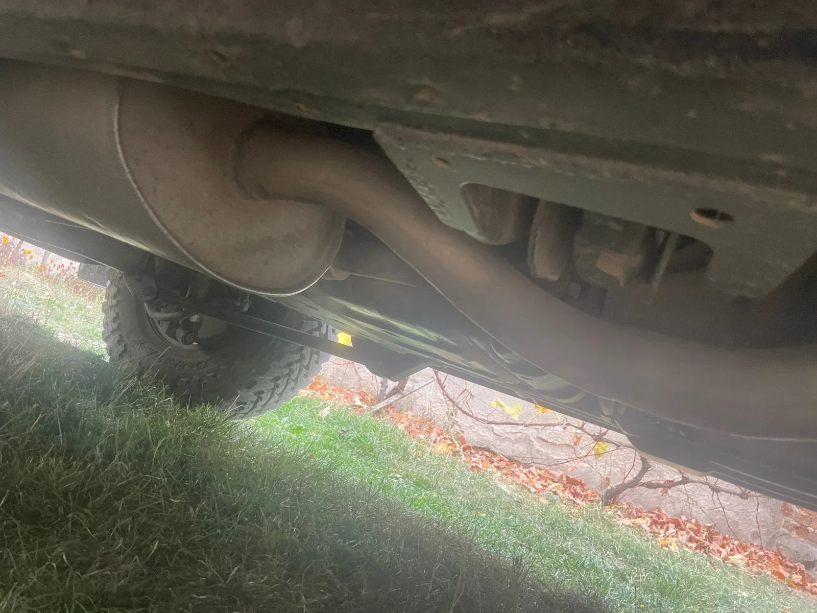

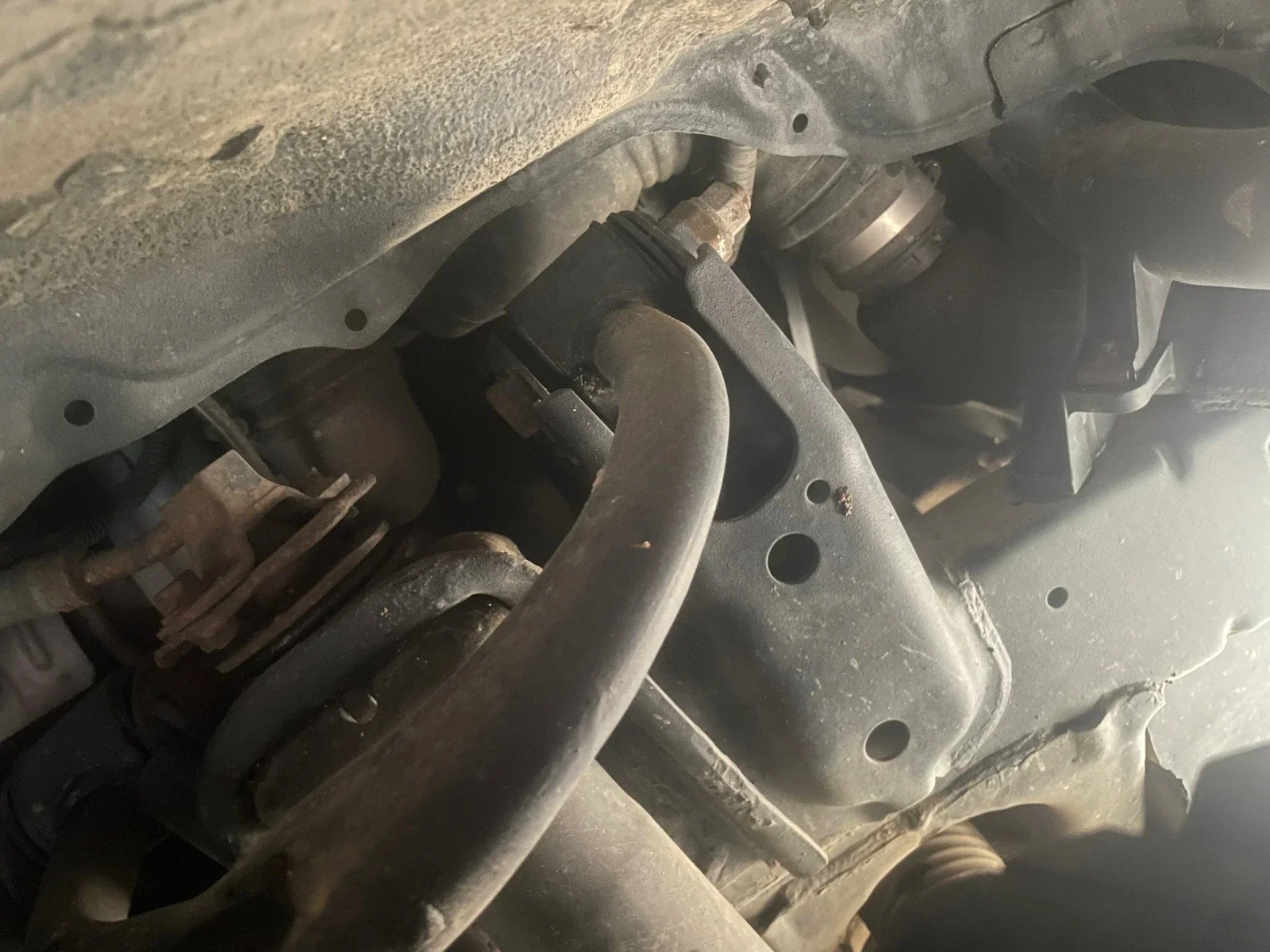

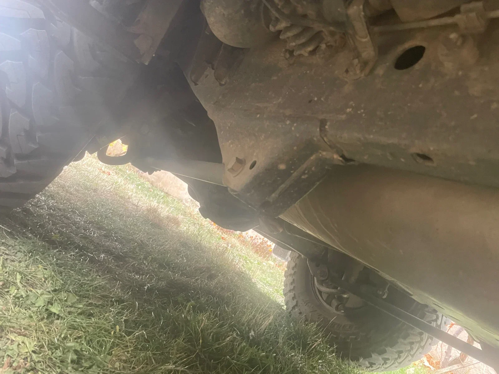

here are some pictures:
the guy wants 16,200 euro for it, and he said we can negotiate price within reason, I think the price might be a bit high considering the miles the car drove but on the other hand it is rust free and looks in good condition.
any advice would be appreciated. Thank you :)

Check the the front and back of the rear arches, but from the looks of things rust shouldn't be an issue.

- bushes, there are so many bushes on these things and after 20 years or so on the road they are often needing changing if they've not been replaced (they all add up quickly!)
- Leaking steering rack and bushes shot
- Worn out CV axles
- Radiator top discoloured and aged (so ready to pop!)
- Upper and Low control arm bushes (front and rear) plus balljoints were shot
- Front wheel bearings shot
- Rear 3rd light leaking, so rear cargo area carpets were wet
- Front diff bushings shot (can cause a clunk when coming back onto accelerator after taking foot off/clunk when shifting between P, R and D etc)
