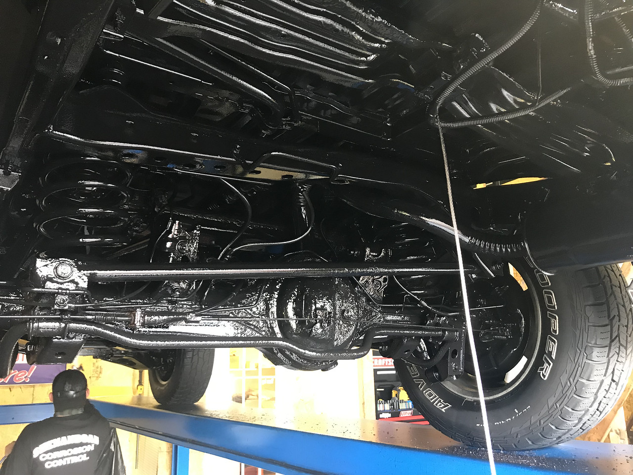

Not really local. But want to give a thumbs up to the boys at Shenandoah Corrosion Control for doing a fantastic job of coating the undercarriage of my LX470 today. They were very thorough with the prep work including hitting some of the rusted areas with a needle scaler, blowing off all the dust underneath, and spraying it with a salt cutting solution. Then they also blew out all the dirt and crud from inside the frame and very thoroughly sprayed the inside followed by a thick coating of all the other areas. Looks good and hopefully it will last 4-5 years as they say.

After Coating
Mind me asking how much this cost? I am not sure I need it, any advice is appreciated. I am also in Herndon...
You don't want undercoating or any of the "thick" coatings. All they do is trap moisture and promote rust. You want something like woolwax or fluid film that seals but doesn't build up. The thick stuff gets pockets between it and the substrate. You'll have rust form behind it and not know until it's too late. When I did collision repair in Boston the worst of the rusty vehicles were the ones that had been undercoated. The vehicles with nothing were better off. We've got several customers using fluid film and wool wax on their trucks and their frames look pristine.
I agree with this. The product used on my LX is Woolvax Lanolin based.
I paid $450
Give it a couple months to dry out a bit and collect dirt and dust. It never solidifies but it does get to sort of a soft wax consistency. You definitely don't want to spray it down if you know you'll be working under it in the near term.
