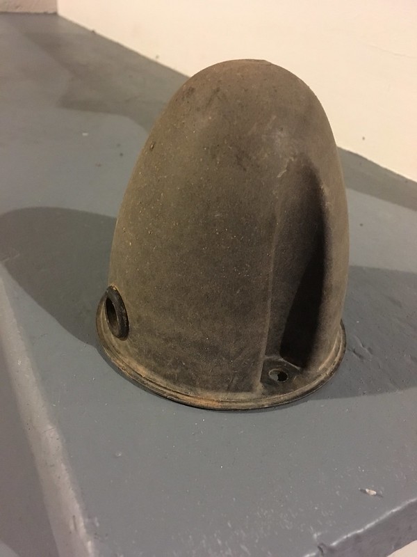

Got the pristine cone off my 65 fj40 and I’ll be bringing it back with me to Seattle for scanning. Only has one exit hole by the way.
Safely at home. Should get access to a scanner in early January.

I will get an orientation at the maker space on Tuesday. After that I’ll let you know when I’ll have access to a scanner. I can share the file so people can print it wherever they want. I may try and print with Nylon.
