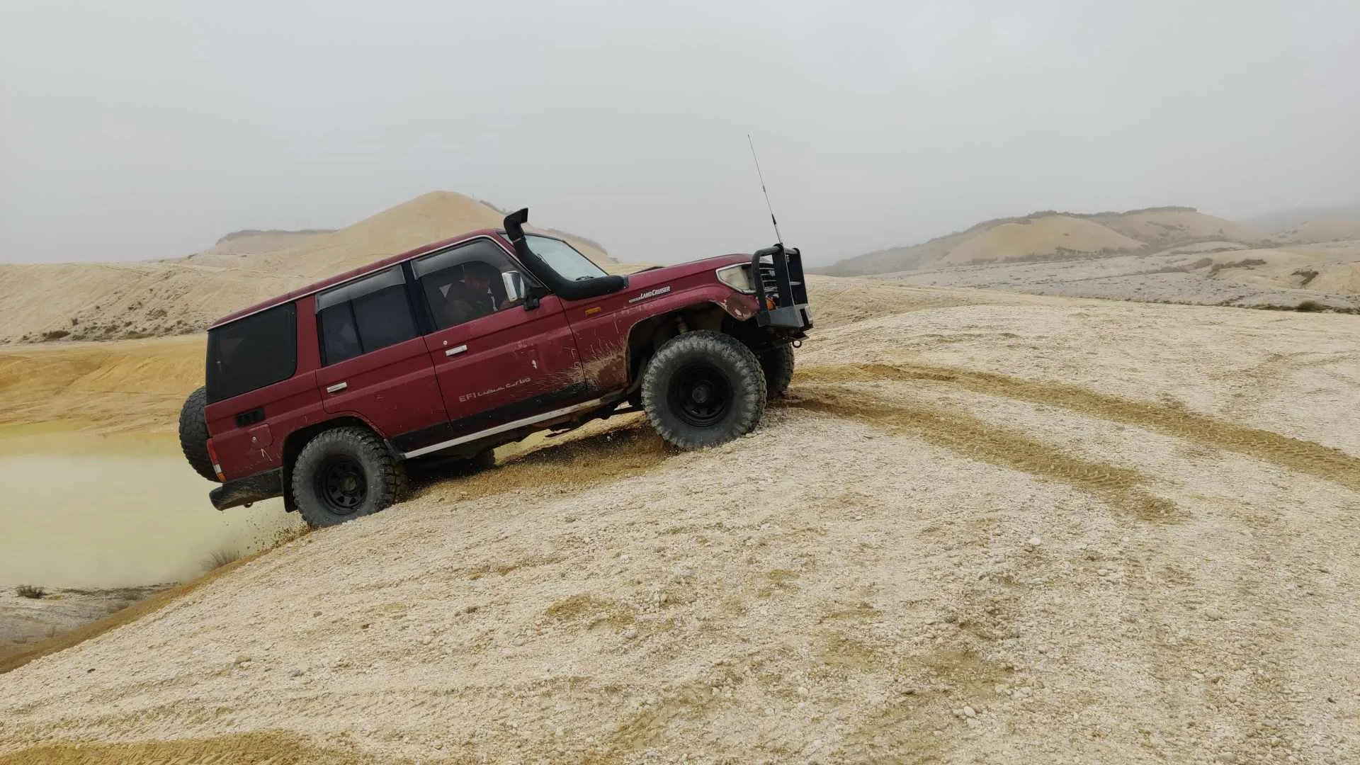

yes that is her in the photo, out and about in the old gold workings.
She has the old 2l-TE and factory back locker, factory AC and Factory winch.
