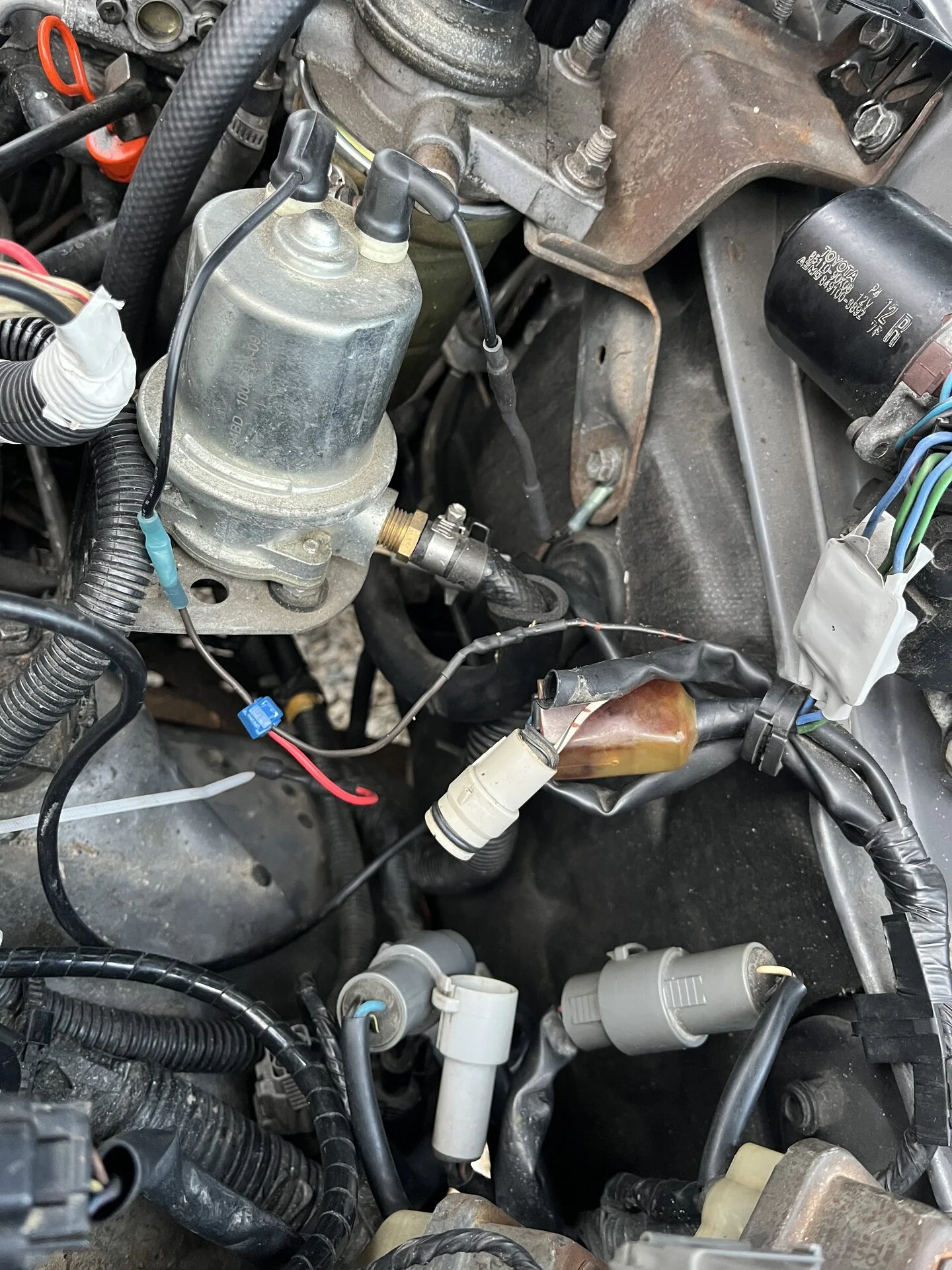

The bus bar was installed correctly. No grounding out to the motor. Tested the Busbar with a multimeter with the Wilson switch engage. I was getting 12 V to the glow plugs. Attached is a picture of a plug that was disconnected when I purchased the vehicle. I believe it’s for the glow plug timer. I plugged this plug in and tried to start it with the Wilson switch and watch my voltage gauge go from 14v to 0 . I then proceeded to pull the glow plugs to find out that the person I ordered from on eBay sent 19 V glow plugs instead of 11 V.
