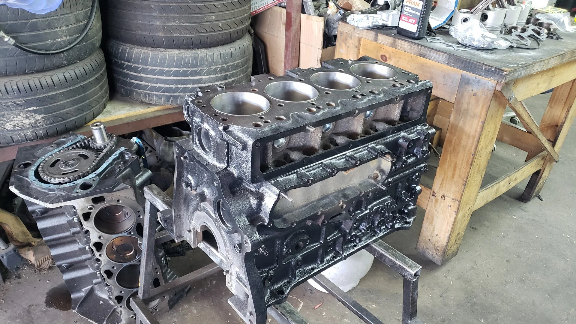

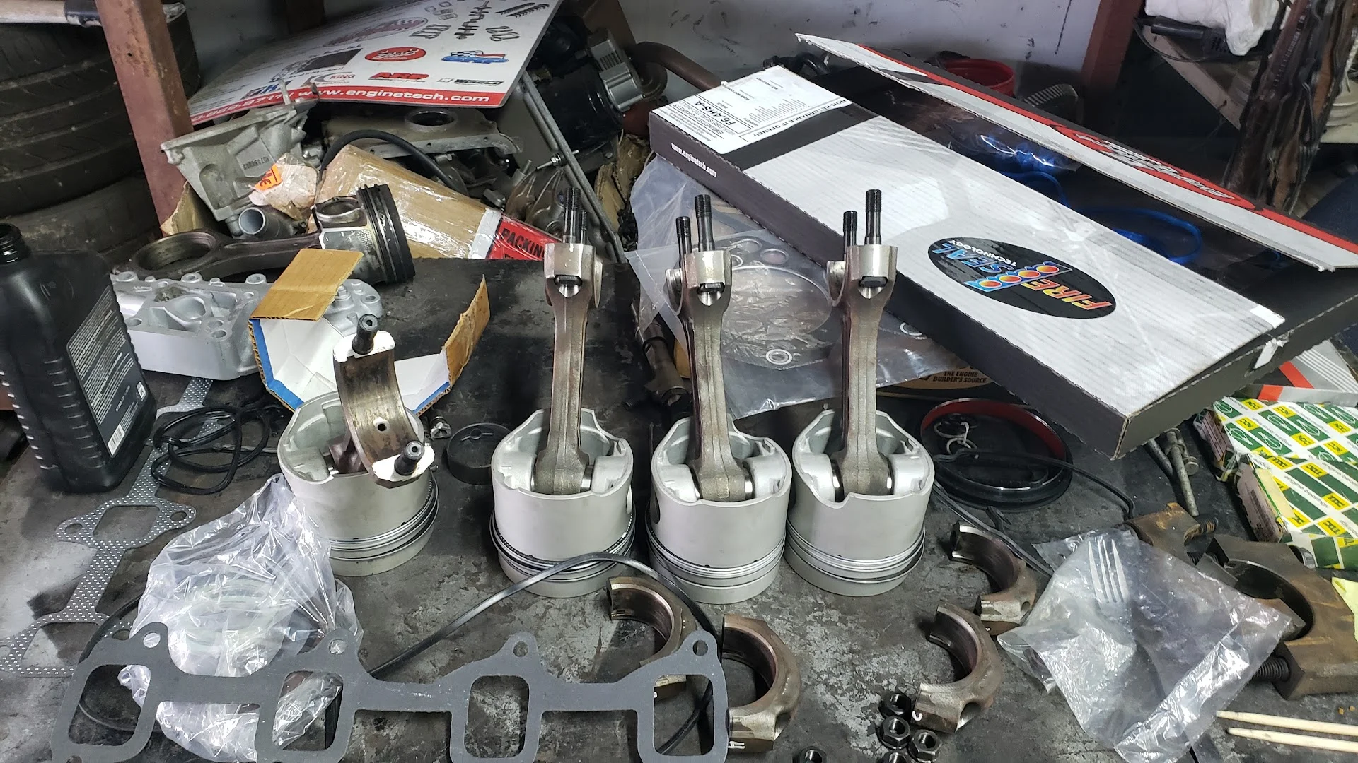

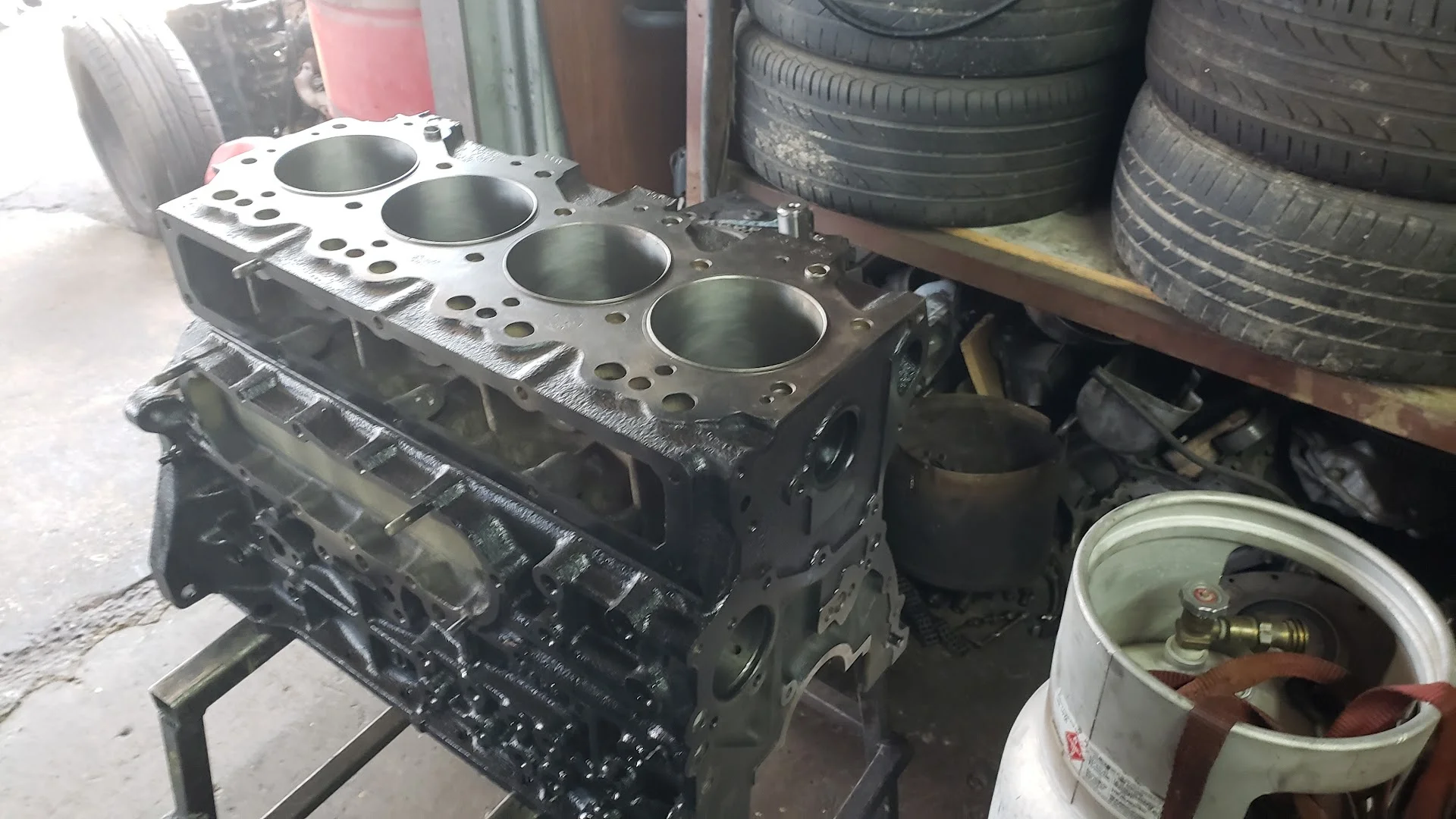

Sorry all, this truck has been breaking my heart so regularly I find it hard to get on ih8mud and read about all the awesome s*** everyone else is doing much less dredge through all my own bs...anyway, I Ultimiately decided, based on your advice to rebuild the 13-bt. So made a spreadsheet of rebuild shops in the dallas-fort worth area and called them one by one. Based on their ability steadily answer the phone, the presence of a central-american mechanic on staff who was familiar with toyota diesels, and a short tour of the shop, I decided on engine-rebuilders llc.
They had a two-month waiting list, and initially gave me the utterly bogus estimate of 3 weeks, which was fine, I knew they were going to have WAY more trouble locating and getting the rebuild kit than they thought. I dropped the truck off June 1, and just got it back Oct 27
The biggest problem they ran into was finding cam-bearings. Evidently the part they kept ordering had the wrong OD, but they eventually got the right one from specter. They also had trouble sourcing valve guides, and eventually wound up getting a too-large set of them and machining them down. I drove the truck home yesterday, and it felt great, but by the time I got it home it was leaking oil and idling a little ragged, so it'll probably go back to them today or tomorrow. The work _looks_ super clean, and it sure ran nice on the way home.

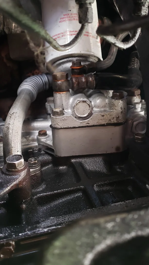

The oil looks like it's coming off this housing below the filter. I thought it might be my aftermarket oil-pressure sensor but that's dry.

The oil looks like it's coming off this housing below the filter. I thought it might be my aftermarket oil-pressure sensor but that's dry. View attachment 2823699View attachment 2823700

That looks like the gasket they used is cracked and weeping oil. Possible also that the surface isn’t flat and not sealing well, or bolt is loose.
Easy to check bolt tightness but get the right torque spec before slamming it down.

They crushed a copper washer (sounds like somebody didn't get the torque right heh)

There was no smoking gun, sounds like it wasn't a heat-event or anything sudden like that. The head and tops of the cylinder walls were apparently pretty worn and lipped. The rings and cam bearings were also evidently in pretty bad shape. Sounds like it was a well used motor.
