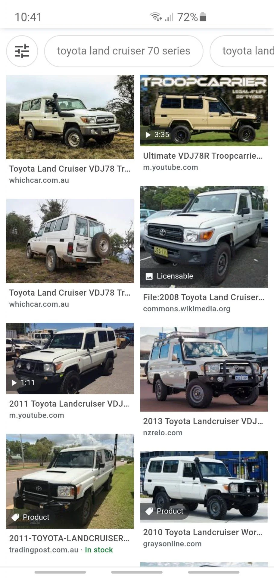

Take a look ....
Take a look ....
They are not LJ78, they are VDJ78/79.The v8 will not fit in any narrow bodied 70m series.

No need, it all been discussed before. Its the chassis that needs the extra width to fit the V8 . You can get them in on a narrow chassis but the engine sticks out of the bonnet. Toyota wouldn't have widened the chassis 4 inches in the engine bay if they didn't need to.
